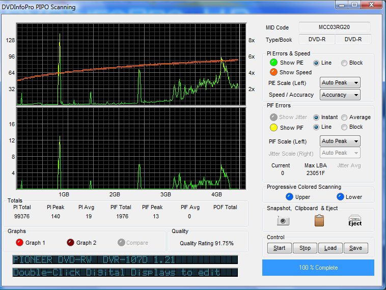

moosh01 said:
DaMummy said:
burning at slow speeds damages your wii laser over time, read it and weep!
http://gbatemp.net/index.php?showtopic=83360&st=0
also....it would be a good idea to upgrade your dvd drivers firmware(google it)
1. that thread said nothing about slow burns specifically, it said different people have different results
B. he hasn't proved this theory of 'killing your lens', he has merely shown you have to verify your disk to see what works best for you
Lastly. YOU CAN"T STRAIN A LASER
My threads proves that lower speed aren't better than faster. In my case, faster burning speed gave a better result. The only way to make a perfect burn is to calibrate your drive by burning the same game with the same disc at different speed. Then you'll be able to find the good burning speed.
