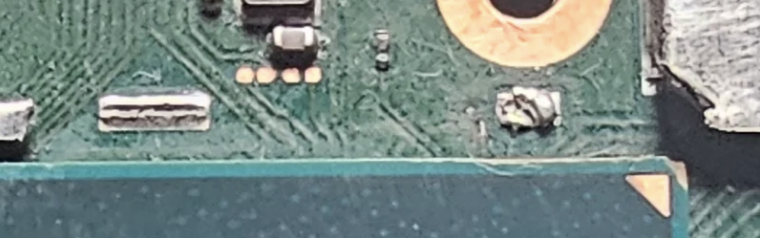

Hello,
Here are some pictures.
As you can see I dismounted bot SP1 and SP2 capacitors.
Stop! Please measure the ohm values against ground. Just the two capacitors SP1 & SP2.
1.5 Ohms on each one to the ground. The capacitors were dismounted while measuring.
