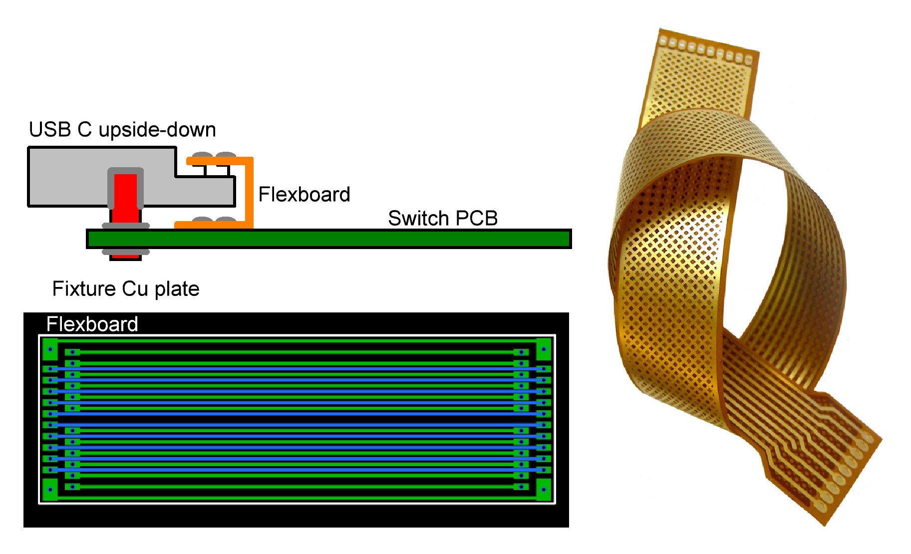

A weak point of the USB C port is that it is soldered directly to the motherboard. The exchange is only possible with hot air and the risk that the motherboard takes additional damage. Over the lifetime of your switch you may want to replace the port several times if it gets defective again. Each time you risk your mainboard again.

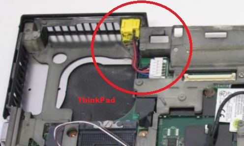

In other mobile devices these critical components are located on a separate board which is connected to the mainboard with a ribbon cable. In Lenovo ThinkPads, for example, the power socket is very easy to replace in this way.

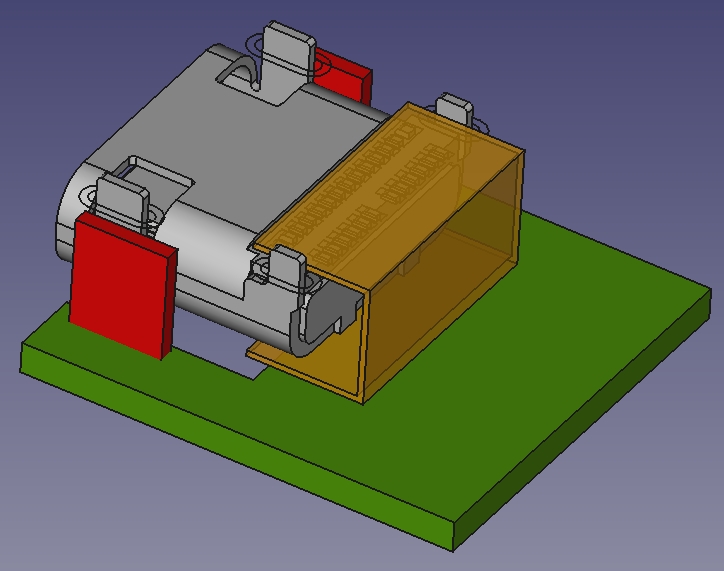

My question now is whether there is enough space above the USB socket to mount it upside down with a flexboard. I have prepared some very basic concept drawings. The flexboard would have through-holes to solder it to the PCB and then onto the usb port.
If my idea would work, replacing a defective port would work like this:
1) The connector can be carefully crushed out with pliers until the pins are free.
2) Use a solderiron to remove the pins from the switch PCB
3) Solder on the flexboard onto the Switch PCB
4) Solder in two small copper plates
5) Align the USB port upside-down between the copper plates, so that it later fits into the dock
6) secure it by soldering it onto the copper plates
7) Bend the flexboard onto the pins of the usb port and solder it in place

1) Don't crush off ports with pliers the pads are not extra strong or anything and will break.
2) This will make the port less durable.
3) You're better off doing a proper replacement rather than adding a flex.
By all means do this but you'll end up either damaging the board or destroying it; no point.
Ripping off the SMD pads would damage the board. The idea is to destroy the port without any stress to the smd pins to be able to unsolder the rest with a standard soldering iron.
If I watch the videos on youtube, people do have a lot of problems getting the inner pins resoldered. They heat up the mainboard again and again. At the end the new port is mounted but the parts around got melted - even if they used capton tape. Yes - it is for sure better to replace the port with hot air or a reflow station. But also if you buy this tools you need some time an experience to handle them correct.
Multilayer boards don't like it if they are heated up too often or too hot. I see here the main cause for mainboard damages.
The original connector seems to have 4 ground connectors in its edges and the two screw holes. After I saw this I don't think it is less durable, this mechanical connection points can be reused.
But at the end of the day I found the real point why it is game over here. The port sits in the middle of the PCB. By mounting it upside-down it would sit on abve the PCB and therefore would not align with the housing and the dock.
