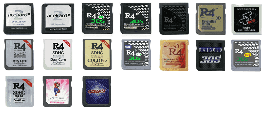

It is simple if your card isn't on the list then you don't have a compatible card for the exploit.

Anyway if your cart isn't in the picture of carts have shown then you can't use it for NTRBoothax.

each of these cards (mostly) are by diffrent teams and each have diffrent Firms, Programming commands/NAND Flash. your card just likely has either too hard a NAND flash to Reverse engineer to make it compatible, or wasn't designed for Updates/doesnt have room for the NTRBoot payload or its locked down.
so Sorry your card isnt on the list , it isnt compatitble, what i mentioned earlier on page 2 are your only options. stop being a cheap ** and pony up 2$ for a DSiWare game for Seedminer, or wait for Smealum's Exploit chain to be made into something usable for your older FW System

Your cart isn't on the compatibility list. BUT, there's a chance the R4i-SDHC 3DS RTS firmware can be used with it.
If not, I suggest you use that €20 prepaid visa to buy a compatible DSiWare game for seedminer. That will definitely work. Or better yet, help your friend hack his in exchange for an eShop card so you can hack yours.
That's not completely true actually. Several R4i-SDHC carts are just the same cart and end up being compatible because of this fact. I just recently found that this cart is compatible with NTRBoot and it's not in the picture. This isn't always the case, but it's just worth noting.
