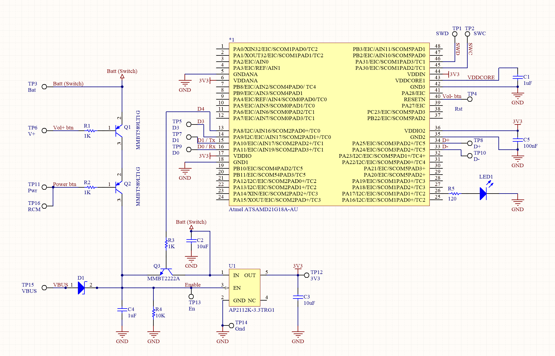

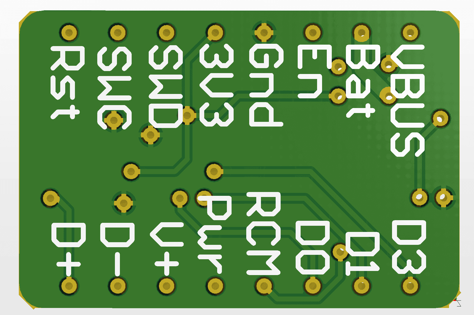

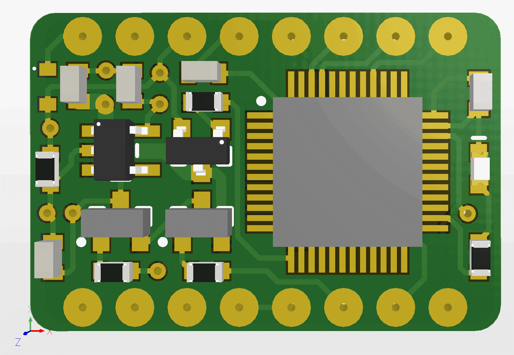

Here is my version of a trinket based modchip, with lot of support from @mrdude . Thanks for that!
The key point, that this board addresses, is the power draw while it is not used.
An improvement in this point is achieved by controlling the enable pin of the voltage regulator. Normally, the enable pin is low, the voltage regulator is off, and no power is used. The voltage regulator gets enabled, once BOTH buttons "Power" and "Vol+" of the switch are pressed. One single button is not enough, to enable the chip, so under normal use conditions, the chip normally never gets powered, no matter if the switch is on, off or in sleep mode. Once the chip is enabled, you don't need to press the buttons all the time, since the chip can keep itself alive by setting a specific pin high. After the payload is sent, this pin can be set to low and the chip powers itself off completly!
This is the second version of this board, which is not yet manufactured. The first version of the board did not consider, that during flash mode (by double pressing reset -> "Vol-" Button of the switch is intended for this use), the user code doesn't get executed, so I could not set the needed pin high, to keep the board alive... This is fixed in the new version by an additional VBUS signal. If there is voltage detected at the USB port, the enable pin is always set, and the voltage regulator is always on.
Reactions: mrdude
@frep, this is the best chip available - nothing beats it, so you've done a great job.
I'll be testing your board (the one you sent), tonight - I've just finished work and am about to have something to eat, but I'll test after that and then let you know the results ok.
