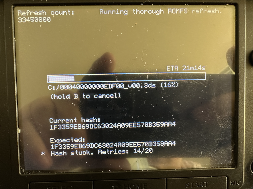

Just wanted to report, I was in the process of ripping my games and I realized my copy of SSB would not launch. At first I thought it was some corrupted update data, but I noticed the cart wouldn't run in a fresh 3ds either, so I just assumed it was dead. I found this thread on whim, and decided to give refreshing a shot. It was news to me that 3DS carts aren't actually ROMs, so it makes sense that it might be corrupted if I hadn't touched the game in a long time (which it's been years at this point).
I gave it a shot, and it fixed quite a few incorrect hashes with the first run alone. I tried verification, but that still failed. I tried running the cart as is, and it did actually get past the 3DS logo and loaded the game, so that's pretty good.
I'm currently aiming to see if I can get verification to pass, but I've run it a few times, and the number of refreshes continues to fluctuate up and down each time I run it, and verification continues to fail. I tried the 100 refresh version, and that seems to result in a few clusters that had the "Hash Stuck" message, so my next idea is to try Select + 100 refresh to see if that makes a difference, but I'm not sure if there's any danger of "over-refreshing a cart".
EDIT: Also, just to clarify, the game did launch, and I was able to get a few rounds in, but it seems to randomly crash prior to starting matches sometimes. I wonder if there's a specific character it's trying to load, but failing. I haven't sussed out what it might be yet. So despite the several clusters that are still failing the hash check, it's in a much more usable state.
EDIT 2: I've also noticed sometimes it gets a hash stuck on hashes that look like they match:

Hmm... When the hash gets stuck and fixed, it tries to verify it a few times to make sure it's actually gotten fixed.
'ts probably what's going on there.
Does it move on eventually?
It does move on after the 20 retry limit I think. What's weird is that I tried to run it again to see if it got fixed, and for some reason, it seems like it got stuck on that one again? But the expected hash seems to have changed. I'll see if I can get the log from this next run.
