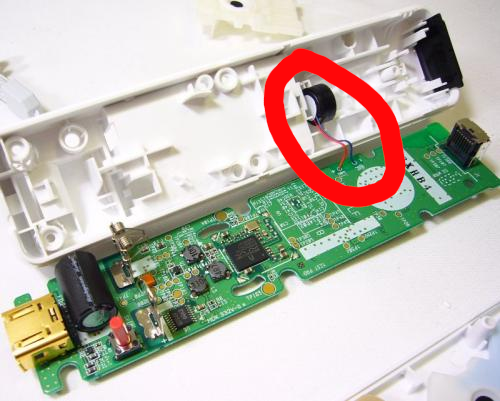

I repaired mine some time ago, let me see if I have some pictures left. ^^ Nope but google helped. I'm talking about this thing here:

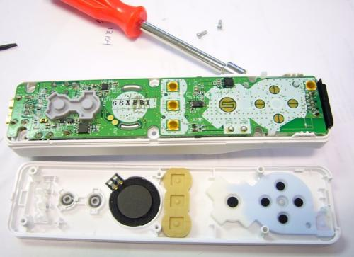

Note that I'm not 100% sure it's a battery but it's at least not the speaker, that's on the other side of the PCB:
Wait, google sais it's a rumble motor, sorry for the trouble.
@V10lator Thanks anyway - it's a good thought, but i doubt it's something with the remotes. I have at least 6 working and a couple that i think went bad, but the issue affects all of them.
