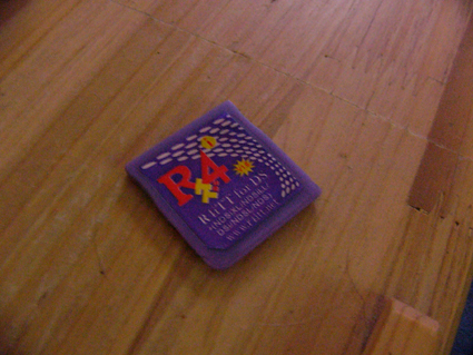

Hello.:)
I have the same card as you:
It have the the YS Menu from
https://gbatemp.net/threads/retrogamefan-updates-releases.267243/
on it.And it don´t work on any of my DSis/XLs (all have FW 1.4.5E).Only the two who had CFW and TWiLightMenu on it.
It´s odd that it works on lower FW.But as i said DON´T update the DSi XL because then you have 1.4.5 on it and the flashcart works definetly not with it.
You can try an Firmware update for your flashcart (i don´t know if this is a good idea,maybe the cart won´t work no longer an both DSis XL).
http://old.r4wood.com/pages/R4iTT-Kernel.html
(please compare your card to confirm its 100% the same)

Hello.:)
