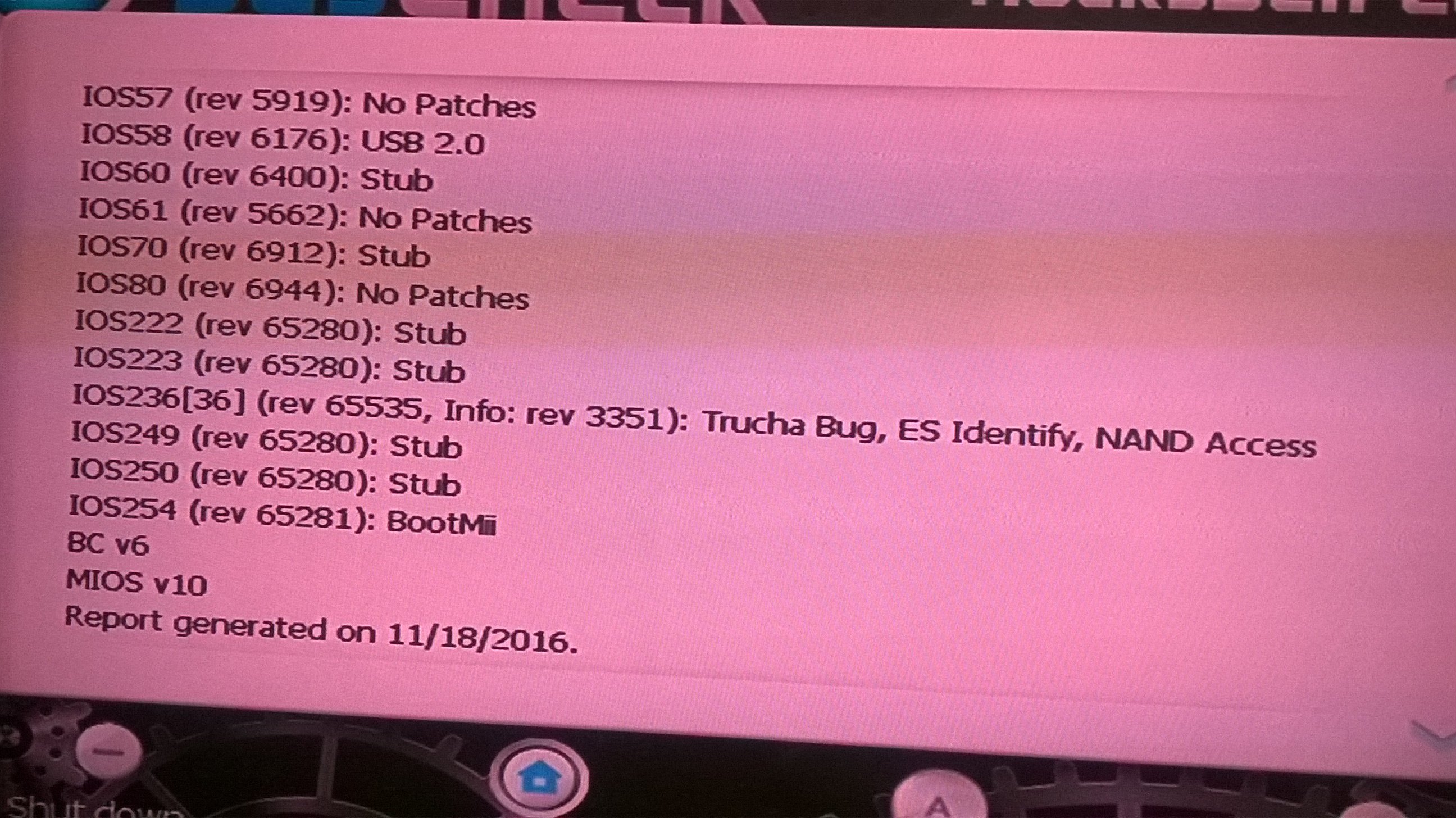

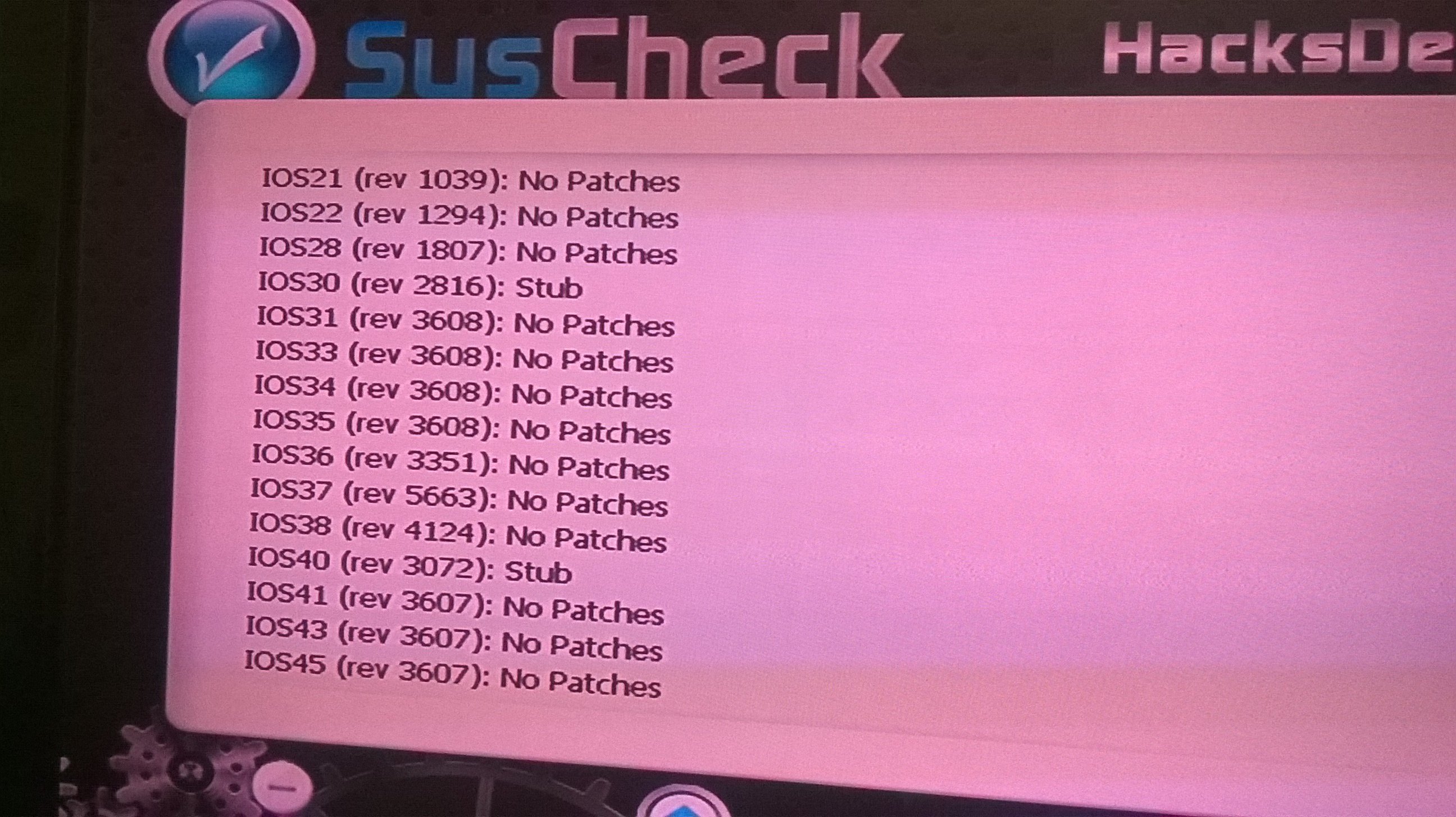

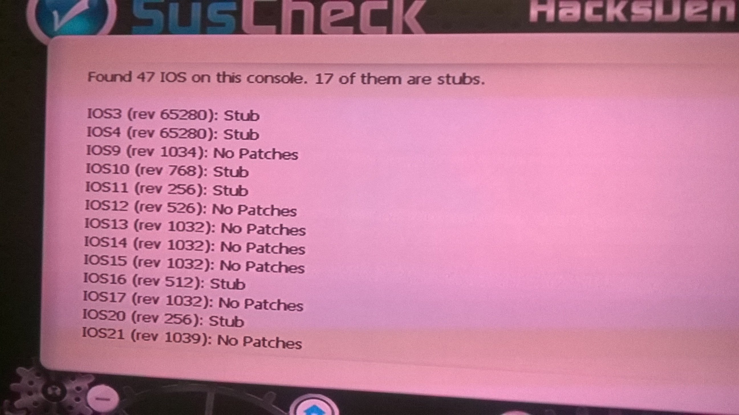

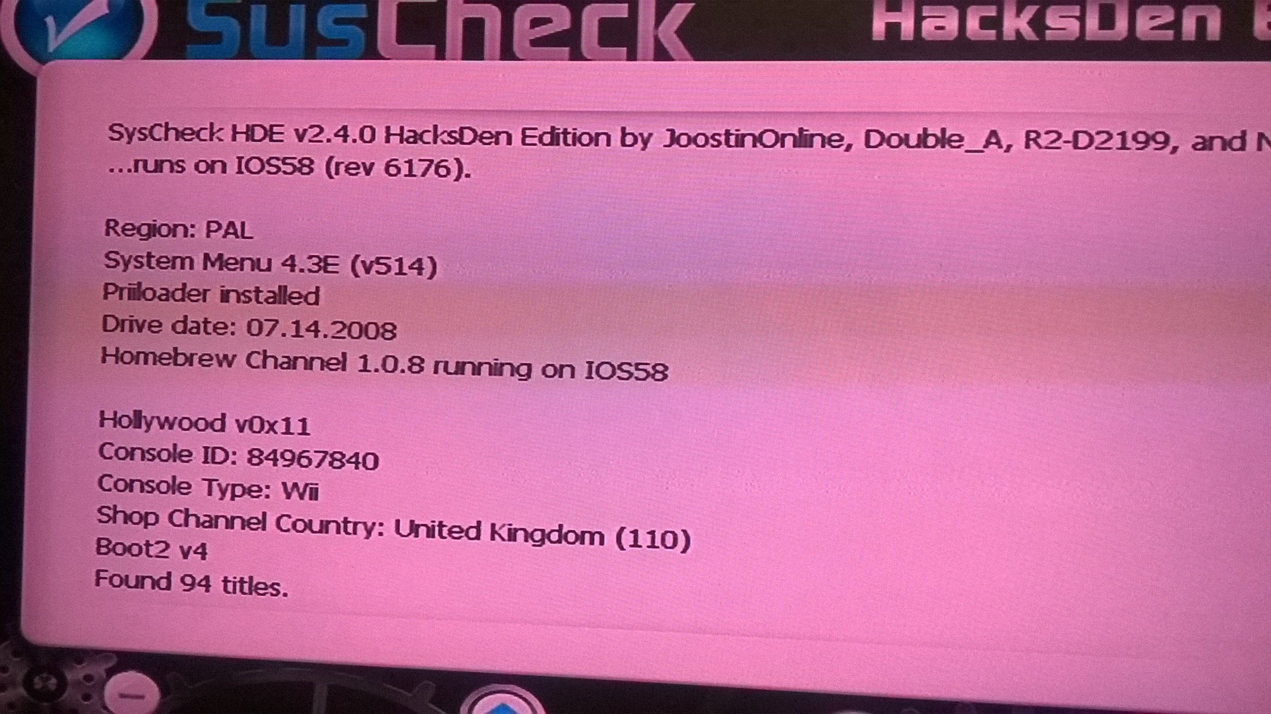

Here is the report. I took pictures.
Ok. Seems that your HBC is and old versions, and you miss some IOS or are outdated, you also miss the cIOS if you want to load wii and Gamecube backup games from USB. We can fix all of this thing, plus the priloader update and the bootmii nand backup.
