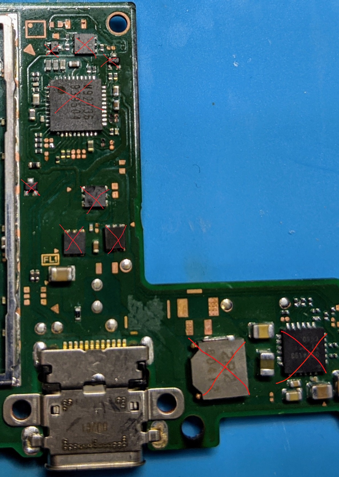

I also found some shorted caps that all seem to be on the same circuit. Sometimes when I check them they have 1 ohm resistance to ground sometimes 20 ohms but they are never open like the good working switches I have. Before I start pulling caps off anybody have any good ideas what these could be. These are the ones I've found but there could be more that I haven't found yet
