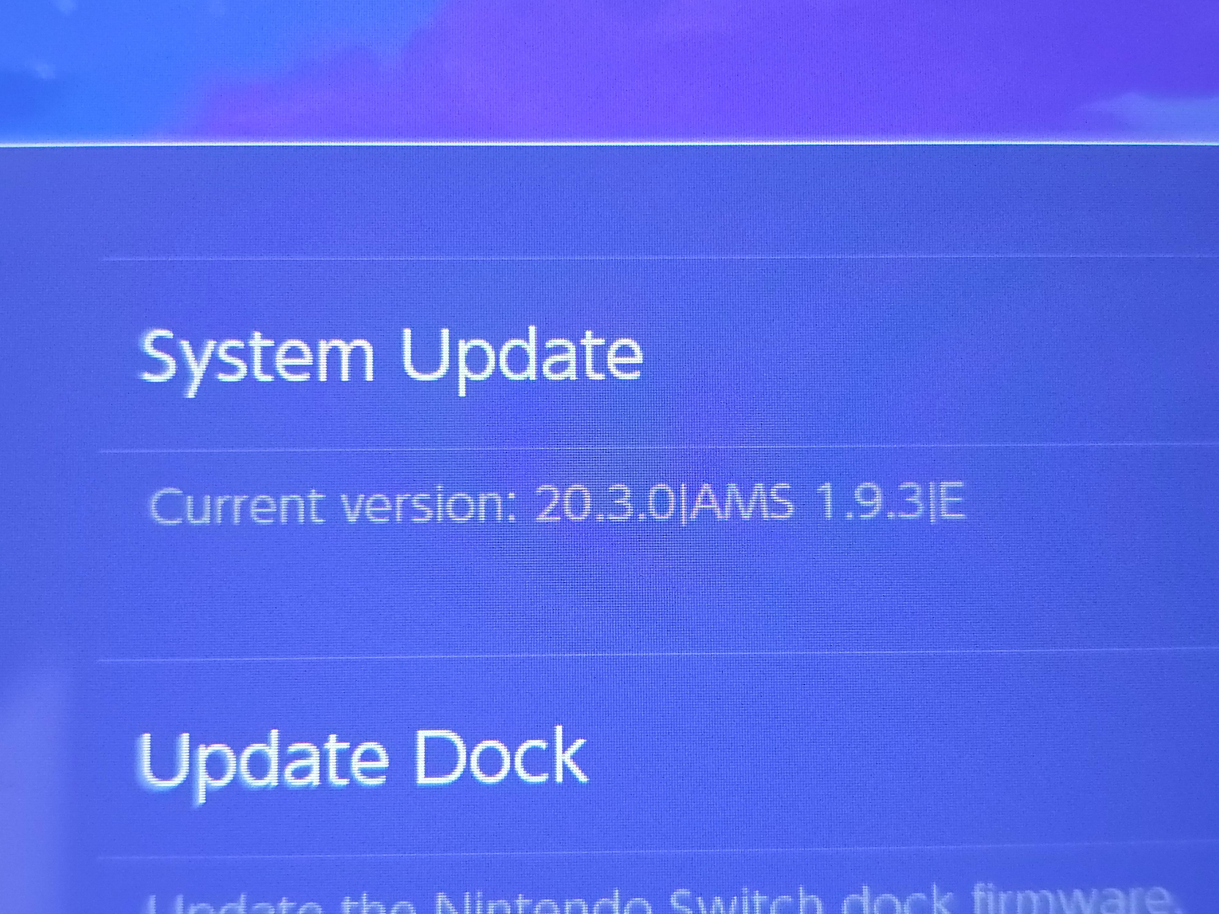

Was your firmware up to date?
About 8 months ago, more people started complaining about a battery drain in sleep mode.
It seems Nintendo broke something back then.
Although Nintendo remains silent, there is a change that they fixed the issue with the latest firmware update.
  • Wow
Reactions: cearp

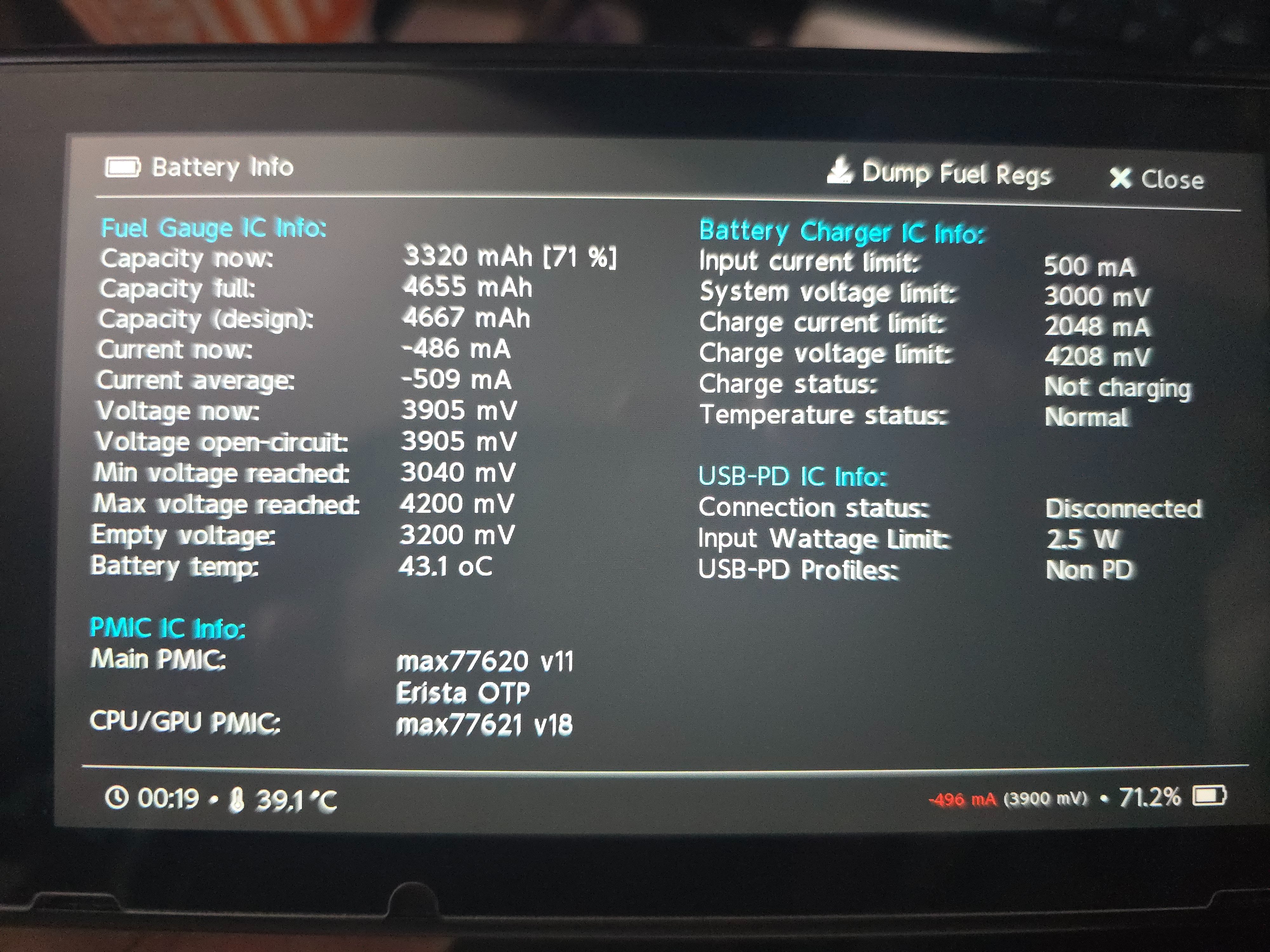

Provide a hekate battery report.
It was updated to the latest firmware before I modded it so it's currently on 20.3.0
Battery looks normal, it is normal for it to drain a little in sleep mode
Yea this is the brand new battery which i installed in there. The switch although doesn't last a night. My other switch barely loses 20% when it's sleep for multiple days.

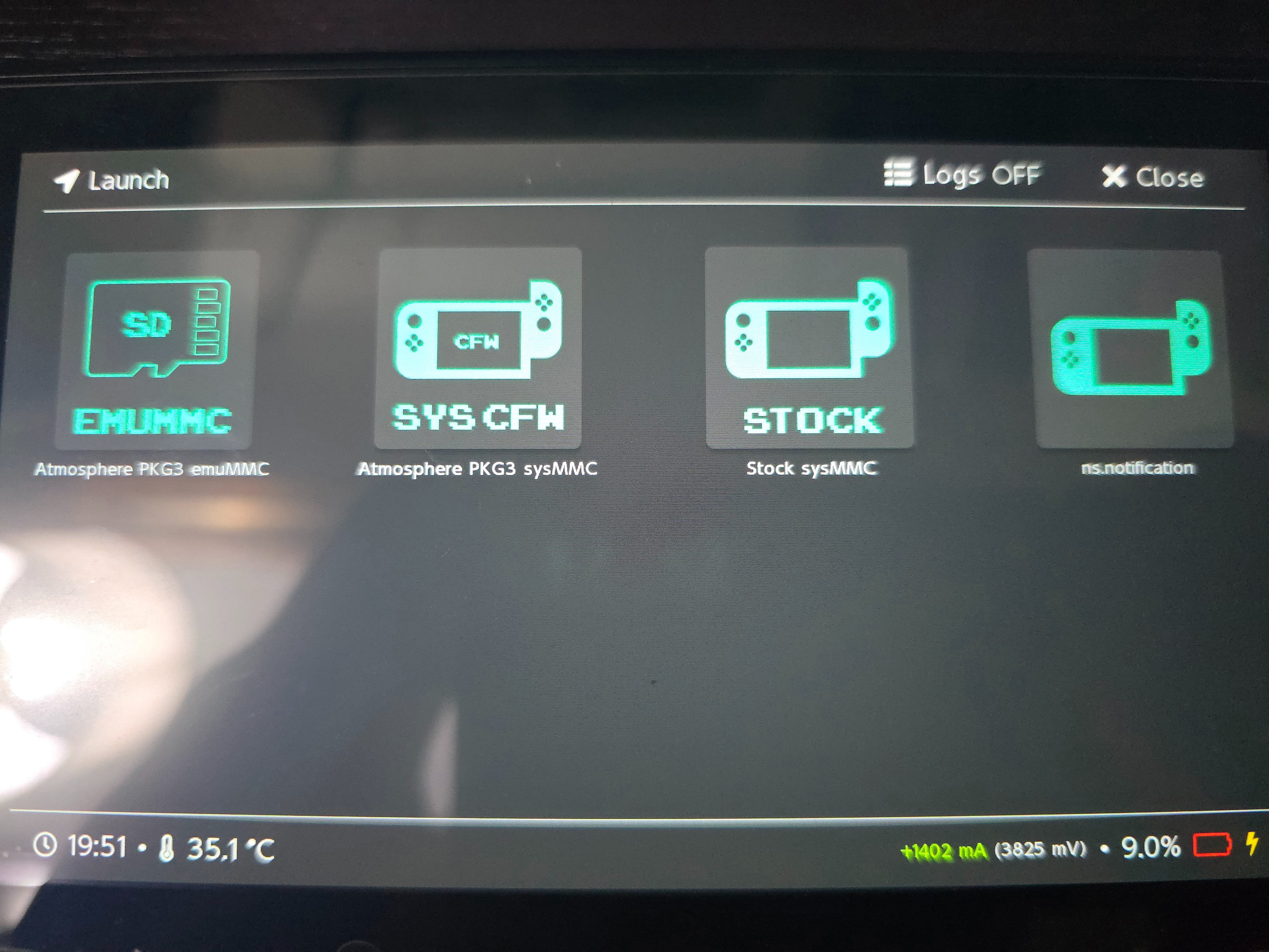

Also noticed my switch has this on its launch screen in Hekate and I haven't noticed anyone else with it . The NS.Notification option
Reactions: XenoFredo
There are two working solutions to the battery drain issue:
- The first one I have tried and still works today after many firmware updates is to recreate your EmuNAND. A bit time-consuming but it solves it once and for all.
- The second one is to add these lines in the system_setting.ini file of atmosphere: https://github.com/Atmosphere-NX/Atmosphere/issues/2528#issuecomment-3054401265. This one is quick.
You can follow the usual process to recreate your emuMMC, just make sure you've accepted any pop up from Nintendo on the stock side before you start, maybe open all the online functions: NSO, News, Friends, etc. before you start to be sure, then the battery drain issue should be gone.
thank you the system ini lines worked i have now solved my battery drain that i did not until recently know i had my internet now shuts off when in sleep mode which is awesome thanks again
