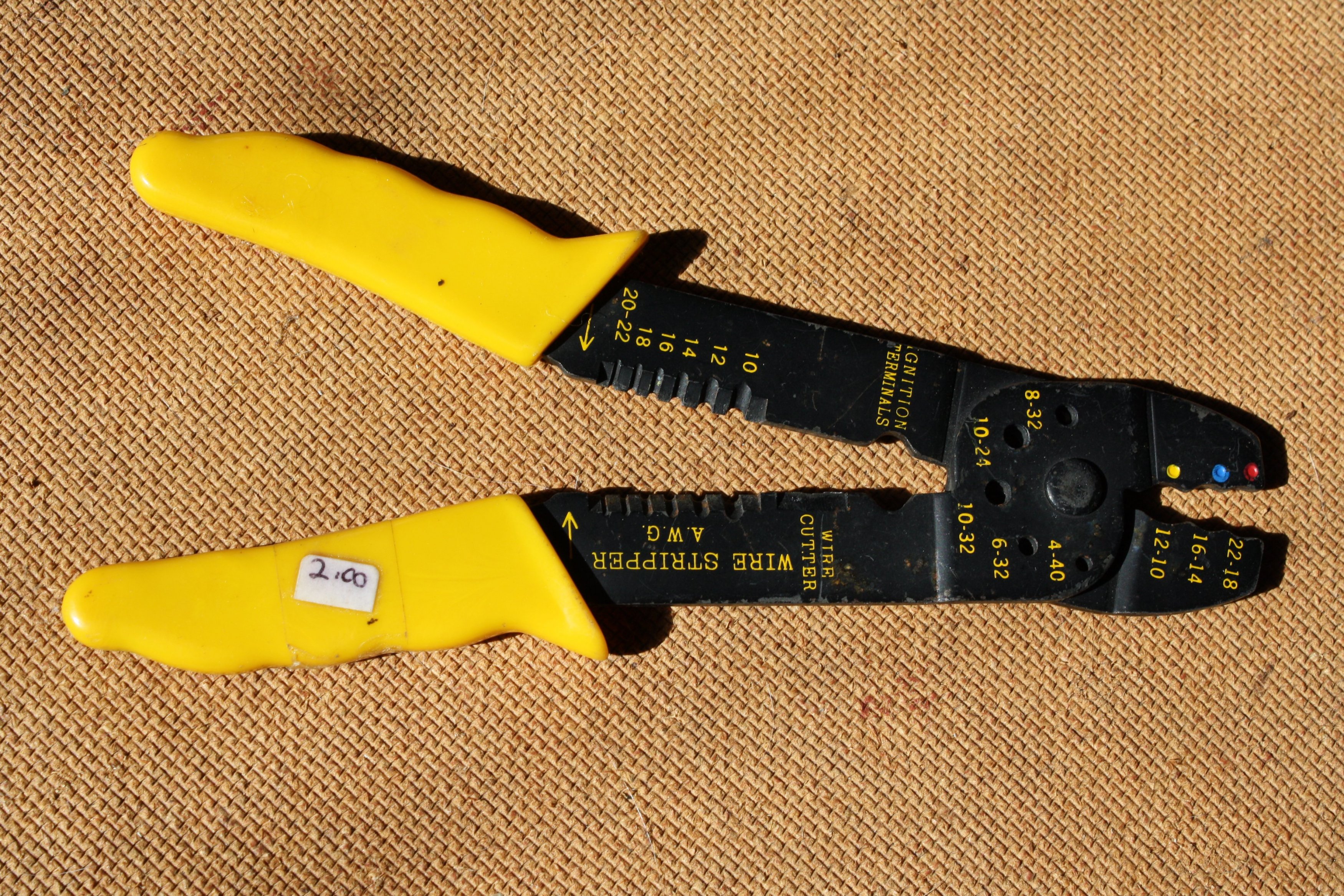

*the otherwise useless (seriously other than what I am about to cover they are useless) set of wire strippers that everybody seemingly has
The holes at the top there are for chopping down screws. That one courtesy of the numbers looks to be imperial threads (probably the more common in the US, see different ones around here but enough of my pondering tools) but if you have a metric one and it is the right size then if it also has threads that is for cleaning the thread up afterwards.
Pro tip there is do it in a bag so you can get the bits back and not have to go chasing a now even tinier screw across the room or sliding over the cut off bit later.
Though a decent hack saw will probably also do, as might a bench grinder or file if you have the means to hold it.
