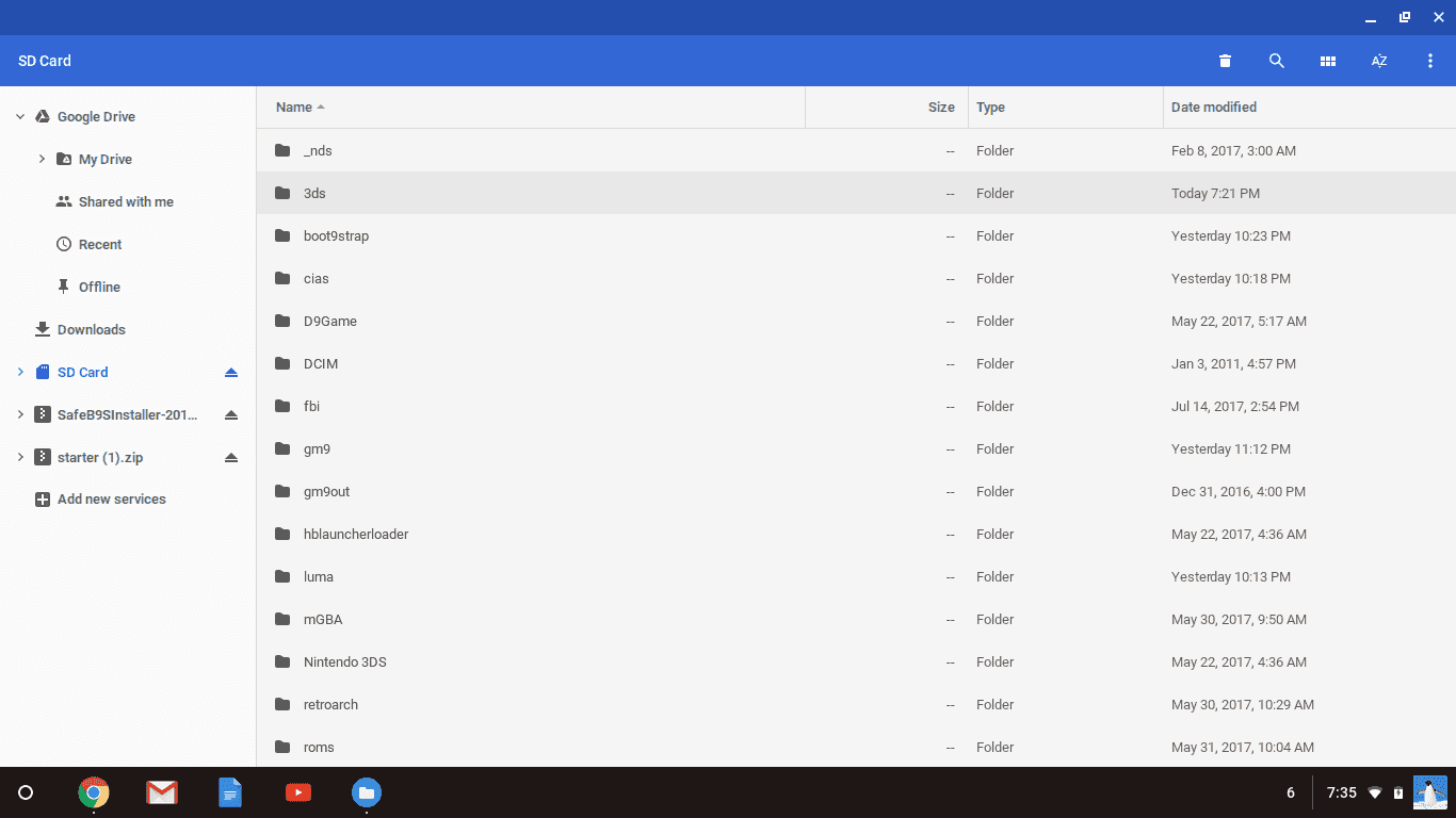

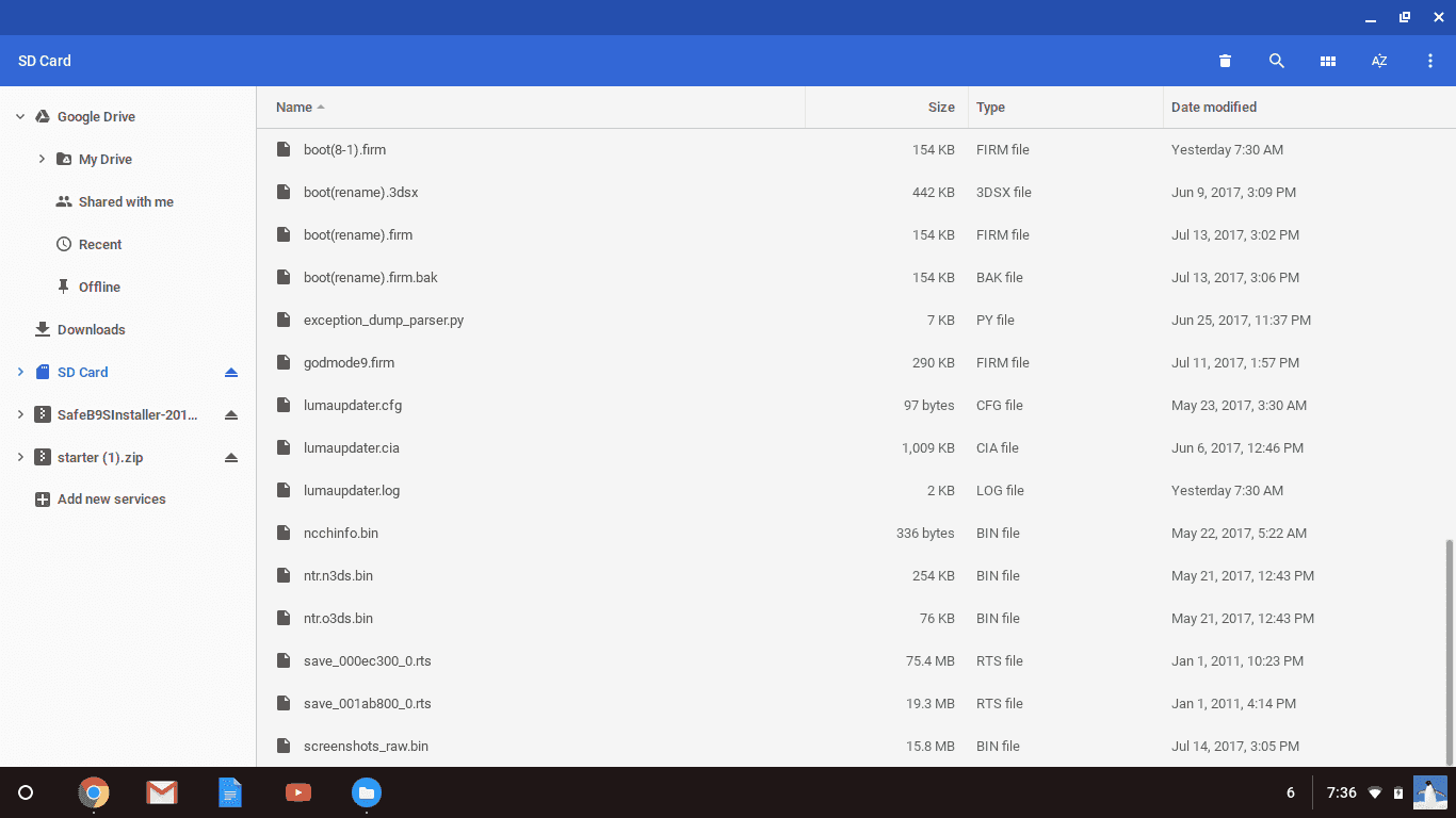

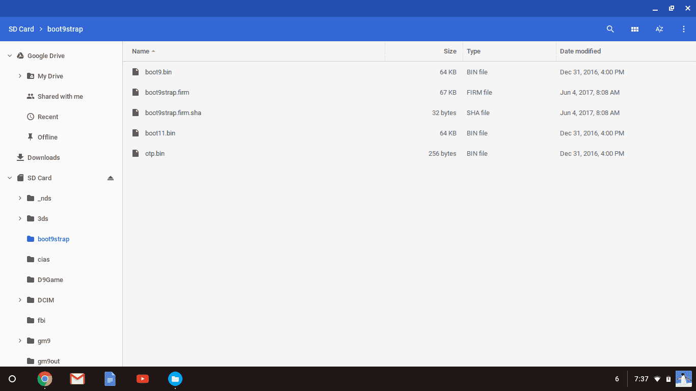

    OK got an idea, can you post a screenshot of the root of the SD card, payloads folder and Boot9Strap folder.

  18. SirECK
    SirECK GBAtemp Fan
    Jul 1, 2009
    Ontario, Canada
    I'm starting to think you are on b9s 1.0 can we get screen shots please?
