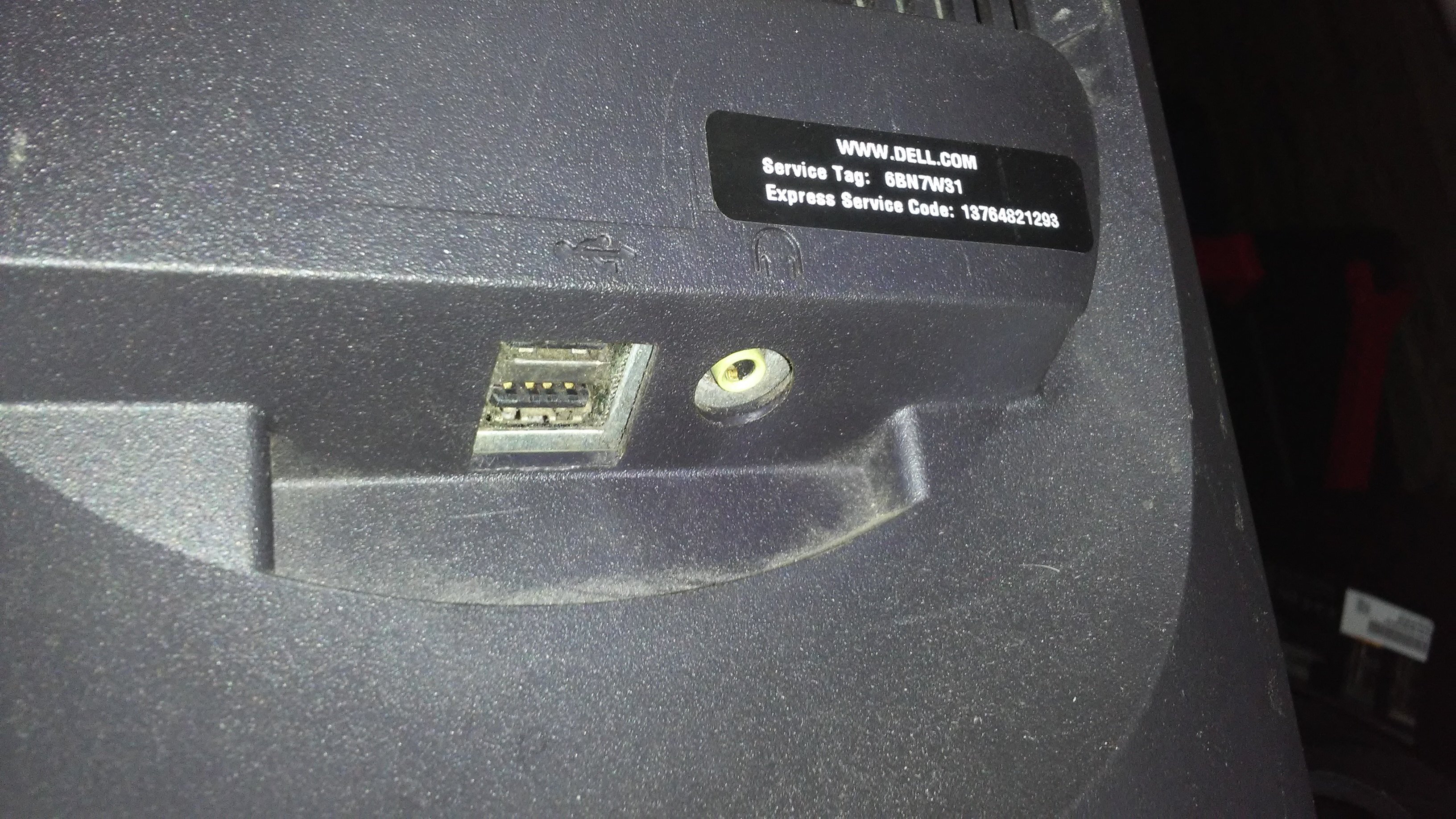

Yo, @TotalInsanity4
Here's some photos.
20180730_215913.jpg 20180730_220017.jpg 20180730_220102.jpg 20180730_220325.jpg 20180730_220353.jpg 20180730_220408.jpg 20180730_220420.jpg 20180730_220437.jpg 20180730_220454.jpg 20180730_220557.jpg
Aha... Hm... That's a little more complicated that I was expecting it to be. The good news is the motherboard standoffs all look to be in the right places, and it looks like the power supply and backplate are both replaceable. The bad news though is that it looks like the front panel connectors are on a proprietary cable with a proprietary connectors, which means you'd either have to split the end up and find a way to attach them to the motherboard pins, completely rewire them, or splice them onto modern ends. All of that is doable, but it depends on how determined you'd be to modernizing the interior components while keeping that case, and how willing you'd be to deal with unforseen challenges in the building process
