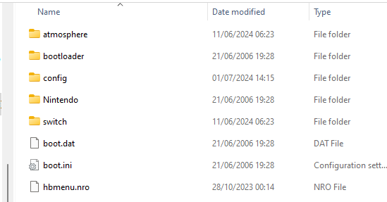

ok, can anyone help.
I've downloaded sxgear as above and ive copied the boot.dat and boot.ini files to the root of the SD card.
I've gone to then boot by using my jig and sxos adapter (holding volume up and power button) I can see it trying to boot (the green light on the sxpro adapter goes green but just a black screen.
If I inject fusee.bin via tegrarcm it boots in to Atmosphere. So must be the way im set up.

all you need is use the newest fusee.bin or hekate and convert it to boot.dat

you have to look at what boot.ini points to, and name hekate or fusee with that name, and put it in that location.
