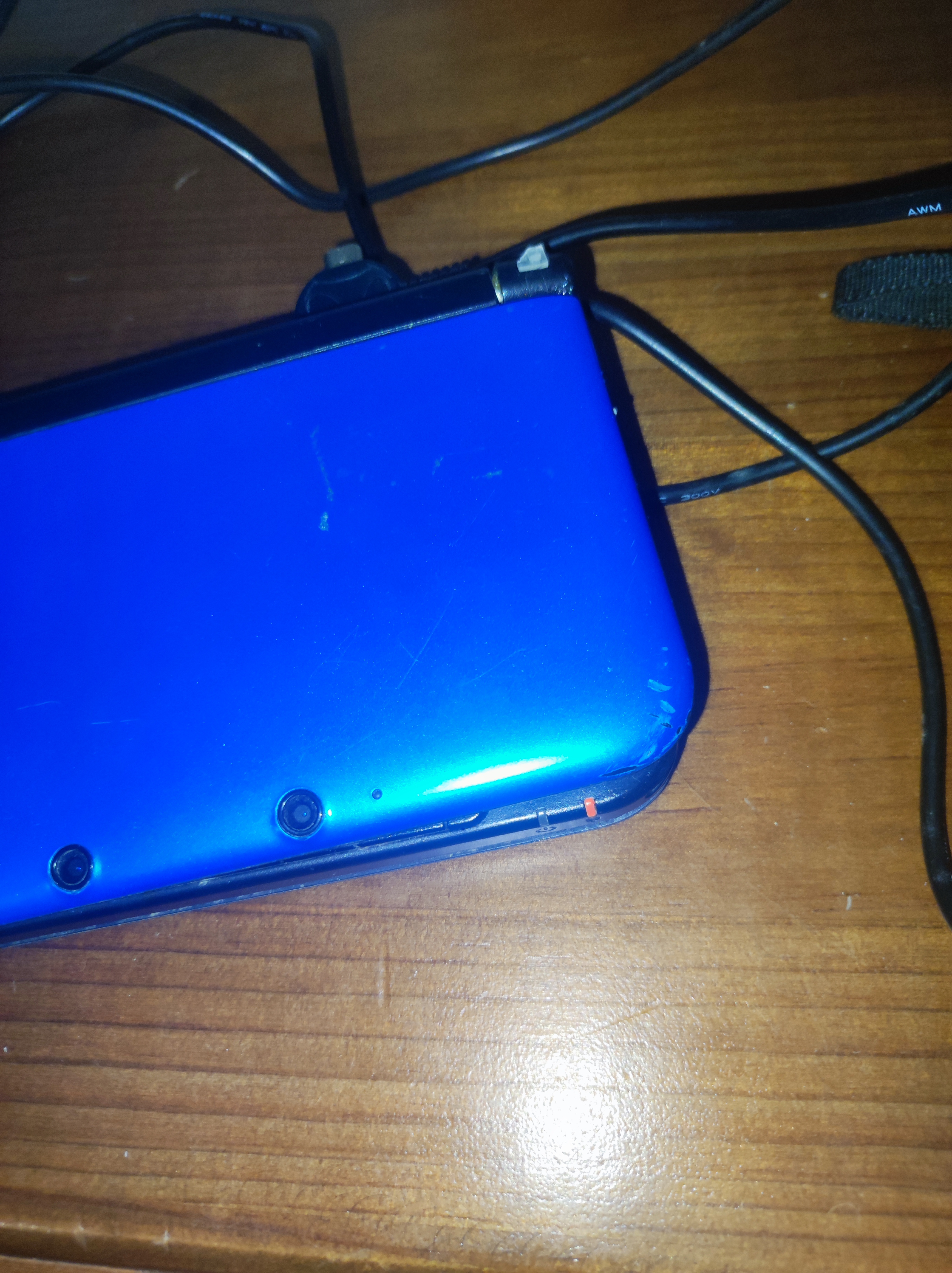

Hello everyone, I have both a Nintendo 3DS and a 3DSXL and they have been broken for a while, like 2017. I have them since I was a very young and I want to play with them again, I really miss them. I just want some advice and if I could save them without losing all my data.

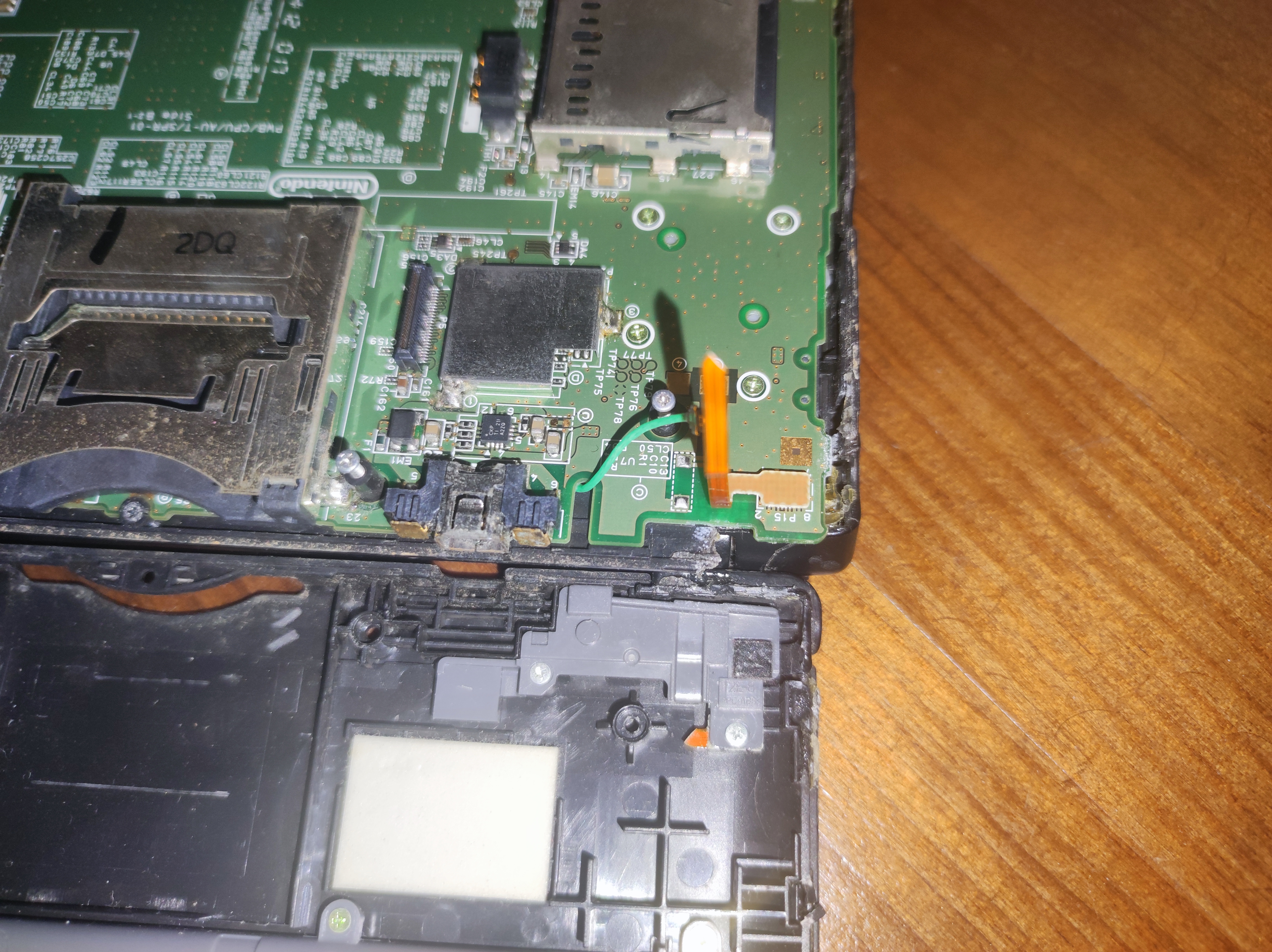

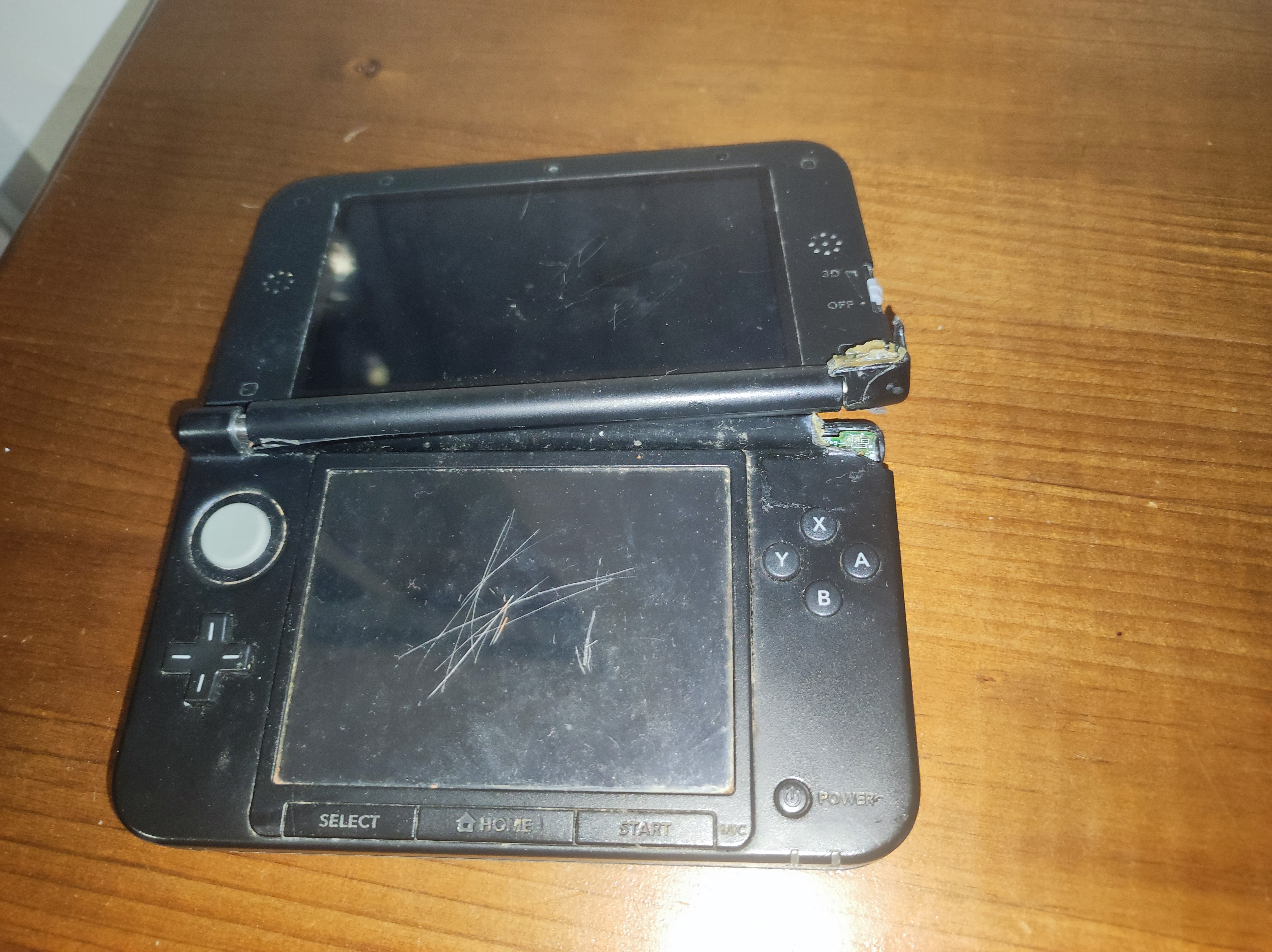

Here is some additional information: The Nintedo 3DS XL charges for a few seconds and then it stops charging, it won't charge unless I plug it again, it doesn't power up. The glue has been there for atleast 2017 so I'm guessing I must replace some parts with another 3DS XL, I'm guessing that the orange wire is for the R button so I also have to replace it.

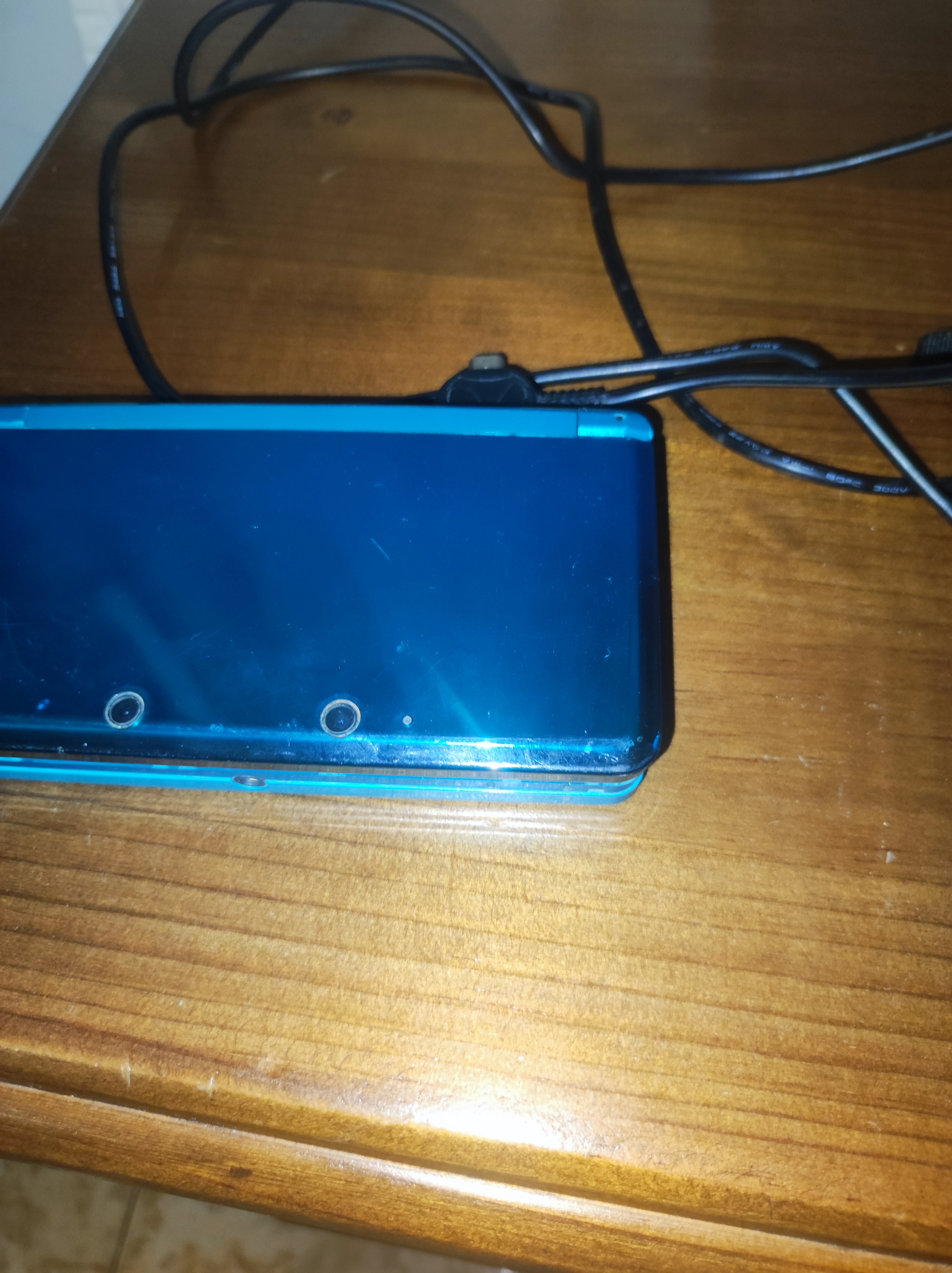

The 3DS just straight doesn't charge and I'm planning on buying a new battery but I don't know if will find any replacements.
Thanks for reading and I really wish you could help me this problem.

The XL should be doable but not easy nor cheap, most likely it doesn't power on because the flex cable for the upper screen might be torn off. Ds and 3Ds won't turn on if the upper screen is not present or if the flex cables are damaged. Shoulder button cable also needs replacement. The unit might not charge because it's maybe charged already.
For the battery of the second unit you have to buy a CTR-003

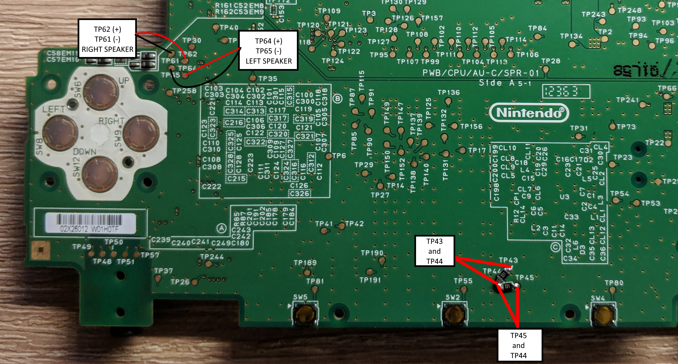

Before buying a new screen for the 3ds xl you can solder 2 resistors on specific test points on the motherboard to trick the xl into thinking there is a upper screen attached. That way you can see if the 3ds boots or not. However as it's soldering, only do it if you feel capable or have done soldering before
Anyway I'll leave a picture with the test points that need to be soldered in case you want to try. After confirming the 3ds boots you can then desolder them and just replace the upper screen (ignore the speakers in the photo, that's for making it a 3ds macro)

As others have said you will probably need a new upper screen, also a replacement shell to fix the damage. Replacement shells are not great quality, but it will work. The metal hinge piece looks intact so you will have to remove that and fit it into the new shell and also thread the upper screen ribbon through the hinge of the new shell, it is tricky so go slow to not damage the new ribbon. L/R button replacement ribbons are easily available. Getting the needed parts should not be a problem.
