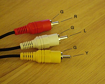

The reason why your signal is dodgy is because the RCA cable isn't properly shielded, and since the interference is consistent with the beats in music I'm going to assume that one of the audio lines is crossing over to your video signal, which does point to a pinout issue.
A pinout is the allocation of functions to "pins", or specific points on the plug. In a typical RCA cable the center pins are the signals while the shrouds are connected to the shield, which is connected to ground. Since the output is modified, you'd have to provide some pictures to explain the issue better. Does your Famicom have a standard setup of a red (Audio), white (Audio) and yellow plug (Video)? You need to ensure that each part of the cable goes to the right point, and with a custom setup you may need a custom cable. We need some specifics about the mod.

It's worth mentioning that not all RCA is equal, we need to establish if this system has a composite (all video on one plug) output or component (Y/Pb/Pr, or Luma, Blue difference, Red difference) output. It may simply be hooked up wrong.

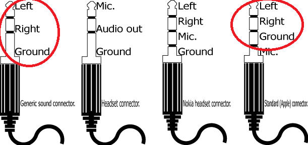

Oofff, I was worried this might be the case. This is a combo, 3.5mm. It's repurposed from an audio plug. The outer sleeve is *usually* the shield, followed by a number of rings, and the pinouts of those are quite varied, especially on a custom system where they may as well be random.

RCA to 3.5mm jack have different standards depending on the implementation and the modder may or may not follow any of them. If I made the cable, I would've put the video on the tip, the audio channels on each of the two rings and the ground on the sleeve, but that's not a rule. If the system had individual RCA receptacles for each signal it wouldn't be a problem, but combo jacks like this are a different story - the cables either work or need to be reworked, it's always a gamble.
It's possible that the reason why your signal suffers is because the original plug had less rings than the current one and the audio signal is crossing over onto the sleeve when in the receptacle. 3.5mm jacks are either stereo or stereo with inline (usually a mic), so either 3 poles or 4 poles. Without seeing the pins of the receptacle you have to guess. If the system is still mono, it could be using a 3 pole jack, which would cause this behaviour (video, audio, ground). Try disconnecting just one of the audio channels and see if the issue persists.
If you look at the jacks, the first ring on a four-pole jack intersects with the sleeve of a 3-pole one - that would cause the audio signal to cross over to the shield, which in turn would pollute the video signal.

I have seen that my cable has 4 pins, so the problem may be that it has to have 3.
If that was the case, where can I find a 3 pin jack to RCA cable?
