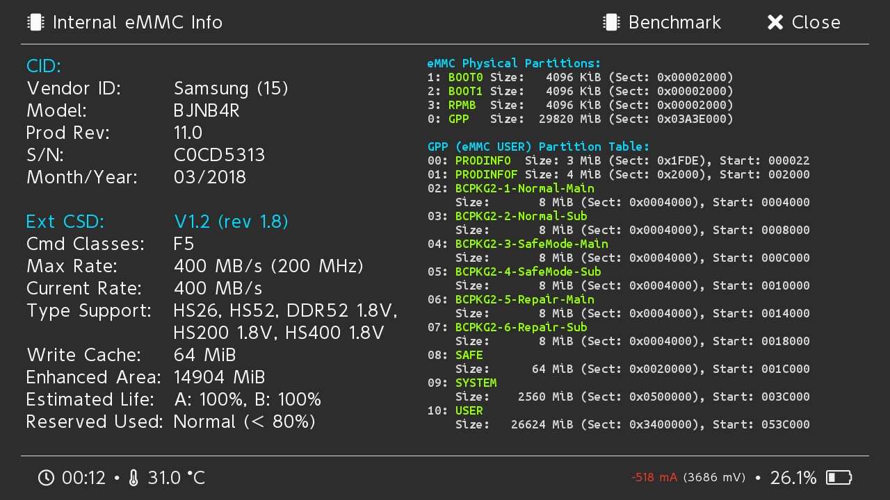

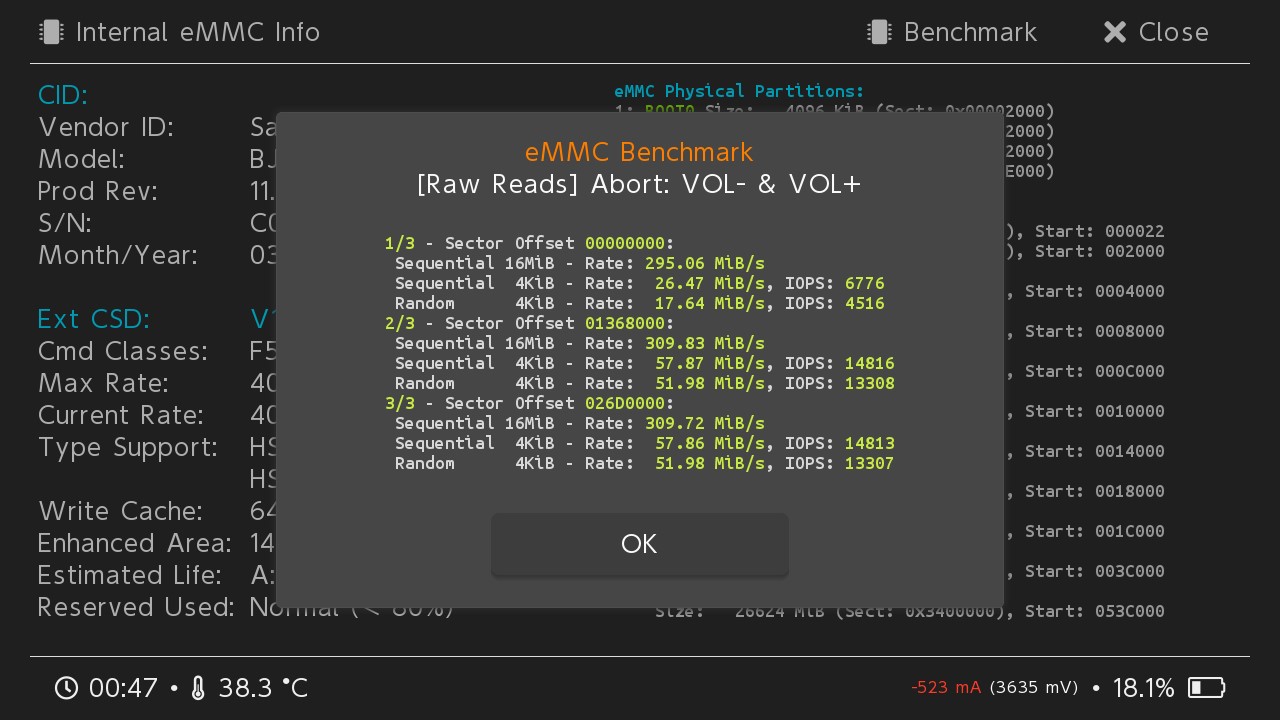

Also, not sure if helpful, but here are screenshots I took in Hekate regarding the EmuNAND.
