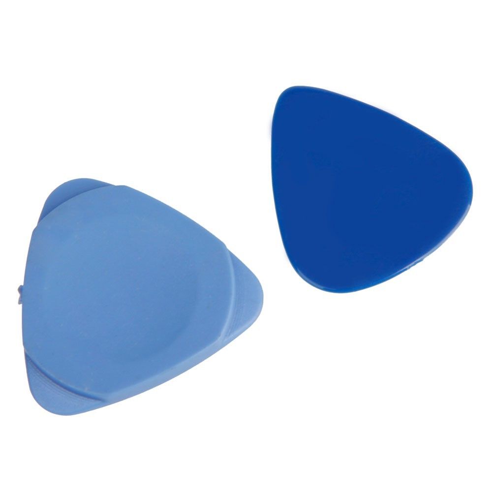

And as for pryer tools. Never ever use metal pryer tools! They can easily make scratches.
Use the plastic tools like this:
https://www.dhresource.com/0x0s/f2-.../thicker-blue-plastic-trilateral-pick-pry.jpg
