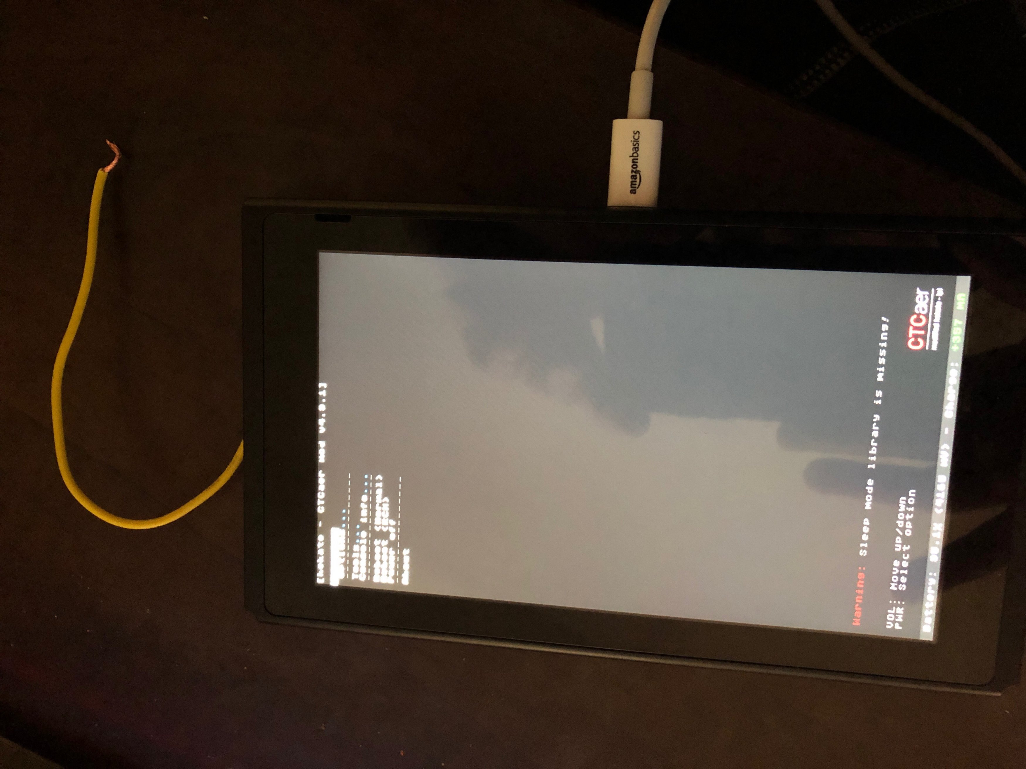

@Madridi Personally I've used a cable to short the pin 10 with the middle right joycon screw in order to boot in RCM. It's very safe as long as you dont touch pin 4.
It may require a few tries to get the contact right. Once you get it, you can push Hekate (if Hekate loads, your console is vulnerable) and backup your NAND.
Finally, you can enable Auto boot and Auto rcm to avoid doing the pin 10 short and keep your console on sleep mode.
If it shutdowns, you only need to push the payload because of Auto RCM (self explanative).

I wouldn't advise the paperclip, it will damage your pins in the long run. Tinfoil or cable is better if you have nothing else.
However, I thought personally that finding a random cable from an old device, cut it, and simply connect it to your right joycon screw to the pin 10 was the easiest method for me.
I'm very bad with hardware so if I managed to pull it, you sure can. :)

Tinfoil as rcm jig is the worst idea ever, as it is light and can easily move out of place. Paper clip, in this case, is the best jig for now (what do you guys think that the cheap jigs use?)

1. Test whether or not you can push a payload (PC, android, iOS).
3. If so, do a backup right now.
2. I would advise using autorcm as it is the best thing for ams right now (because ams will shutdown properly and can reboot to cfw) and you will never ever need a jig again.
4. Use DNS or airplane mode (or just simply dont connect to wifi) to stay safe.

I used to feel the same as you about using foil. I was even super critical of people who did... until I watched a YouTube video and saw how it was done. I was in a tight spot and forgot my jig at home. All I had was foil and I only needed it to work once (autoRCM). Its not like you just cram it in there. Its carefully folded over the bottom of the joycon. You attach the joycon and then your in RCM. It comes off super easy and doesnt break apart inside. Since then I have modded 3 switches the same way. Easy alternative to the jig.

If you have Amazon available, you can get an RCM jig for less than $10 USD. If it boots into RCM with it you are GOLDEN for hacking.
That is where I would start. IDK If this will ship to you, I think it is worldwide, this device (https://www.amazon.com/gp/product/B07J9JJRRG/) is what I use daily and can personally vouche for it.
Once you can confirm RCM works, you will need:
- A CFW of choice (Popular ones are Atmosphere and SXOS. One is open source, the other is a paid "product" respectively.)
- An SD Card (if you plan to play emulators, and have a collection of *owned* ROMs I recommend at least 256GB, if you plan to emulate and use..... downloaded NX games, I would try to get a 500GB SD Card or more (NX games can get big.))
- SDCard MUST be formatted as FAT32. People use exFAT here but exFAT is easily corrutable with homebrew. (To note, 9/10 devs will NOT help you if you use exFAT formatted SDCard and it ends up losing your data. It's just not stable on the switch right now.)
- A way to inject the payload (USB-C cable, android app, or RCM Payload injector device)
- Some time.
Once you figure the above out, I recommend following a tutorial. Running Atmosphere is as simple as putting the files on the SDCard, and putting the switch in RCM then injecting the payload.

Once you boot CFW, if you want to avoid getting banned do not go online while in CFW.
***ALSO NOTE: once you boot cfw there will always be a small chance of ban, even if you boot to OFW (in some cases, not always? I have been online with mine for 8 months now, no issues - but I also have no pirated NSP's or NSP forwarders installed.) If you plan on being offline this wont matter, but avoid going online with it at least while in cfw.
For just a few bucks more (mine was $10.69) from AliExpress you can get an RCMLoader One which comes with the same jig, way more worth it.

Wait, you mean I can RCM jig with tinfoil just by folding foil over the bottom of my joycon? (As in, just fold and insert or is there a way you need to fold so it lines up better?)
I usually stray away from methods like that because of issues in the past I've seen countless times of someone damaging the joycon pins and not able to charge, or update the joycon firmware or something.
