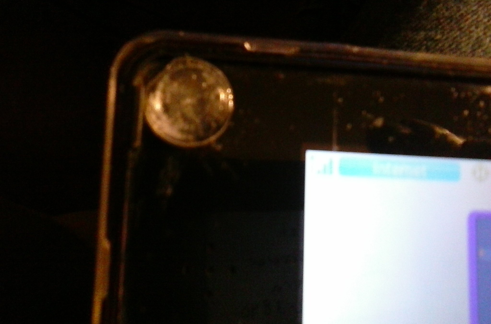

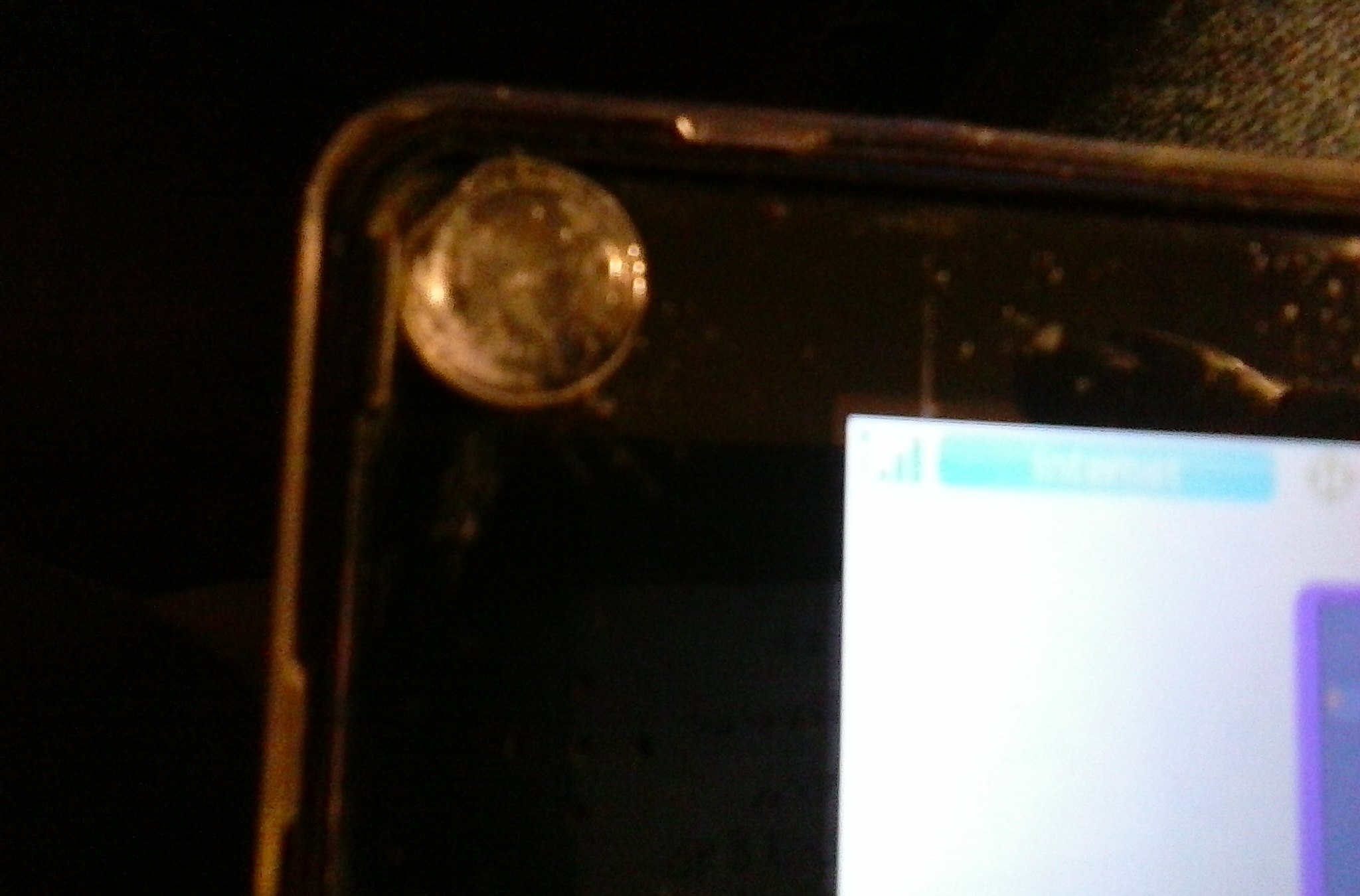

buy these little rubber buttons at walmart
and put them on the top screen upper right and let positions as so and that problem will stop. ASAP.
These do what they designers failed to do. But does not remove the lines already there. They make them in differnet sizes, they're less than $2.00 USD.
Good Luck. SyFyTy
Good Luck. SyFyTyView attachment 10246View attachment 10247
Clever. I like the way you think. :yay:
As for removing the lines, consider trying DISPLEX. It won't cost you a fortune and it just might help if applied and used correctly.

I actually had the idea about those bumpers when I first heard about the problem. Thats when the first 3ds was released... when they first came out. At the time I lived so far from a store (2 hours) that I didn't bother and made something myself at home from silicone (flexible), These work better.
I never posted it since so much time had past and I figured so few cared at the point. I had actually first noticed a similar problem when I attempted a shell replacement on the first DS lite I owned. That's when I found out what the rubber pieces (small strips) that rest on either side of the top screens [upper and lower shell] were for... Since there were no visible lines though, the reasoning was no so.... visible...
PS make sure that left hand button is well up in the right hand corner other wise it could press on the D pad when the lid closes. There is a smaller size but I wasn't sure if that would have done the job, they're hard to judge being clear and almost invisible to the naked eye, these did the job nicely.

Also syfyTy great use of cheap cupboard door bumpers. I'd recommend this method too, since it removes the only reason the scratching exists in the first place.
