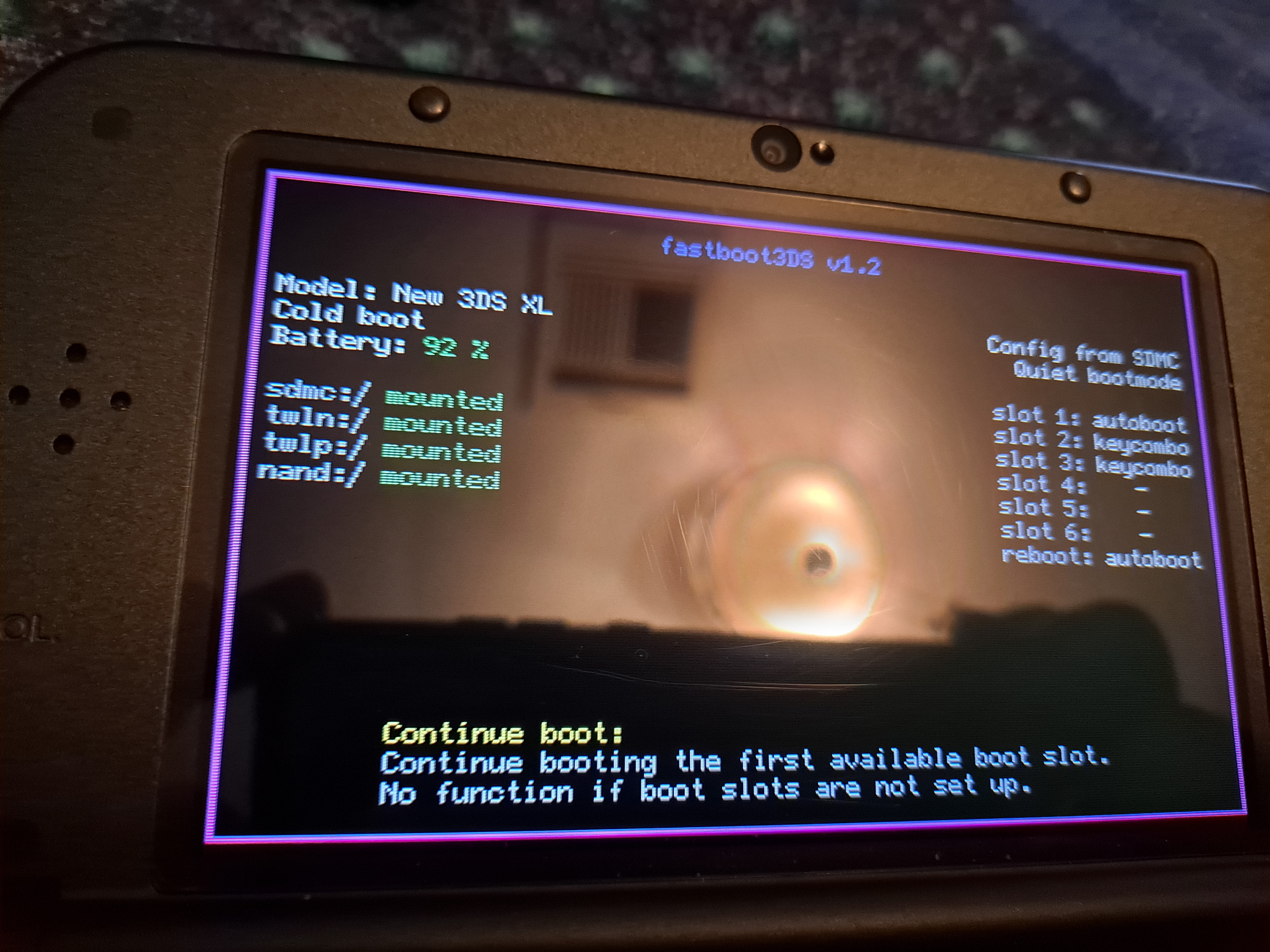

for those interested, this is what fastboot looks like. you have to hold home when booting up the system to access its menu.

I don't think fastboot technically boots up faster. you just have more control over what's bootable, like you don't have to do chainloading, you can change the basic start/select buttons and what they boot up, you can add firms with any button to boot them up just like godmode or something. I have L set for open_agb_firm. fyi, it's for the gba. it's about on par with the vc games.
