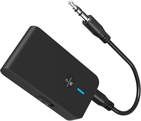

It would basically be one of these Bluetooth audio transmitters but powered by the DS' Slot-2 3.3V rail.
