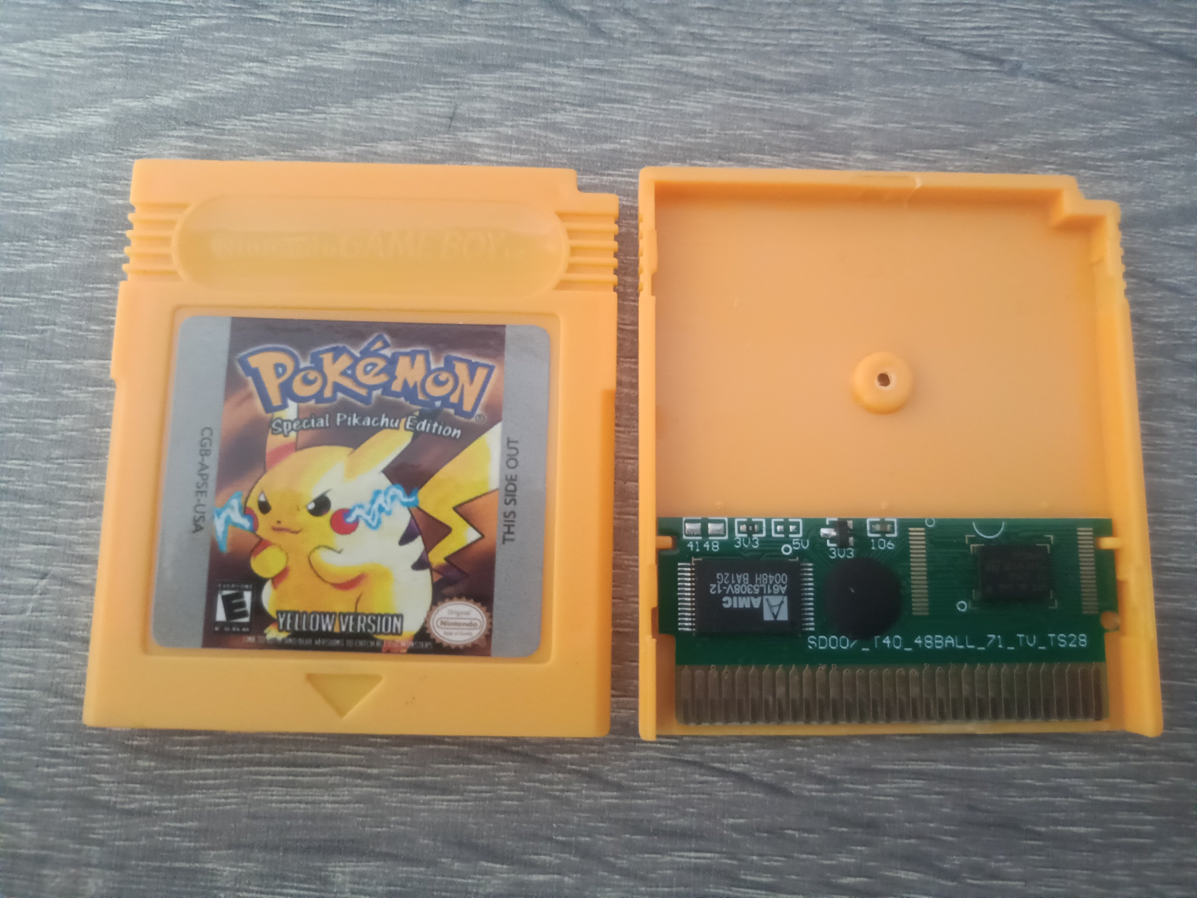

Got this cheap Pokemon Yellow repro without a battery. Seems to be that it works like GBA repros where the save is saved inside the rom. I wonder if there's a way to backup the savefile so I can transfer my Pokemon team to modern systems. I suppose I need some kind of GB flasher to extract the rom, but I don't have one. I only have another Game Boys and a Link Cable. I've found a tool called gb-save-manager, but seems to be that it doesn't work with these repros.
Is there another way I can backup the rom or the save without a GB flasher? Like a tool for extracting roms using the Link Cable?
The other solution I was thinking for was to trading my Pokémon to an original cart (kinda pricey) or a flashcart, and extract the .srm file from there. But in that case, my save will be trapped in the repro cart forever.

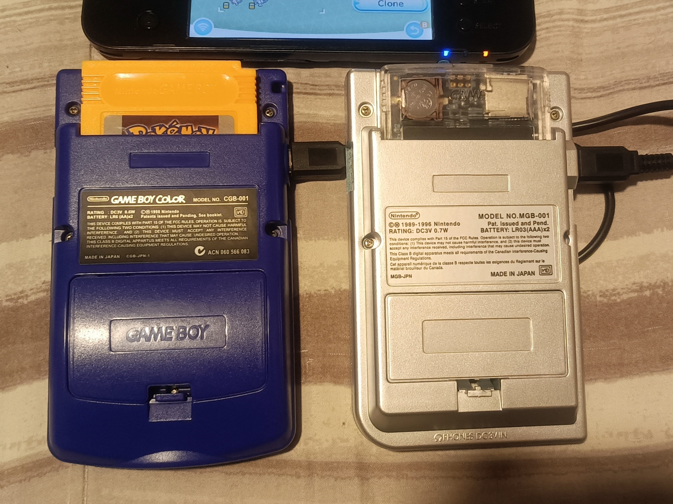

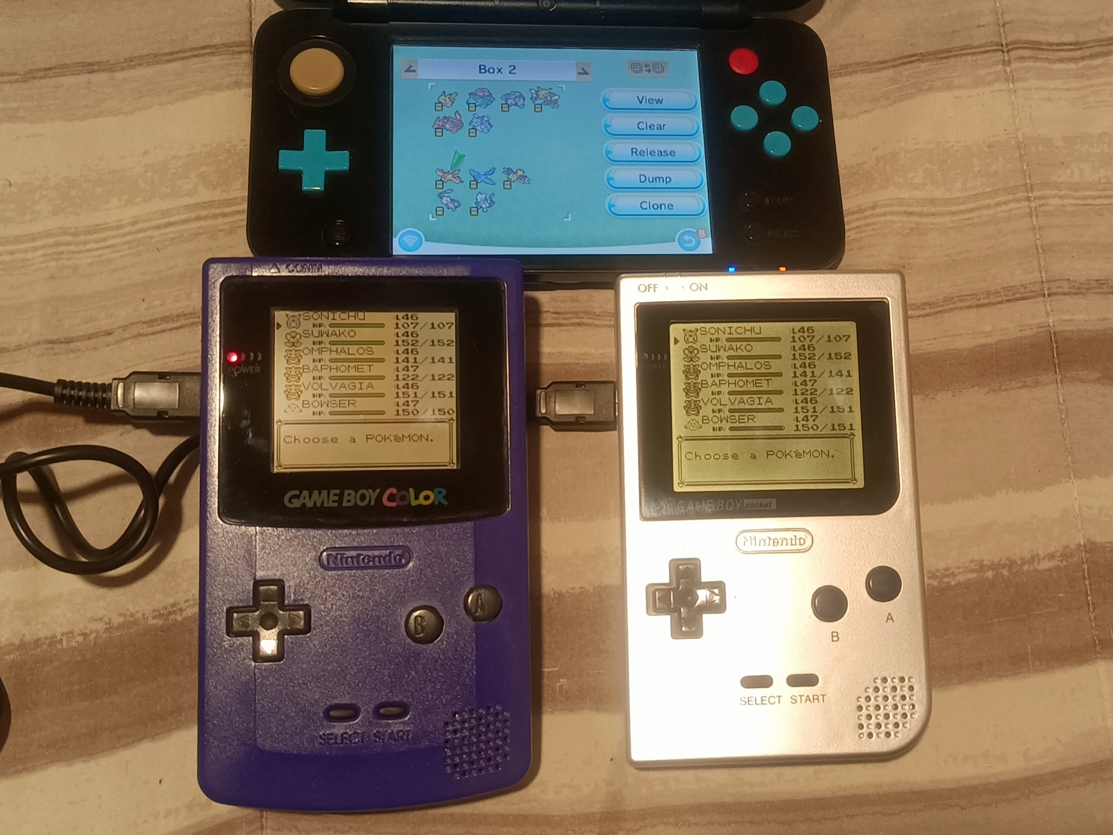

At the end, this is the method I used to preserve my Pokémon Yellow team (and legendaries, why not). I used a Link Cable and a EDGB flashcart.
  • Create a new save file in the flashcart
  • Trade/Clone Pokémon from repro to flashcart.
  • Save the game in the flashcart.
  • Extract the .srm.
  • Convert it to .sav.
  • Put it on my 3DS SD Card.
  • Open it with PKSM.
