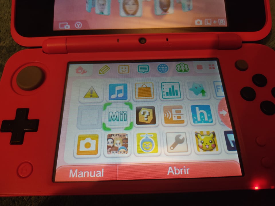

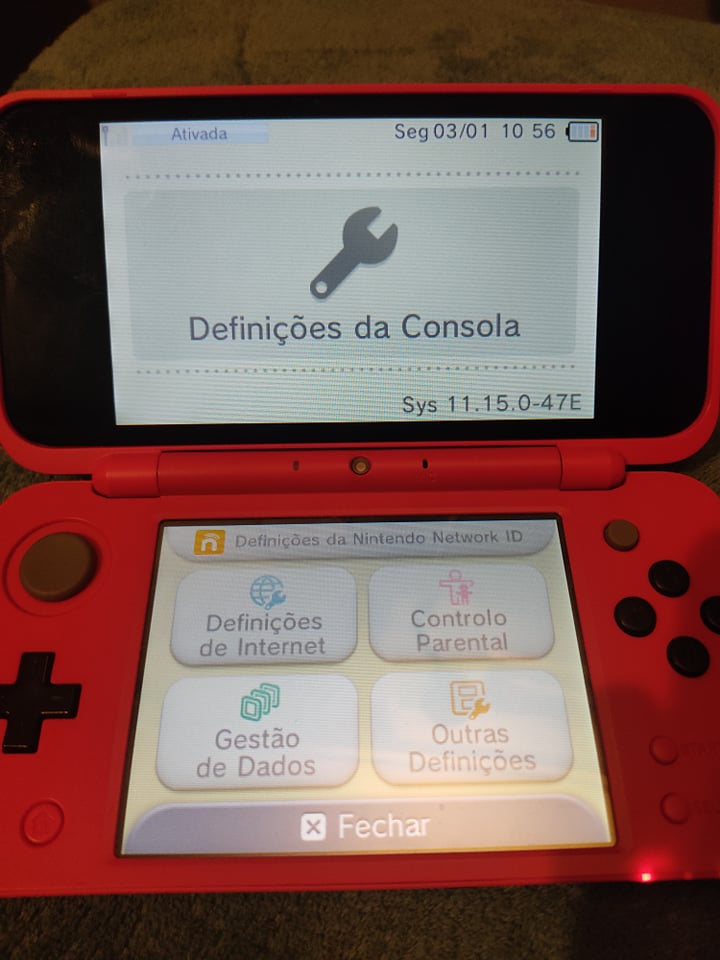

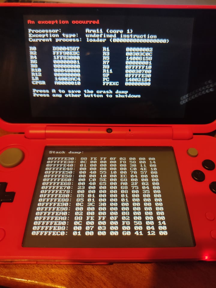

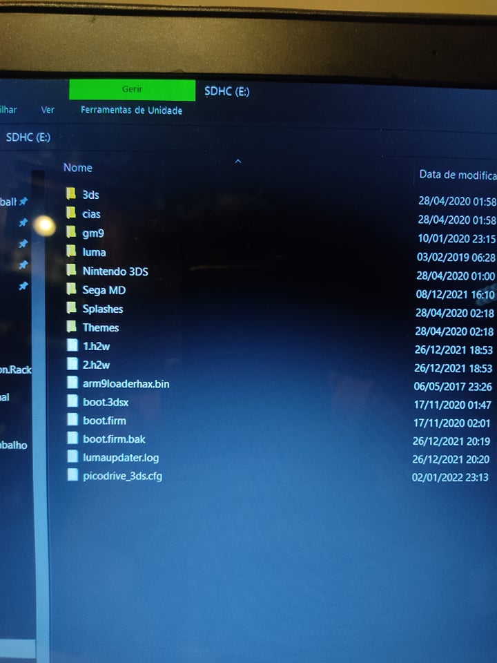

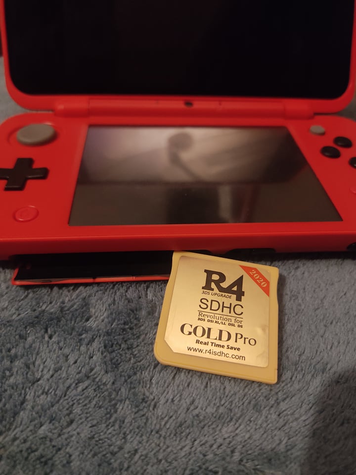

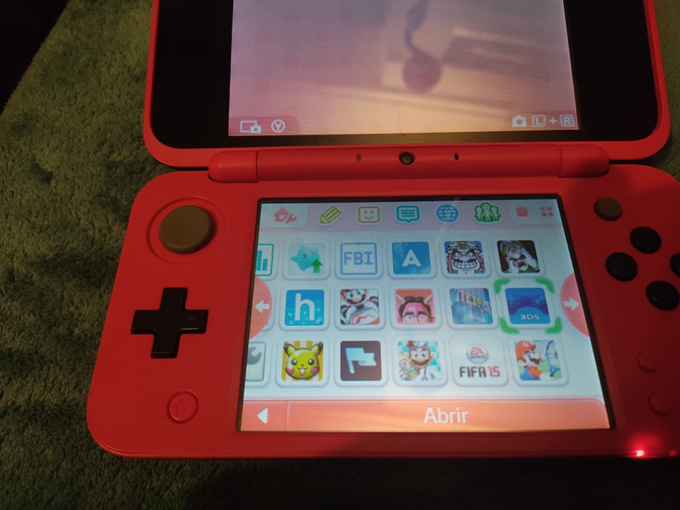

Hello
Sorry for the late reply. And thank you for the response
If you allow me, i took some pics of the screen and you can see by yourself since I have done this a long time ago and I cannot remember most of it to be honest.
Here it is :)

Those files are on the R4's sdcard? If so then you have Ntrboot based CFW. I would suggest testing without it inserted, i don't know how you could leave such a BIG of a detail out despite asking you before, smh...
