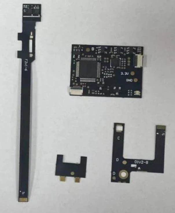

  • hwfly oled v4
  • QFN FPGA chip. Flashable, fully compatible with hwfly-nx
  • Appeared on aliexpress early 2022
  • Made for OLED model, should be compatible with all mariko units
  • No QSB for A/C/D points, direct connection required (Later batch may come with a QSB ribbon with holes which you need to solder to the chip)
  • DAT0 adapter, may come with black/yellow full adapter or yellow corner adapter
  • Runs a modded version of spacecraft-nx (no sd screen is white with rocket on bottom), can be upgraded to hwfly-nx (no sd screen is grey with hekate logo)
  • Disappeared after hwfly group got busted in china early 2023

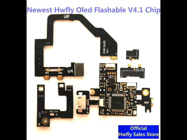

  • Hwfly oled v4.1
  • BGA FPGA chip. Flashable, but not fully compatible with hwfly-nx (FPGA firmware is reverse engineered, not original). Stability issues.
  • Made by another group, not hwfly themselves. I'll call them hwfly-clone group.
  • Appeared on aliexpress mid 2022
  • Made for lite model, should be compatible with all mariko units. It's actually a lite chip, but sold as oled chip
  • QSB for A/C/D points, ribbon cable quality is ok
  • DAT0 adapter, may come with black/yellow full adapter or yellow corner adapter. May also come with emmc adapter that breaks out dat/cmd/clk signals.
  • Disappeared after release of hwfly v5

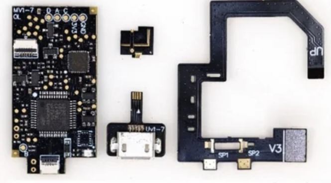

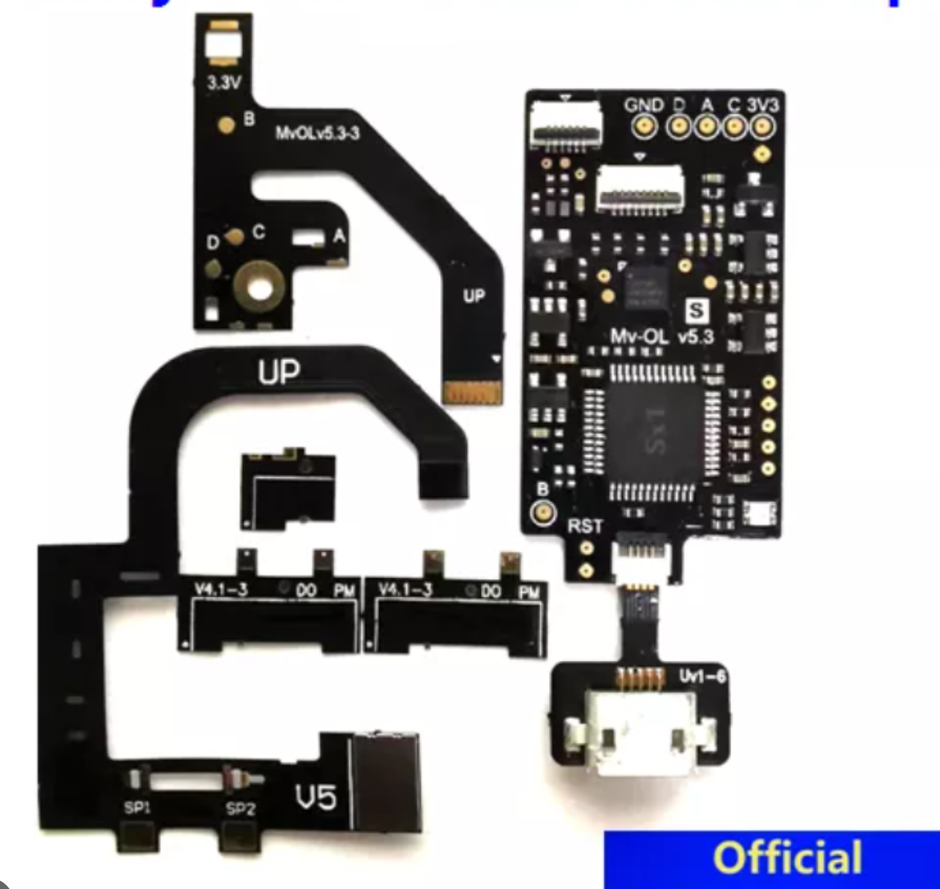

  • hwfly oled v5
  • Appeared on aliexpress late 2022
  • Made for OLED model, should be compatible with all mariko units.
  • QSB for A/C/D points, ribbon cable quality is bad (known to cause interferrence on dat0 and cause emmc corruption)
  • Disappeared early 2023

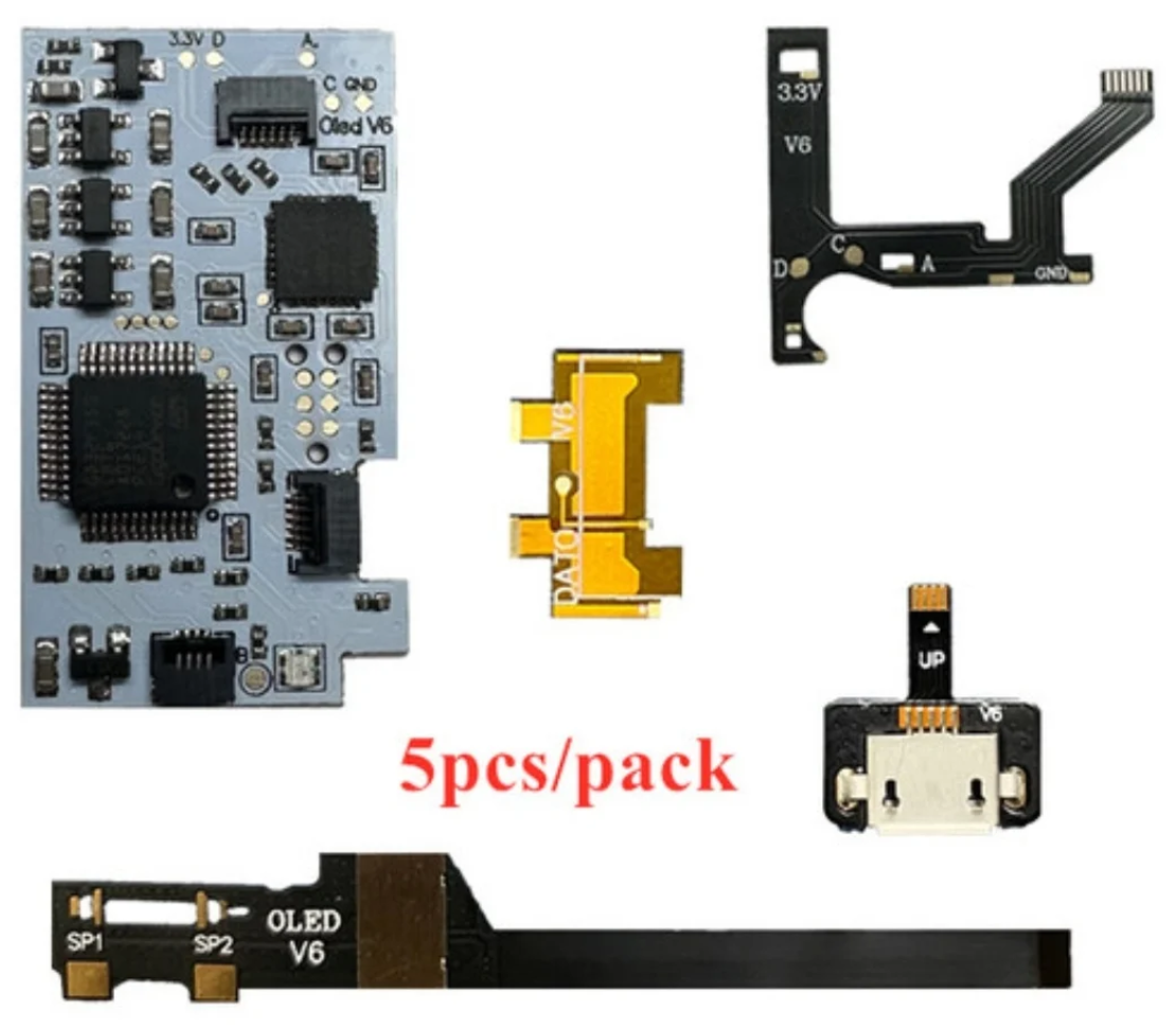

  • instinct nx (v6)
  • QFN FPGA chip. Flashable, fully compatible with hwfly-nx.
  • Made by original hwfly group (according to my seller on taobao they didn't get arrested and simply changed their name and moved on)
  • Appeared on aliexpress early 2023
  • Made for OLED model, compatible with all mariko units
  • First batch with black PCB has some QC issues (ground plane near A/C/D/3v3 pads are not fully covered and may cause a short to ground), fixed in later revisions
  • QSB for A/C/D points, ribbon cable quality is good. Mariko v2 and lite QSB cables are also available
  • Runs a modded version of hwfly-nx (no sd screen is grey with instinct logo)
  • Only modchip with FPGA in production

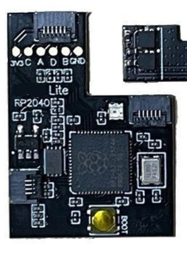

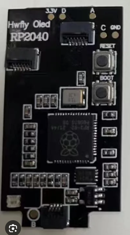

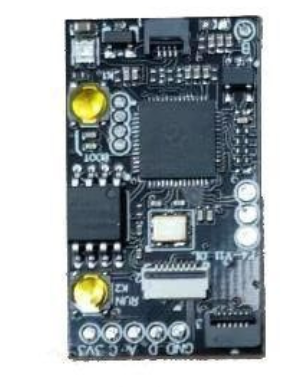

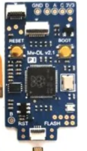

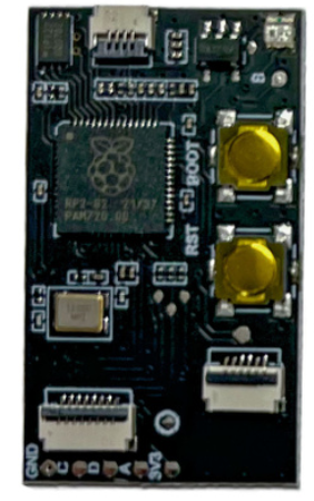

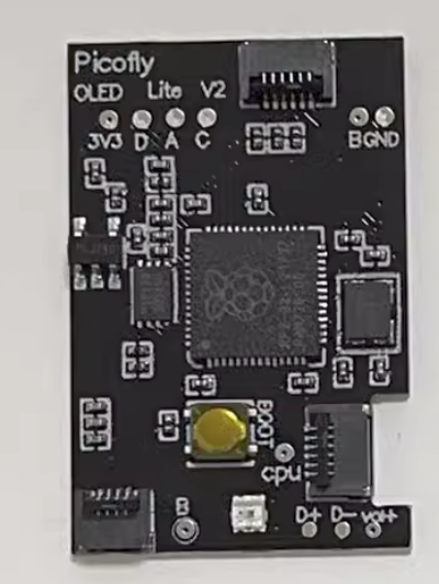

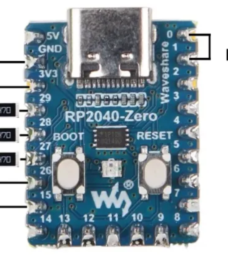

  • Picofly RP2040
  • Flashable, picofly firmware
  • Many, many different designs, but they all have the same rp2040 chip, spi flash and 1-2 buttons
  • Made for OLED model, compatible with all mariko/erista units
  • QSB for A/C/D points, ribbon cable quality varies.
  • Usually comes with dat0 adapter
  • Runs picofly firmware (no sd screen is grey with picofly logo)
  • Usually cheaper than instinct-nx, but may have issues with hynix/toshiba emmc. Not as reliable as instinct nx/hwfly v4
