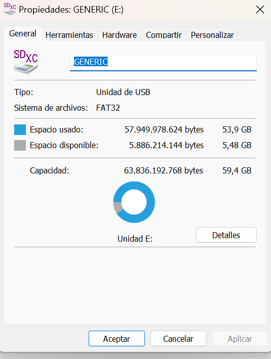

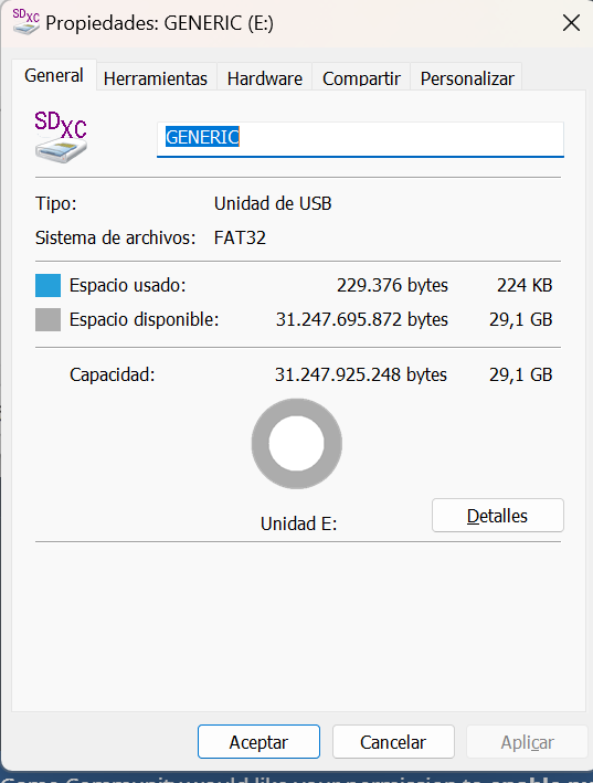

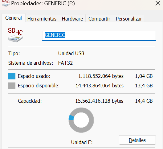

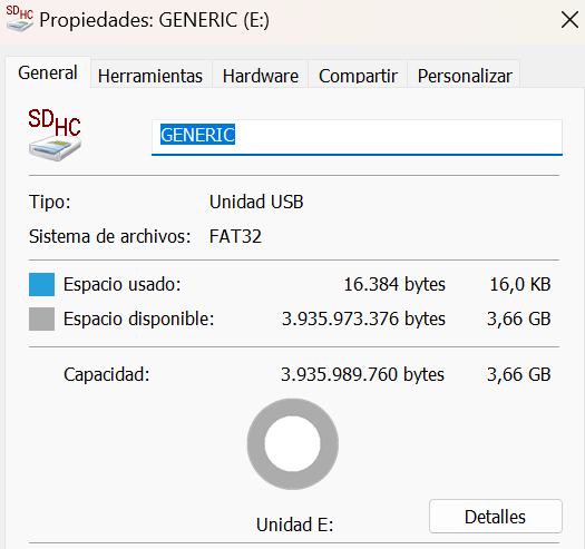

Are you sure the cards are formatted correctly? It should be FAT32 (on Windows, cards larger than 32GB can't be formatted like that without external programs)
The four I use for review have gone through RMPrep and guideformat. Fat32 is not the problem
