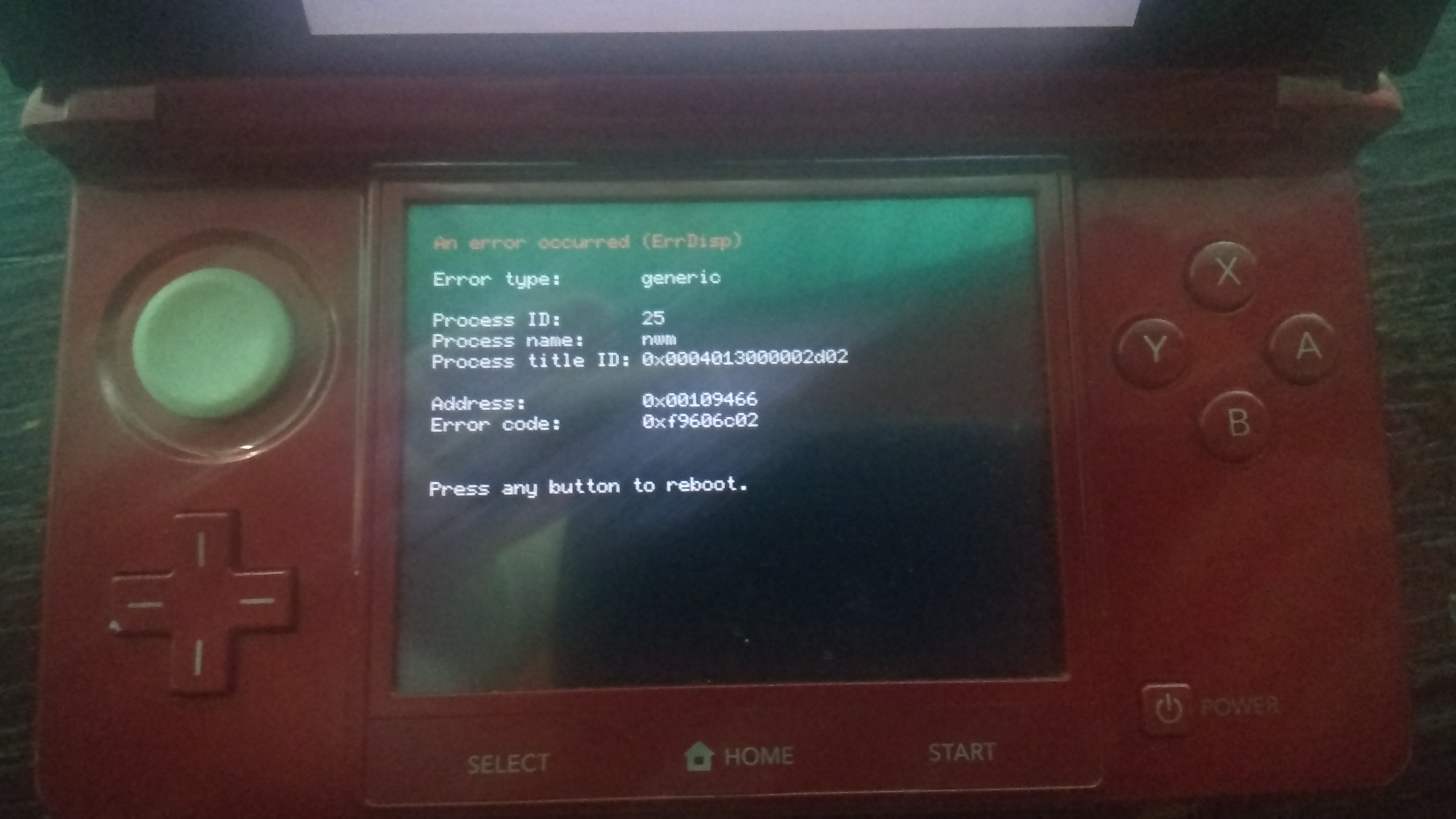

Homebrew An error occured (ErrDisp) Error type generic
I have tried it, but it is useless.
I have also tried change region, and it is useless too.
and when I playing pokemonster y, once I met a enemy, my 3ds is broke, and here is the error.
and I change my region via localswitcher, change the region from system Default to USA.
A fter I change region, some game will turn to black screen, when launch, I guess region is not the reason why my game broke.

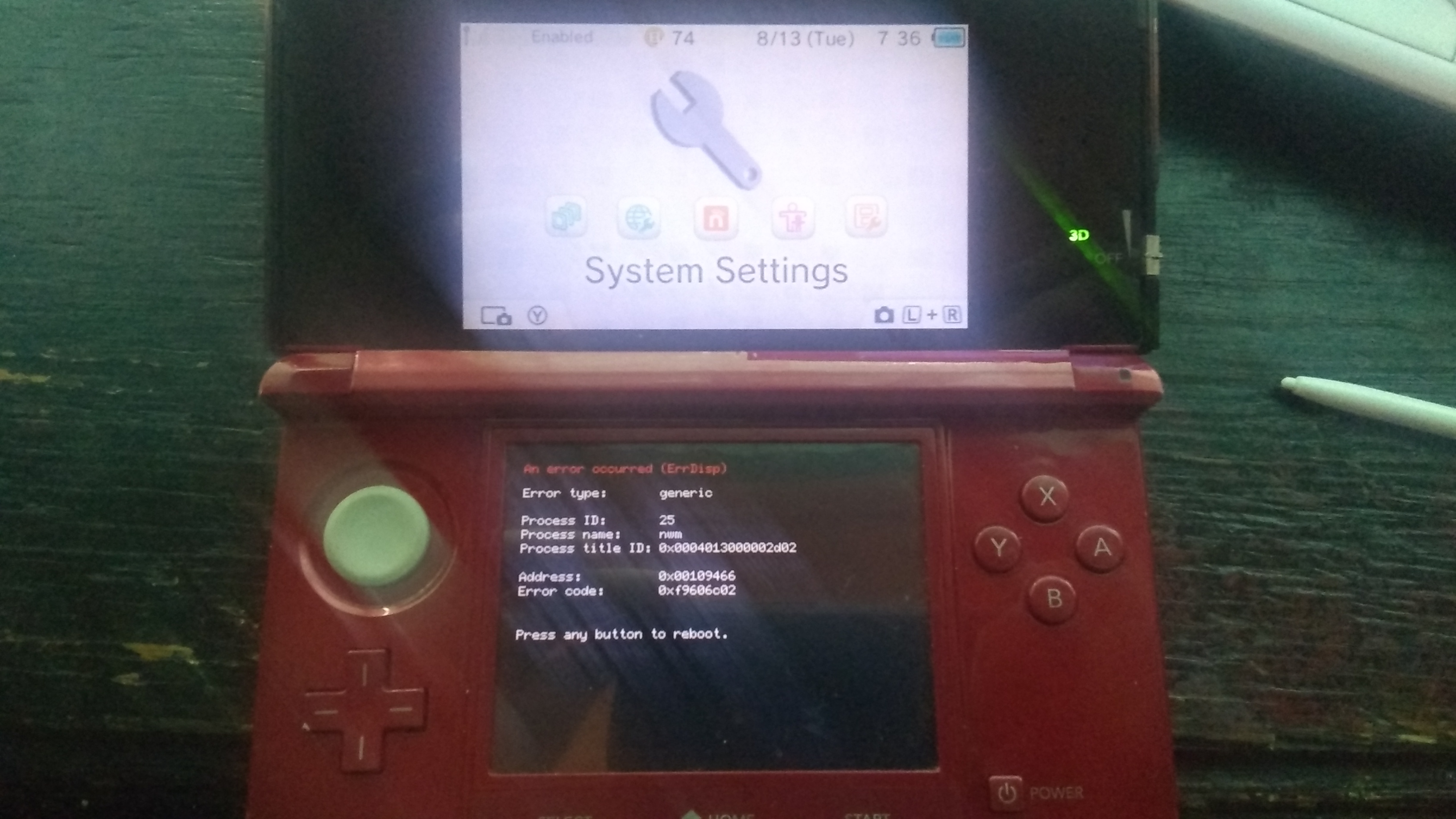

现在,错误如下
After I change region, some game will turn to black screen, when launch, I guess region is not the reason why my game broke.
-snip- <Now, the error is as follows>
After I replace boot.firm in newist version of luma, it seems my 3ds has be repaired. Thanks for your patient help. Really thanks.

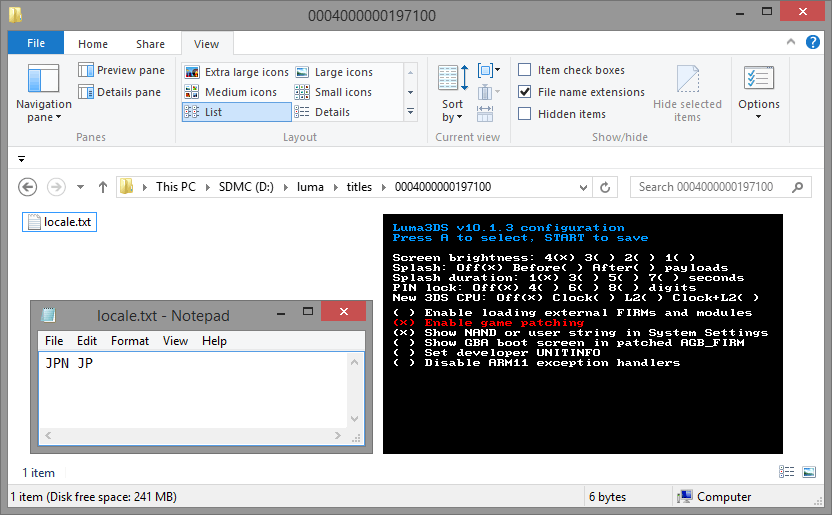

If problems persist, see these troubleshooting examples.
General gutline of the above.
  1. Copy everything off the SD ard.
  2. Reformat the SD card.
  3. Hardware test the SD card. Replace card if required.
  4. Copy everything back onto the SD card.
  5. Update the 3DS firmware + custom firmware. Use basic luma config settings.
  6. Test for data corruption. Salvage and rebuild the Nintendo 3DS folder.
  7. Import seed, luma locale emulation for out-of-region games, latest game updates, double check game mods.
  8. Repair the 3DS firmware + custom firmware.
