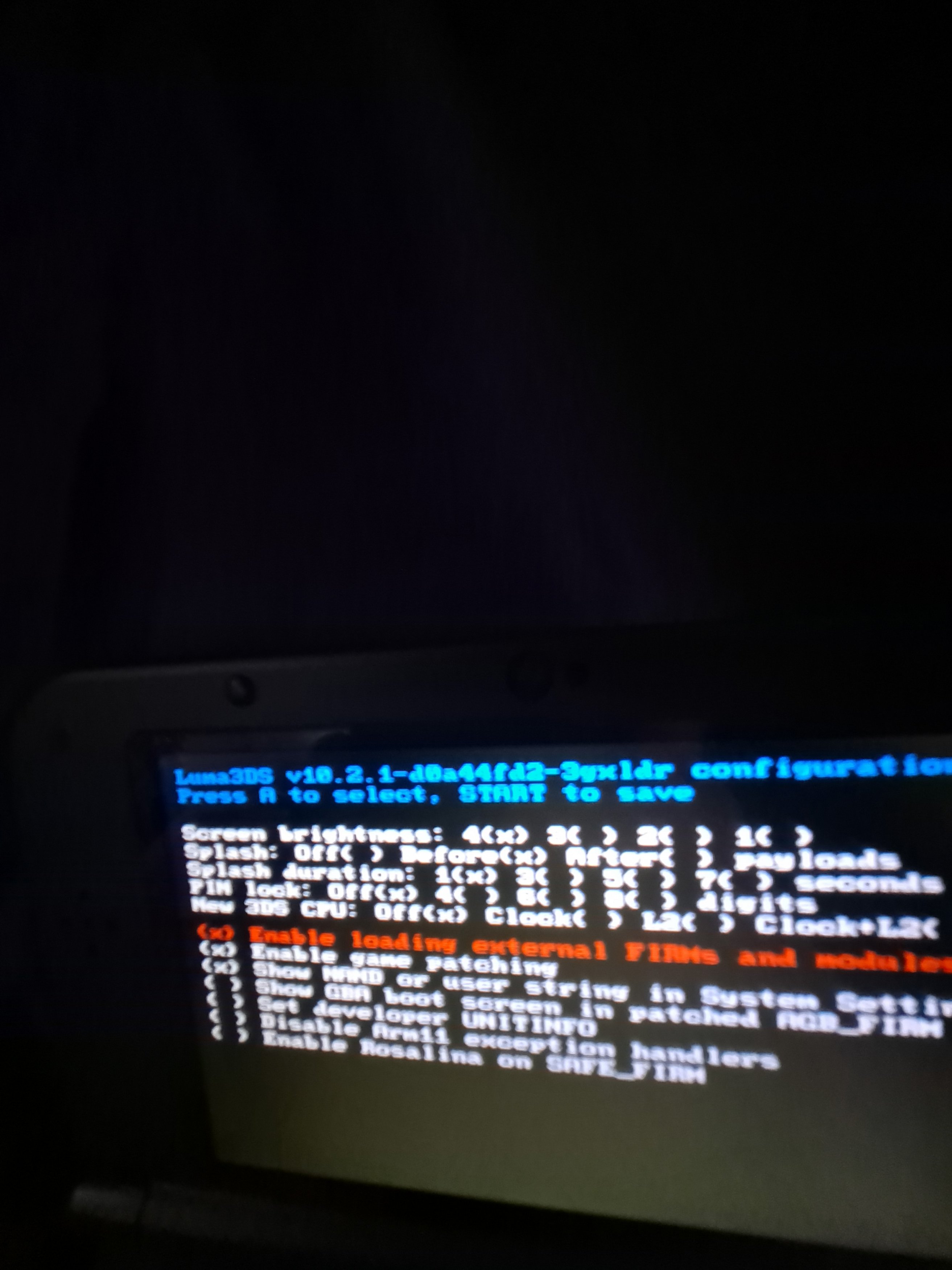

I just took this image to compare if that's what you meant @TurdPooCharger

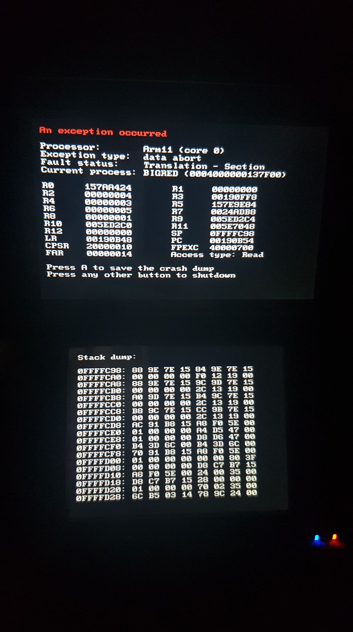

oh and when "disable arm11 exception handlers"is off im getting stuff like this (this was new super mario bros 2)
Don't use the ( ) Disable Arm11 exception handlers, as in don't select that option with the (x).
Unless you have certain game mods, plugins, cheats, or patches that must have that turned on, the average 3DS homebrew user should leave it alone.
That feature can cause a slew of problems that are hard to pinpoint and troubleshoot such as corrupting the Nintendo 3DS folder's database files (title.db & import.db), compounding instabilities that can softbrick the 3DS firmware, and general playability for vanilla(-ish) games.
0004000000137F00 is the TitleID for New Super Mario Bros 2 - Special Edition (EUR).
Does your o3DSXL's region firmware happens to be matching EUR?

6. Insert the SD card to the o3DSXL. Turn on the system → hold (SELECT) → Luma3DS v10.2.1 configuration. Use these exact settings. Press (START) to save.
  • luma3ds_v10-1-3-png.214219
  • Do not enable or mark (x) for any other options than the one shown in the image.
