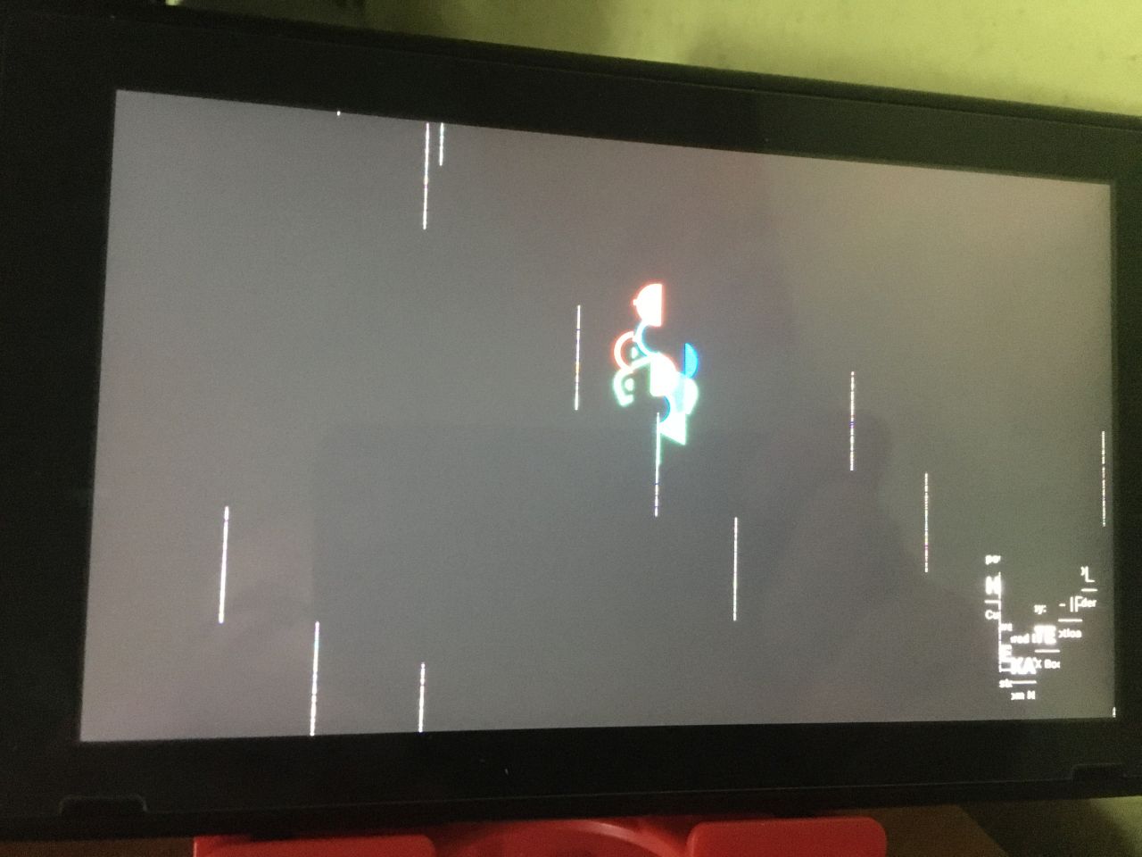

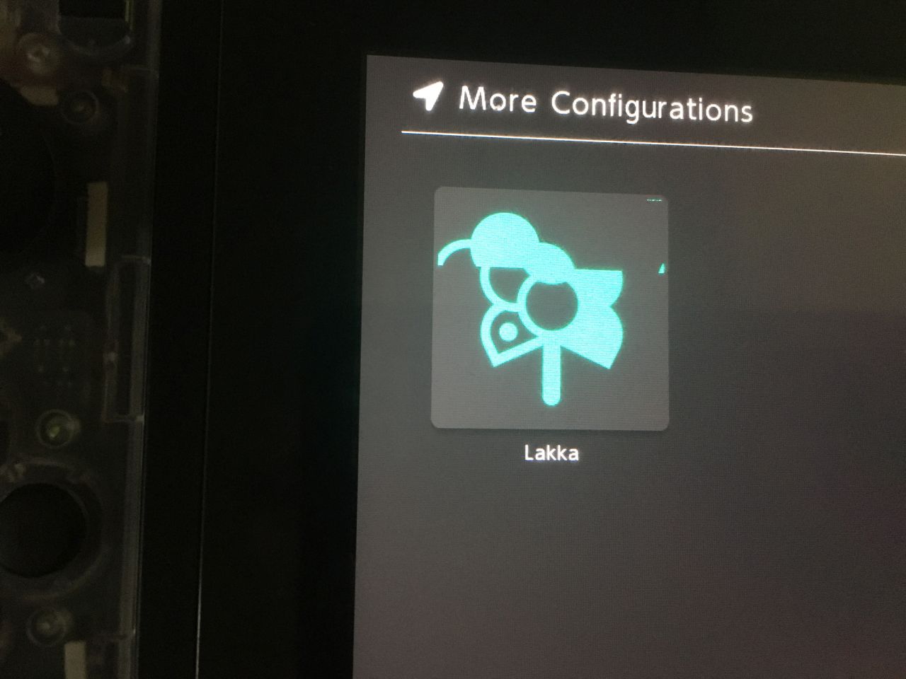

A moment ago I noticed another problem. After installing Lakka, as well as Ubuntu, the logo is deformed and the system does not start. Strange ... It's like Switch doesn't like Linux. Maybe it's a hardware failure ...
Yeah…my Lakka, Ubuntu and Android icons in Hekate are not corrupted like that. All is unrelated to Linux while in Hekate…other than the names of the other software. I’m thinking your SD card might be getting ready to go? Do you have another SD card you can test with?

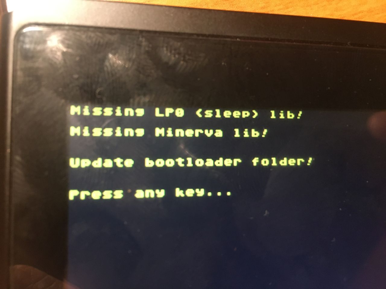

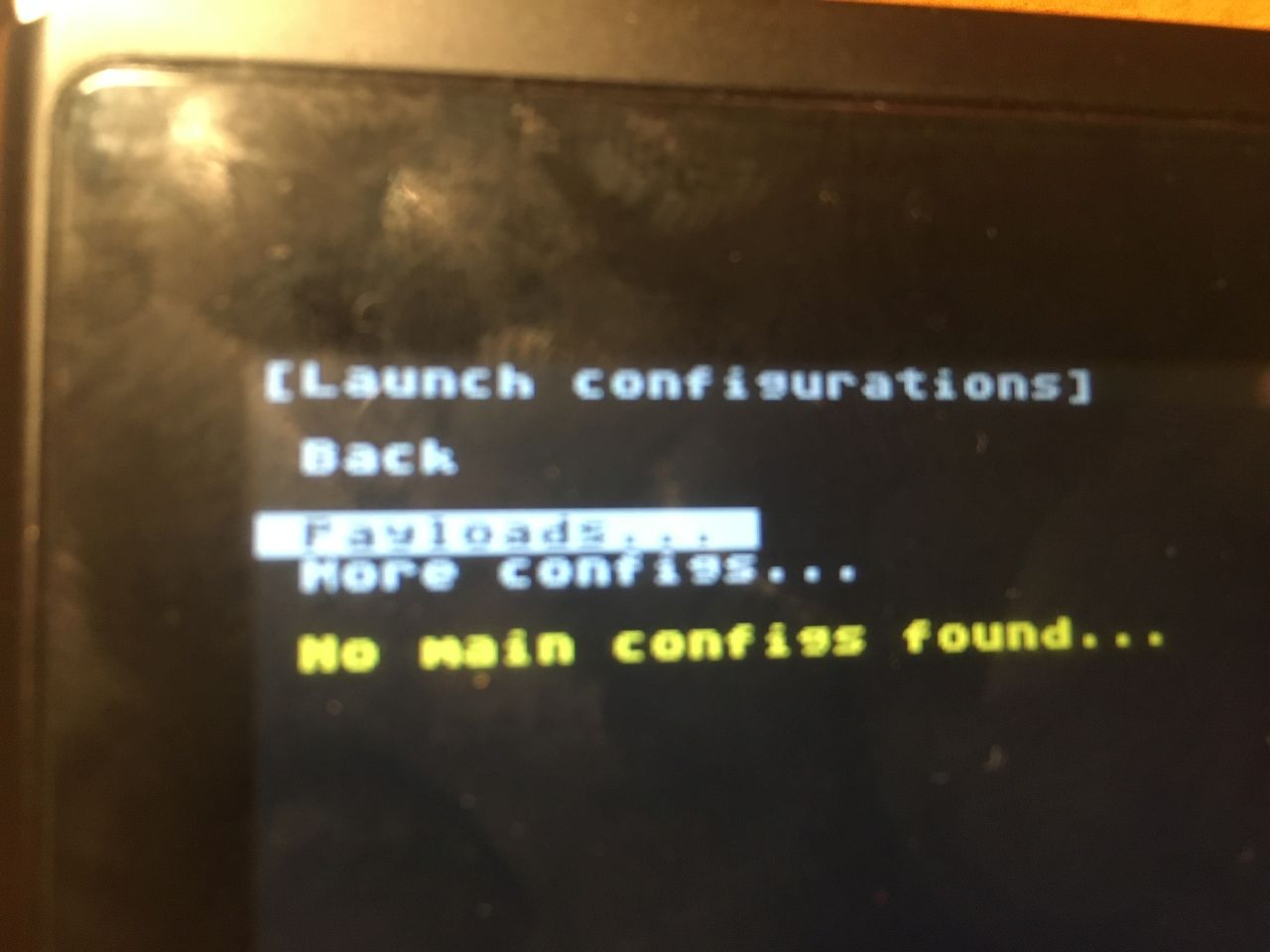

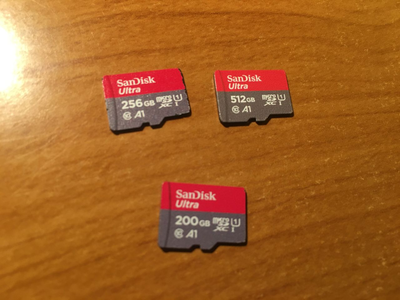

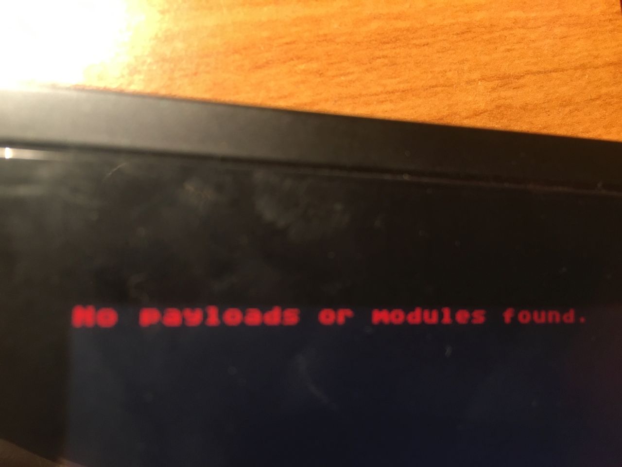

Something is probably wrong with the switch ... On 256gb and 512gb cards there is a linux error, and the new 200 gb card shows that there is nothing on it, and I have uploaded everything, including payloads
Maybe a bad sd card reader? Try to format one just using HOS on the Switch and see if it comes back with a valid partition table.
