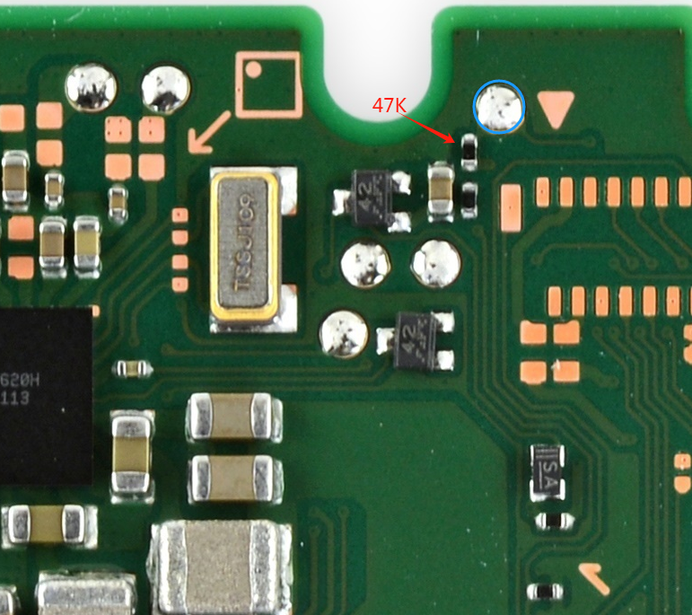

Hello! I hope someone can help me determine the value of this resistor. I have a donor board unfortunately the same component is missing from the donor board. Is there another resistor with the same value that I can use from the donor board?
Reactions: revsgrow
I have the same problem as you, even worse because I managed to remove both of the small ones underneath and perhaps the other one is also burned, let's hope someone helps us.
what happened when you turned the switch on without the resistor? i got one with the same problem as you but the console does not boot and the picofly gets me a pink light
console don't boot up without that resistor installed
Hello, Is the value of the resistor at the rst point of the oled switch board also the same value? I have problems with my oled switch and I believe that this resistor is the cause of the problem. Thanks!
Solved! The resistor, of this sector, the oled also has the value of 4k7. Thanks!
Reactions: BigOnYa
I'm asking myself if It could work the same installing the resistor directly on the emmc board on the same line and linking the other end to a gnd (on V1/V2 board), I've got a resistor of the right value but not of the right size, let me know your thoughts, please
