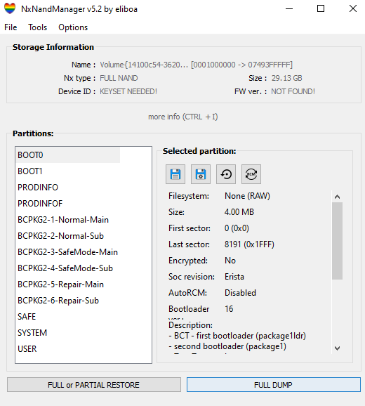

I didn't understand everything, but I'll try to follow the steps. I'll be updating in like 30 minutes when this process finishes. I hope I can do something about it :c
if anything, you will have a backup of that emummc at least. so if you have to delete everything and start over, you can at least get your old save files from this backup and restore them
(also, for what it's worth, fw ver: not found! is normal. the program can't recognize firmware versions higher than 14.1.1, but tht doesnt prevent it from being able to read the data and backup/restore)

Well, nothing worked, still the same message. I guess that the emuMMC partition is just corrupted. I'll restore everything and start over. Thank you so much for trying to help me. I appreciate it!
