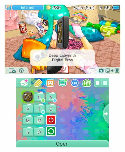

So I almost forgot about this thread until I remembered how much I hated the horse icon and went to see if anything came of it. Then I found this post and was like, "I wonder."
Doing a little digging, I happened to find this thread, with a direct link to the update file (I was hoping to be the Deep Labyrinth icon) Being that the link was long dead, I used https://web.archive.org to actually download the file and flashed it using my DS Lite. Turned out to be Rafa Nadal Tennis icon. Not the one I wanted, but it did prove that I could downgrade my Acekard 2i to older firmwares.
So if I can dig up all of the update files, I can only mirror them on one filetrip, but I should be able to make backup of my flashcart that be flashed HW81 carts.
This doesn't give the option to change to just any game, but it does give the user the option to pick from previous headers.
Here is the icon on my 3DS

I am actually playing around with header now to see what I can do. First, if you have a DS Lite you can flash the older headers, I got me a web archive for everyone.
I actually got the icon I wanted B-)
