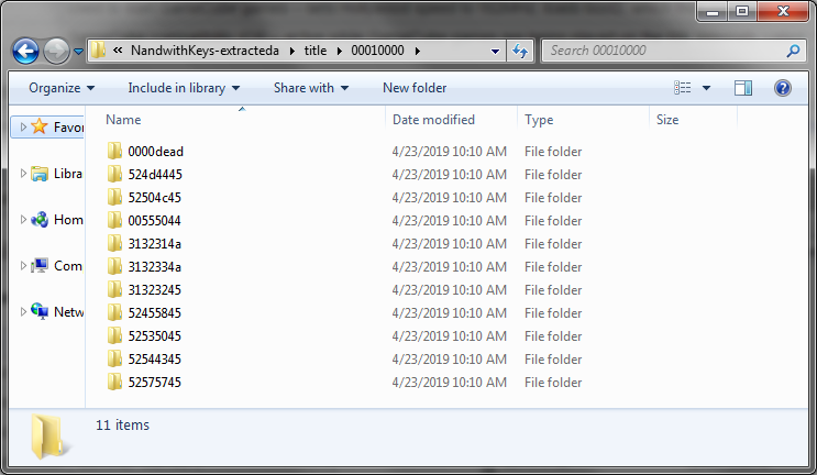

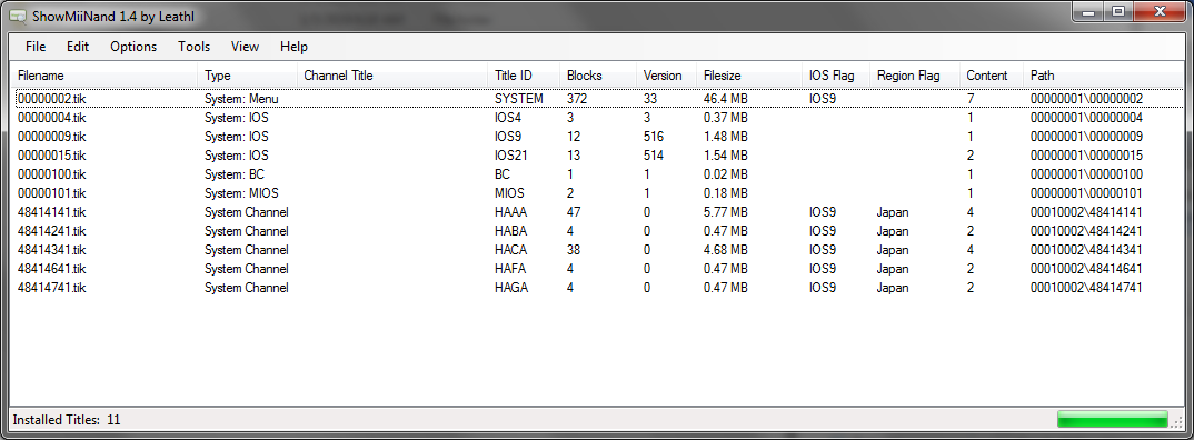

Not sure what to make of that.
That's the uid.sys from the startup wii, right?
I expected RAAE to be the first title, since that's the only disk the startup menu will boot.
(check this article to see what it looks like when a legit startup disc is used: http://archive.is/tQqap)
I can check through the documentation Bushing sent along when he returned the wii to me to see if he mentioned anything. What exactly are you looking for?
Where did the nand come from? I really didn't want that released to prevent people making fake startup disc wiis. (Although it doesn't really matter now.) Just curious.
