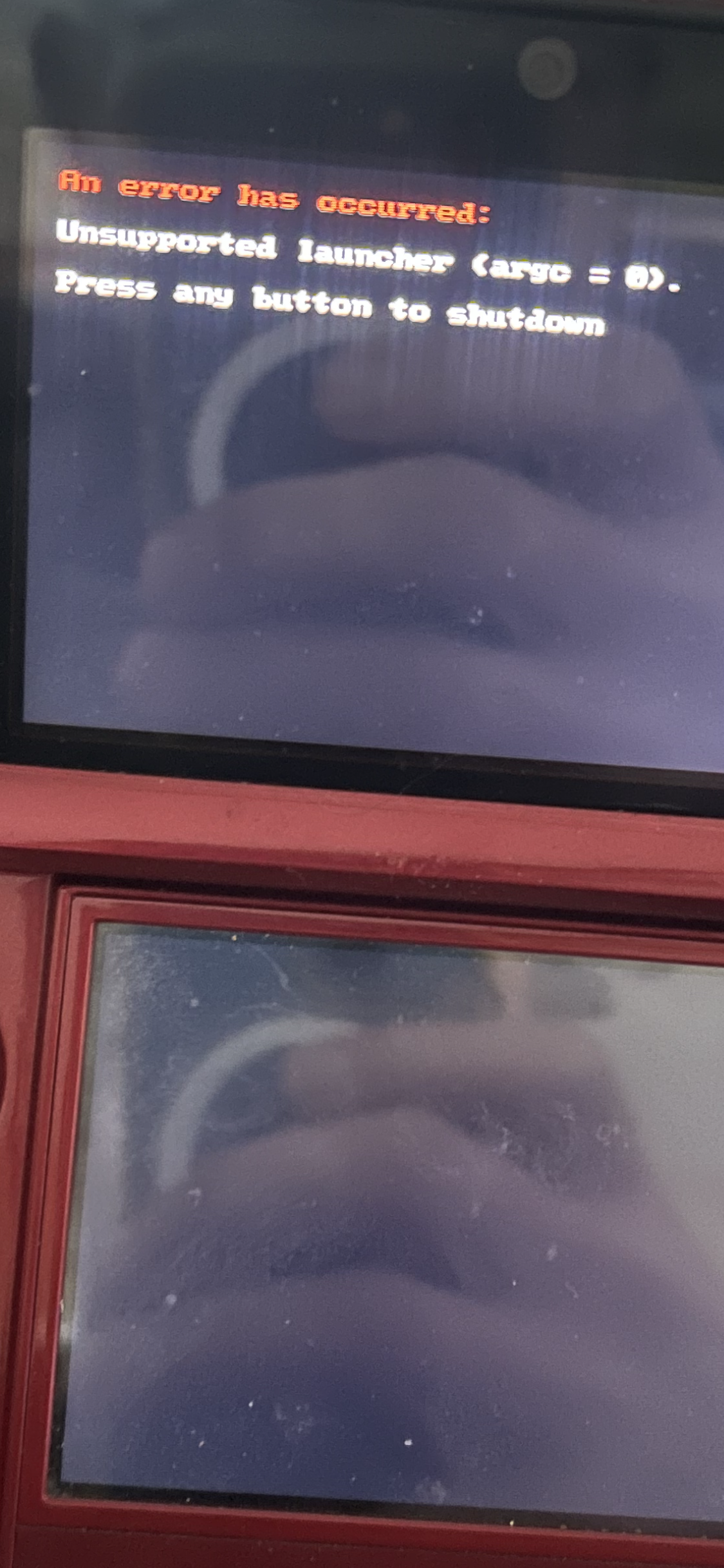

This is what the 3DS boots to. Every single time. SD card in, out, doesn’t matter. It always boots this:
“An error has occurred
Unsupported launcher (argc = 0).
Press any key to power off.”

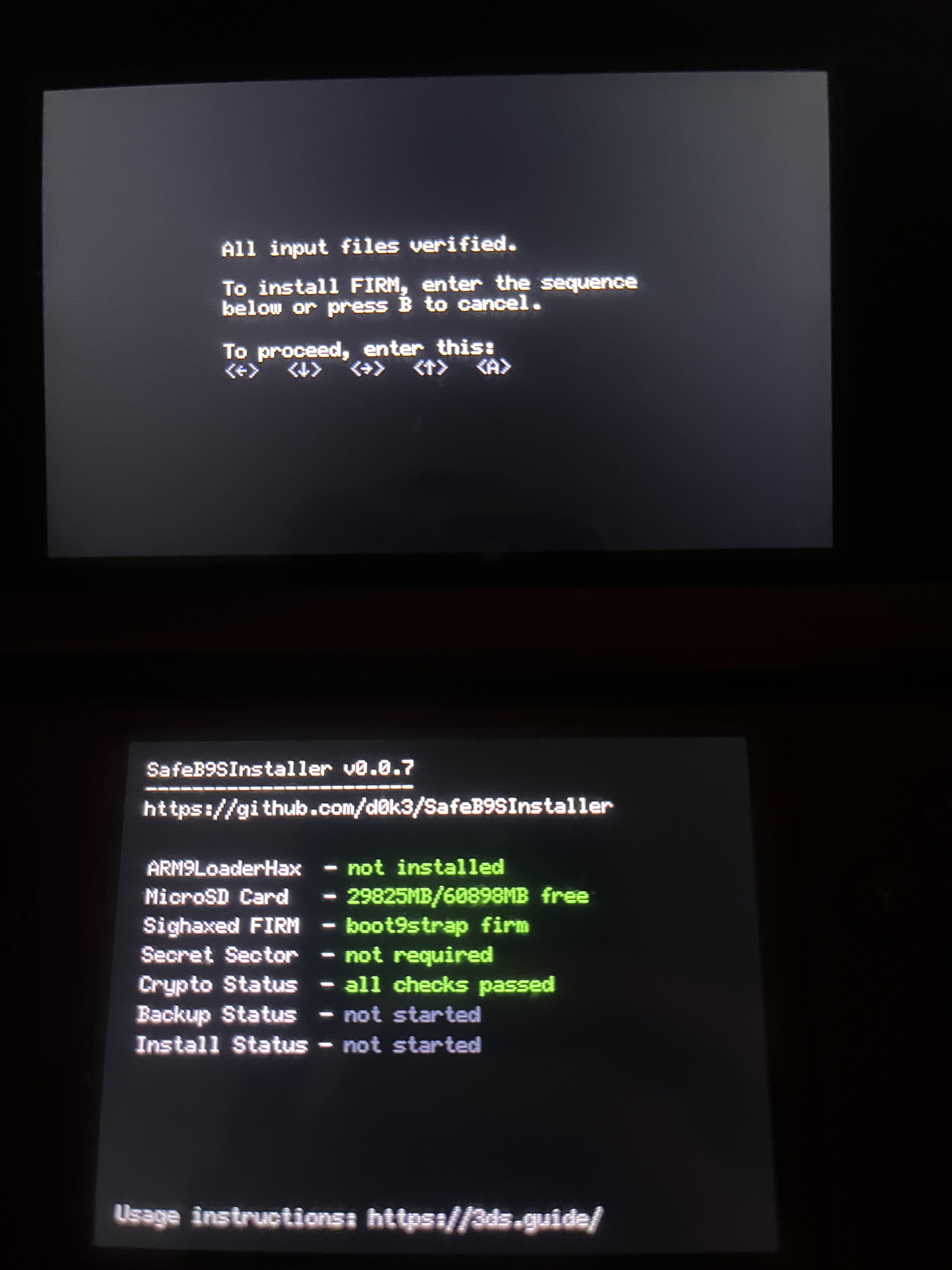

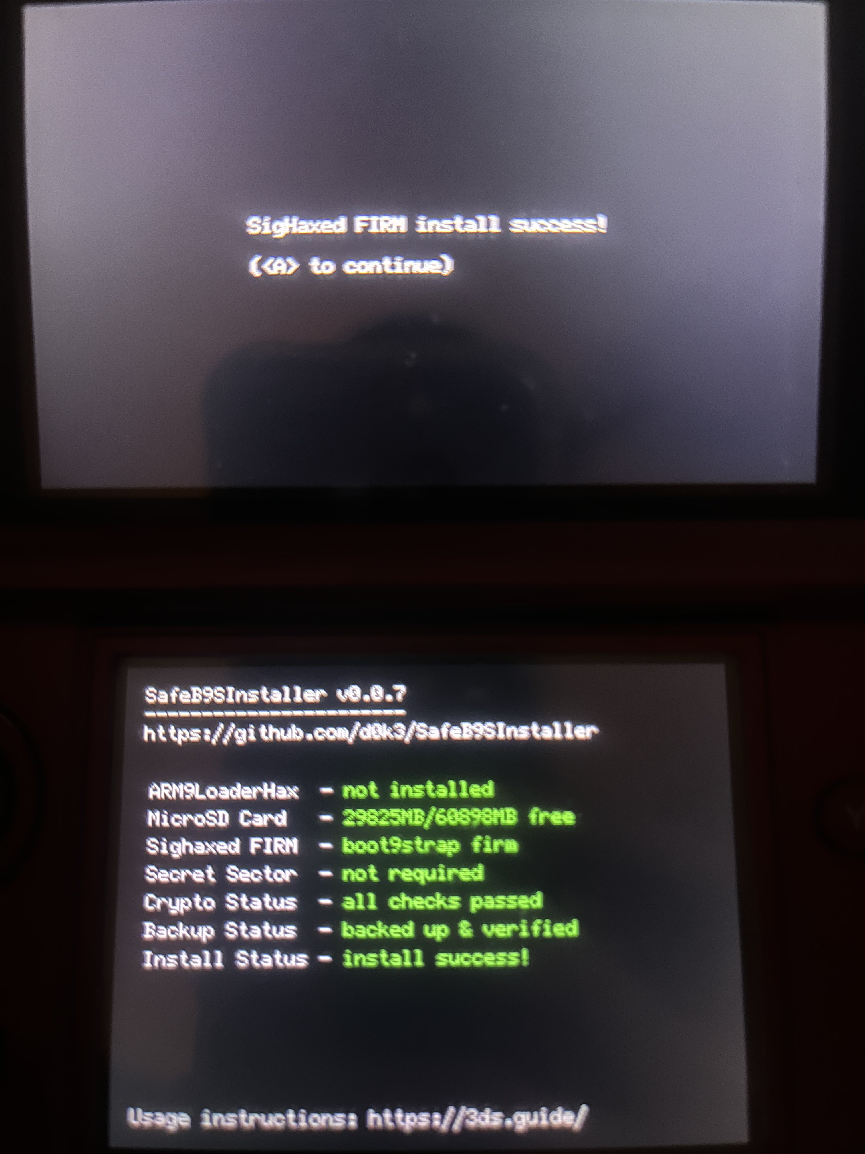

And as it turns out, that’s all I could do. I was able to replace the boot.firm with the safeb9sinstaller firmware file and boot it. Included is a photo of that. I was even able to install B9S just fine. Also included is a photo of that. I held power to power off and replace the B9S installer firm file with Luma’s. Next boot: An error has occurred.
To sum things up: B9S exploited 3DS will not boot from SD card or eMMC but will boot B9S installer from SD card. Will not boot any other payload in the Luma3DS payloads folder. Attempting to boot anything other than the B9S installer always boots “An error has occurred”.
What the heck is going on? Included is a photo of the error for posterity.
