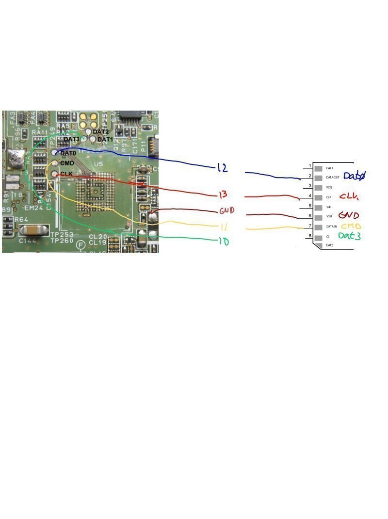

Today i will try to force erase the nand using arduino and the code from kriztian1997. First i will solder 5 wires to my 3ds. The other end i put in a breadboard, so i don' t have to resolder wires to the 3ds. This way i can connect the arduino to erase the nand and after that i can connect the microsd adapter to flash the nand.
Question: is it true that i don't need the 3.3v? Or do i have to turn the 3ds on to give the nand power?
WAIT, dont forget to lower the voltage to 3v3 from the arduino or you will fry your eMMC
