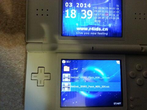

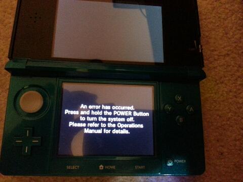

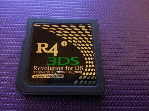

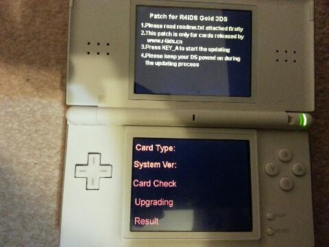

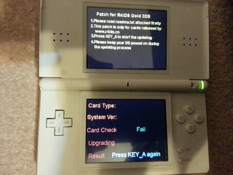

Bought R4i 3ds card from www.r4ids.cn. Was working fine. Updated 3ds to the latest 7.1.0-16E. r4i 3ds card not working – throwing an error “An error has occurred. Press and hold the POWER Button to turn the system off. Please refer to the Operations Manual for details”. Understood that I have to update using patch from the above mentioned site. Did try with different wood and patch available from http://r4ids.cn/r4i-download-e.htm (WOOD R4 V1.64, The 3DS V6.2.0-12 Patch for R4i Gold 3DS, The new patch for 3DS V4.5.0-10 & DSi V1.45, etc); and also in varying combinations; with and without removing the flashcard for a brief couple of minutes (before pressing A) and with DSi and DSl (eligible versons) – but every time the outcome is ‘Fail’. Is my r4i card bricked? Is there a way to restore it? Please help.
Note: this is the first time I’m trying to update my r4i 3ds card. Was working fine before I updated my 3ds.

Which revision do you have? Which has been your previous firmware (3DS)? Which icon do you have in the 3DS' menu?
Your card isn't bricked as long as you can start it using a DS Lite

That's encouraging. Thanks so much for your reply Technicmaster0. Sorry, i do not understand the meaning of revision here. I think my 3ds was 2 something before updating to the latest or perhaps 4 something - couldnt remember (but i'm sure i did it in order to play super mario 3ds approx 2 yrs back). i attach a picture of icon i get on 3ds menu. hope u could help me to resolve my r4i.

Like that other guy said, as long as it can turn on, on a DS Lite you should be able to restore it.
I bricked mines somehow and it doesnt work on a Lite and gets the FAIL error every time.

Did you try to unbrick it using the DS Lite only updater with another flashcard?
