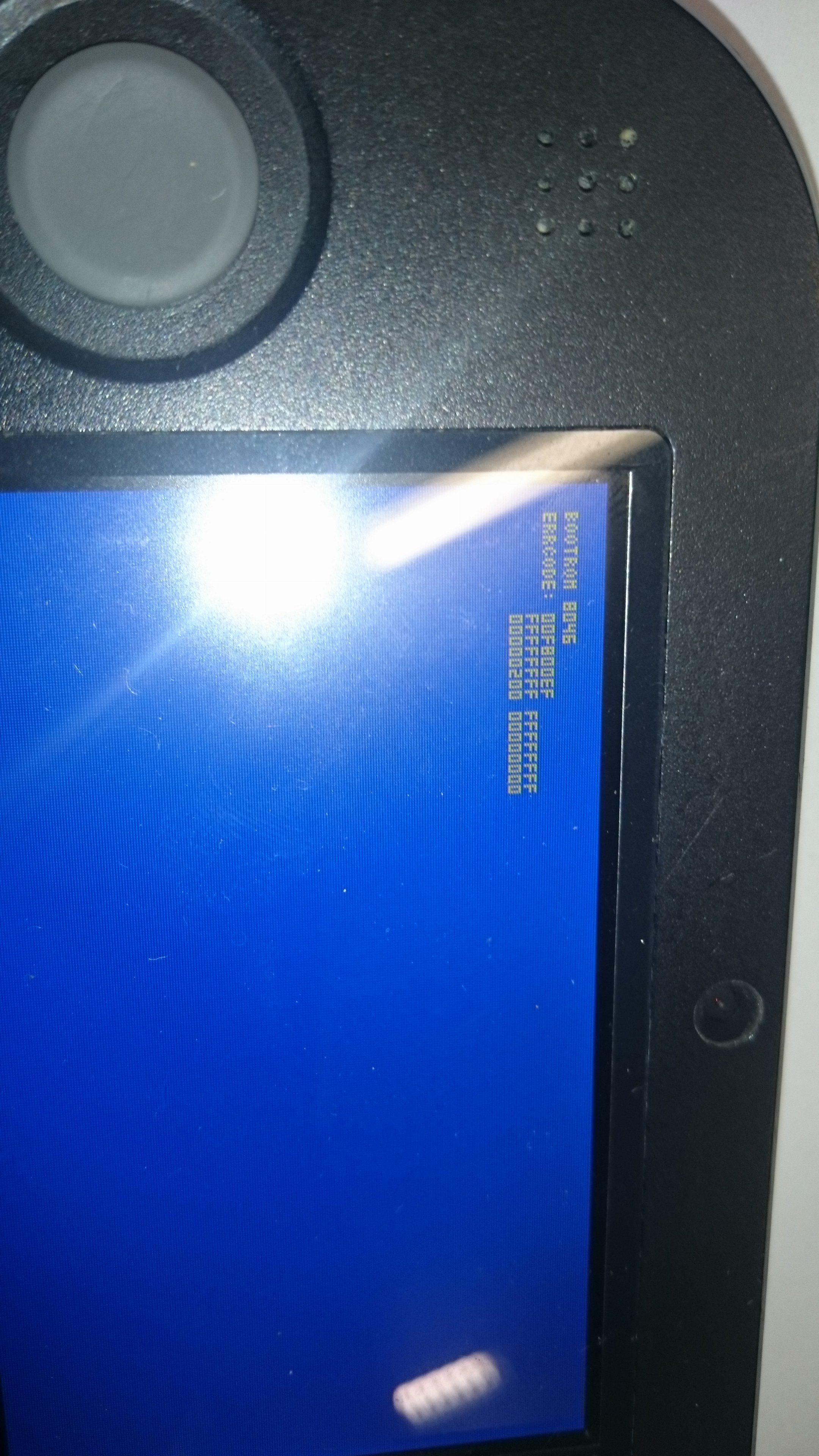

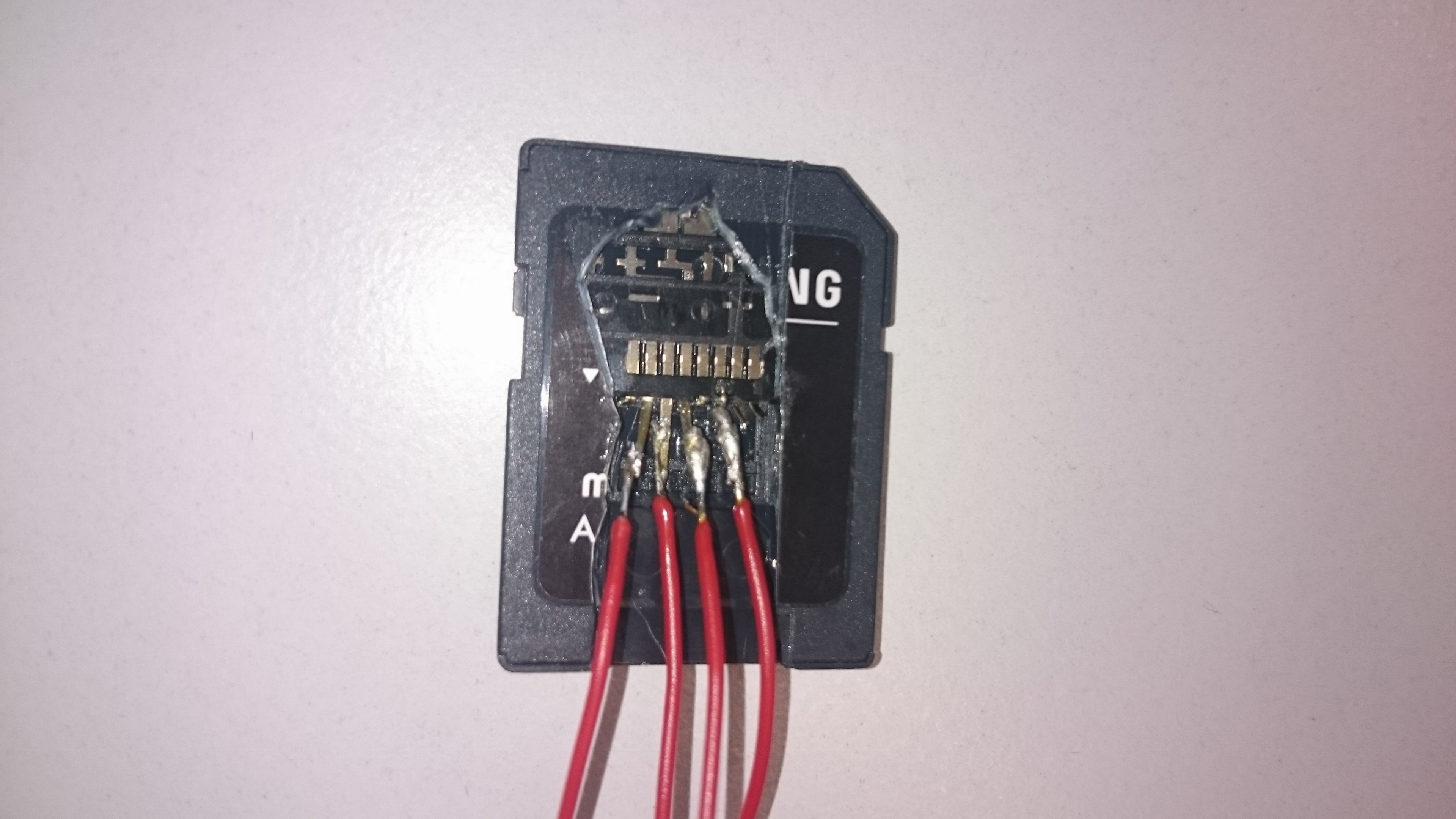

Hello there
I bought a used 2DS from ebay hoping it might have a older firmware installed
sadly it was 11.0.03E
so I tried using this tutorial here to do a Dump and then later downgrade it
https://gbatemp.net/threads/tutoria...ping-2ds-3ds-3ds-xl-n3ds-n3ds-xl.414498/#o3ds
here some infos
-2ds boots normally when franken DS is not inside of card reader
-2ds shows 00F800FE 00000000 00000000 00000200 00000000 when plugged in sd card reader (reader not connected to pc)
but im not able to choose a device in win32diskimager
here are some pictures
hope you guys can help me out here :)

You need to use an external sd card reader. Then plug the sd in, and turn on the 2ds. After the 2ds shows the blue screen, plug the reader into your computer. It should read it. Make sure to do your research to see which readers work with your NAND.

I tried 4 differnt sd card readers with your described method all were external but none of them made my computer accept the 2ds as device with a letter.
The internal sd card reader of my laptop at least made me choose the device in win32diskimager but reading is not possible win32diskimager just crashes.
Could it really be the sd card adapter ? I already ordered one of the rwcommended adapters on amazon but i just want to exclude all other possibilities which may cause the nand dump not working.
Peace Max

So I got the anker sd card reader and I get:
BOOTROM 8046
ERRCODE: 00F800FE
00000000 00000000
00000400 00000000
On my 2ds, but nothing shows up on windows or linux. Or when something shows, it does not work in win32diskimager.
So, idk what might be wrong.
BOOTROM 8046
ERRCODE: 00F800FE
00000000 00000000
00000400 00000000
Did you do it yourself? See if anything is bridged.
Sent from my Browser on a New 3DS XL with A9LH
I did it myself. Also checked about 30 times if something is bridged. System boots perfectly with the adapter out, thought.
That does seem odd. See if you sautered them in the wrong locations. Maybe one of them is in the wrong location. If not, pm vb_encryption_vb, and see if he can help you.
