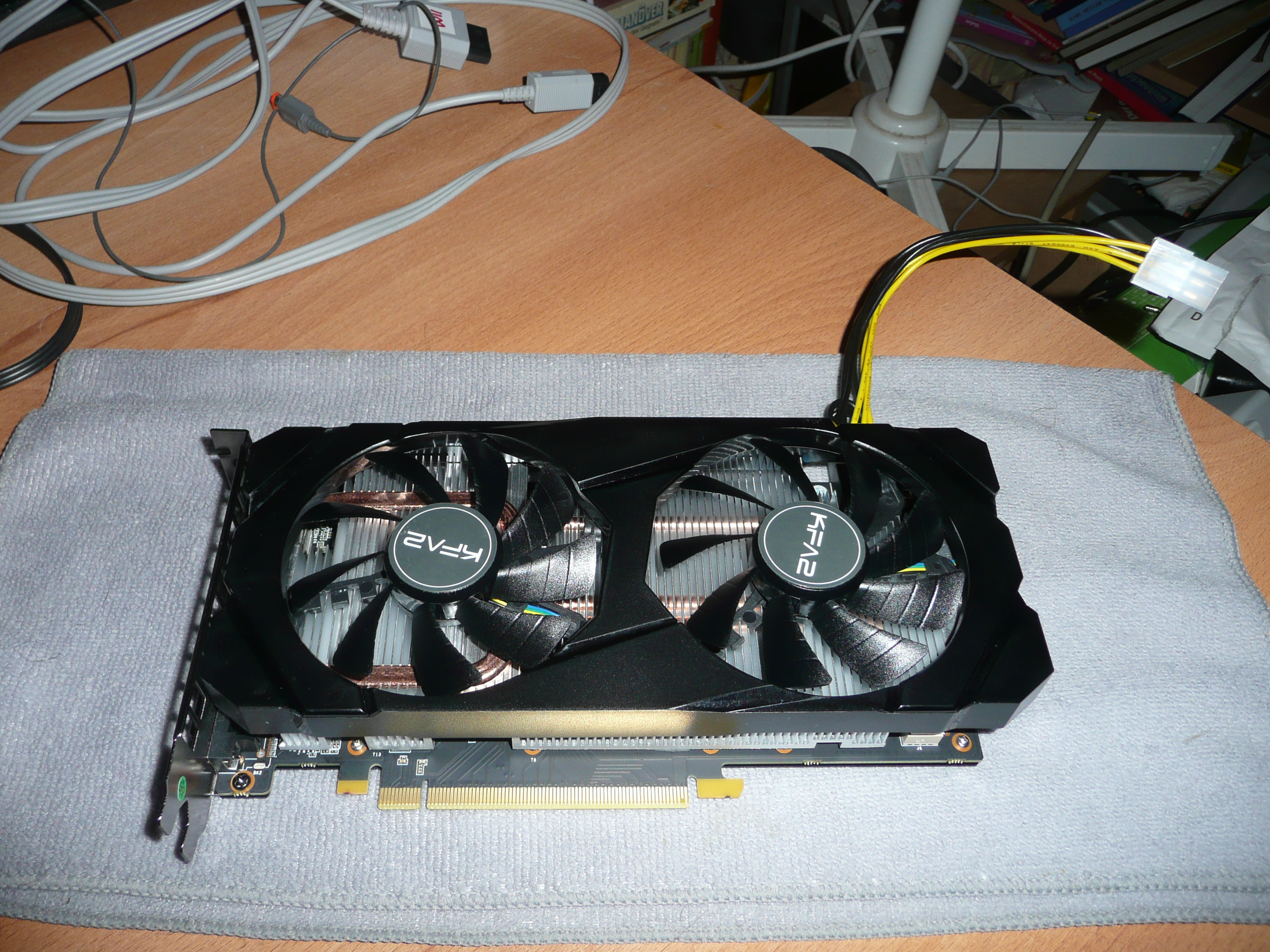

Update 12.October 2022:
KFA2 GeForce RTX 3060 OC Edition with 12 GB

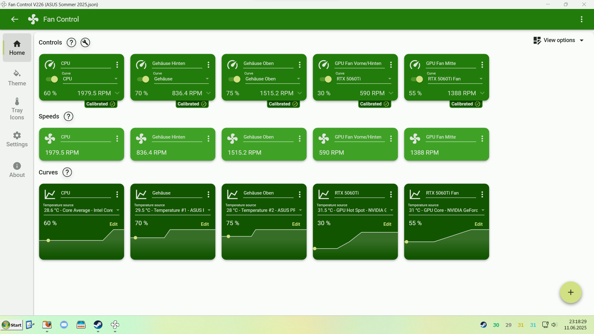

The CPU and Case Fan are out of Control.....
Before and also now I used SPEEDFAN for controlling/managing the Fans.I have set different Profiles and achieved a constant Temperature of 60° under full Load on all 4 Cores.
Since the Change of the Mainboard,the PC is a little like "sleeping Beauty".
For the main Time I use the other PC (Dual Core 3.4 Ghz/where all the Video Consoles related Tools/Progams are on).
Yesterday I would to watch my "Fu Manchu" DVD Box,where 2 Versions on every Disc.
I wanted to make MP4 Files of it.For this I want to use the PC from this Blog.
For enconding I use Wondershare´s Ultimate (now Uni) Converter.
As the Encoding starts,I waited a few Seconds before I want to leave the Room and was a little surprised,that on FULL LOAD I heared no FAN Noise (and Case Fan is normally an Aircraft Unit under full load...
The CPU Temperature rised up to 70 ° with ascending trend.....
I stopped the Enconding and "consulted" SPEEDFAN.All ok,FAN Profiles were there,Temperature curves are set,all set correct.:blink:
Started Encoding again,same....
Helplessness slowly spread...
Checked BIOS Settings,uninstalled/installed Speed Fan again,set new Profiles and set new Temperature Curves.
Started Encoding again....same.The Fan´s are not "responding".....
Started a few Games (F1 2019/Shadow of the Tomb Raider/Resident Evil 2 Remake).
Suddenly the Fan´s are on 100 Percent......
Noise and Helplessness again.....
Then I tried it without the Speed Fan Tool....same Effect.
The Fans are working but only on 0 or 100 Percent.The Fans ARE really on 0,the stand still !
But all this worked before on the old Motherboard....
The Fan´s was raised slowly but constantly and the maximum Temperature at Full Load was 61°.And they NEVER run on Full Speed (CPU 95 Percent / Case 75 Percent)
There was no Alternative,I had to go in the "technical Settings" of Speed Fan.
And there it was.Under "Advanced" and Chiip Settings:
PWM 1 Mode - SMART Guardian
PWM 2 Mode - SMART Guardian
Really ? I was pretty sure in MY Profles it was set to "Software Controlled"......
Now the Fan´s are "under Control".
In IDLE State 30/30
It raises with more Temperatue and
under full Load.
CPU 100 Percent
Case 75 Percent
Maximum Temperature 60°
Thank you for Reading.:)

Hello.:)
Today my good old Buddy made another big Step:
From the Gainward GTX 1050 Ti to the KFA2 RTX 2060 OC Edition.:)
Under Full Load it is getting a little "warm" (over the recommended 83° Limit...if MSi Afterburner reads correct).
I have customized the Fancurve and now am on the "Testing/Watching" Phase.
Honestly,I have the Fear,I have to change into a bigger Tower.....:(

Hello fellow PC Fans.:)
Yesterday I have received my new Graphicscard,the KFA2 RTX3060 OC Edition with 12 GB Ram.
I also forgot to mention,I have upgraded my Power Supply to an Enermax 700 W one a couple of Months ago.
So,very easy,after installing the latest NVIDIA Driver,powered down the PC and changed the Cards,more to do ?
Under normal Conditions - no...
But not yesterday....
No Signal on HDMi Port..
I remember I have read on the beginning of 2022 of many Users who had the same Issue after they upgraded to an RTX 3xxx Series Card.
What have they done to solved the Issue ?
- Some swapped the Card from the upper to the lower PCi Express Slot and back
- Some connected their Display / Card with both Ways (Displayport and HDMi)
- Some turned their PC first then the Display on
- Some had resetted the BIOS Settings
- Some pulled out the BIOS Battery
First Thing:
I do not had a Display Port Cable or Adapter...until today.
Getting / buying such "unusual" Thing in my Surroundings was impossible yesterday....
So I ordered on Amazon and thankfully,today in the late Afternoon the Parts arrived.
Note:If you buy something "NEW" buy all possible Adapters / Cables at the same Time,otherwise...you have "No Signal" on your Display.🤣
With the Cable in my Hand,I tried all the Options above.Until ONE working Setup was left:
Putting the Card in the LOWER PCi-E Slot
and using the Displayport to HDMi Cable to connect my Display.👌
Works.💖😉
Very happy about he Result I was waiting untul windows 11 found the Card....
Hmm...something was not correct..
Oh wait..the "awesome" Windows 11 has not detected the Card correct..only "VGA Thing" was represented in the Hardwaremanager....🙄
After installing the latest NVDIA Driver,everyting seems ok and now working.
Off to the Tests and Games now.....
Thank you for your Time and for Reading my Blogentry.
Until next Time,my fellow PC Friends.💖😉
