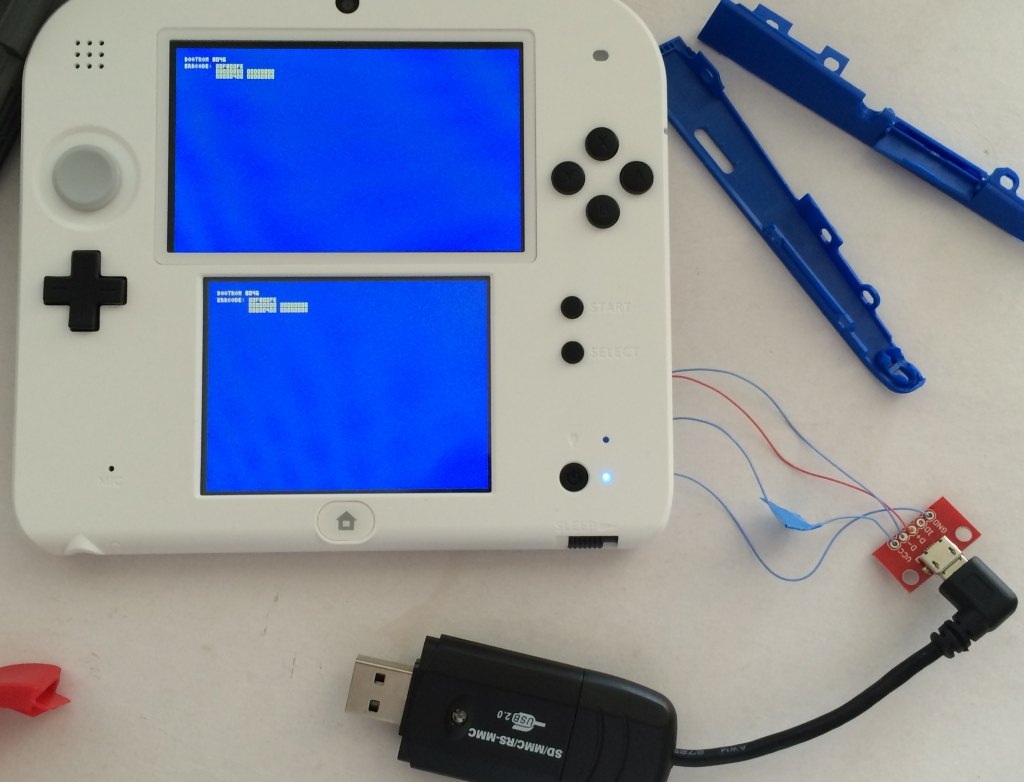

here ya go.
has the same error as my other 3dses:
BOOTROM 8046
ERRCODE: 00F800FE
00000000 00000000
00000400 00000000
except my pc couldnt detect the 2ds and no format warning either when i plugged it in.
voltage and resistance readings on the 3 pins are close match [+/-.1] with my other 3ds,
there's just no drive to select in win32diskimager or in usb image tool.
also tried 3 different sd card readers, nothing.
going to relocate the ground wire on the mobo and see.

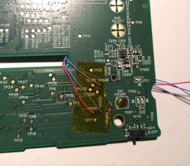

Did you have to desolder a bunch of other components to access these contacts on the system?

So, the 3DS-side soldering was a success, the device still works fine. Deep sigh of relief.
