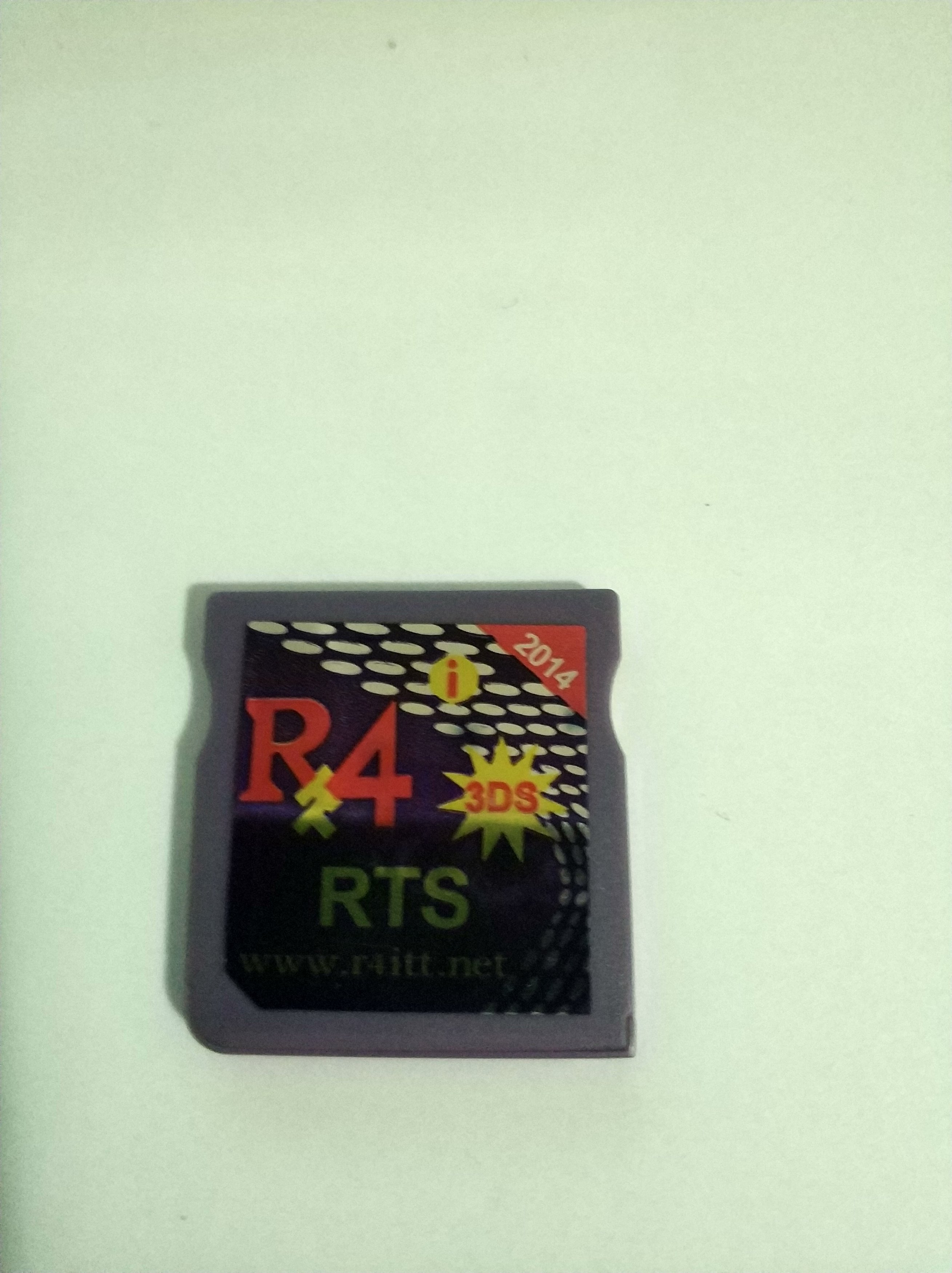

Is my flashcart compatible? Photo is attached
View attachment 174539 Is my flashcart compatible? Photo is attached
Hello.:)
If you want to use the RetroGameFan Multi Cart Update v7.06 maybe yes

https://gbatemp.net/threads/retrogamefan-updates-releases.267243/
You maybe then try (after you downloaded and unpacked the Package) with the Files in the Folder "R4SDHC YSMenu".
Good Luck.:)
