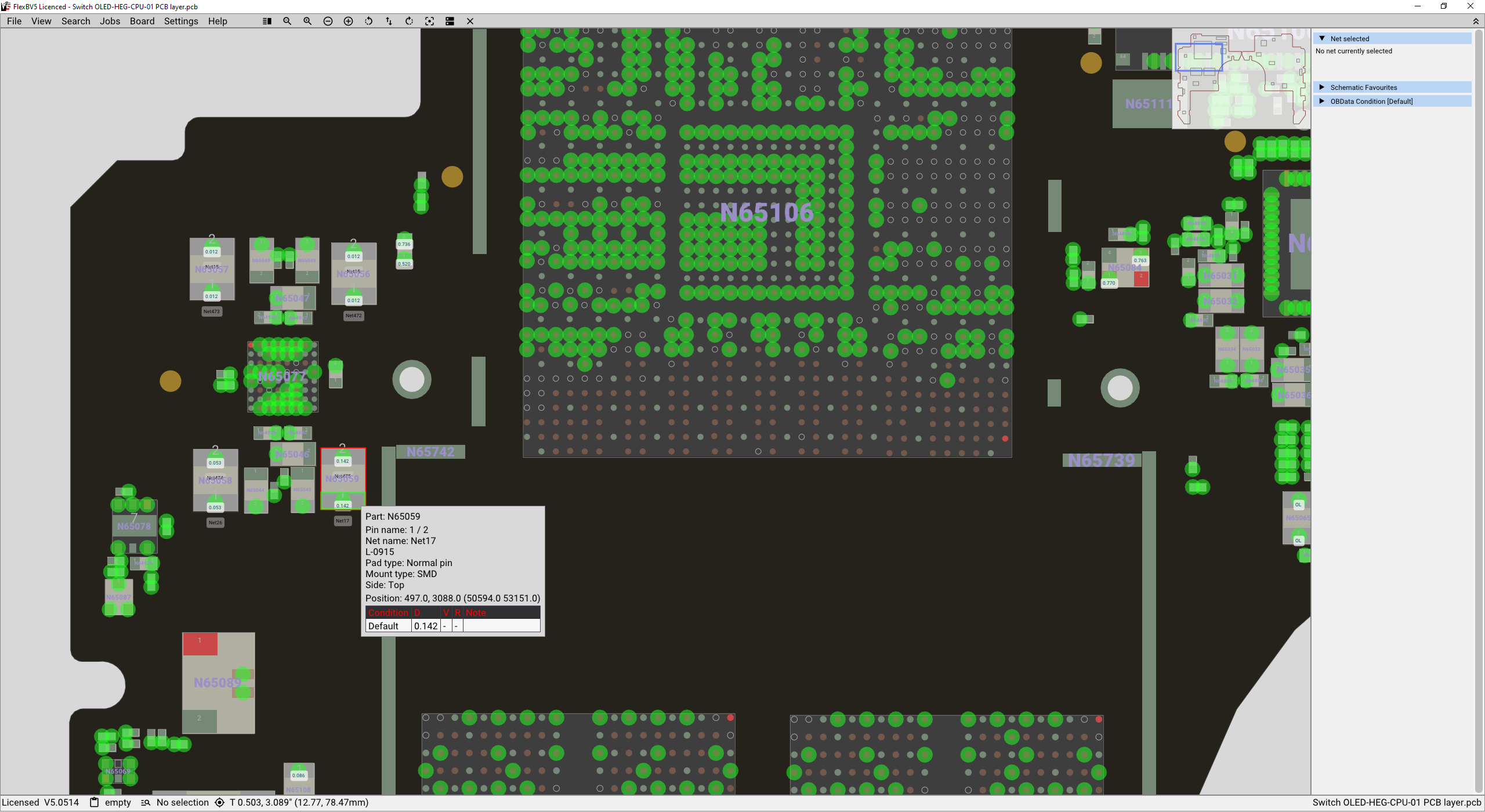

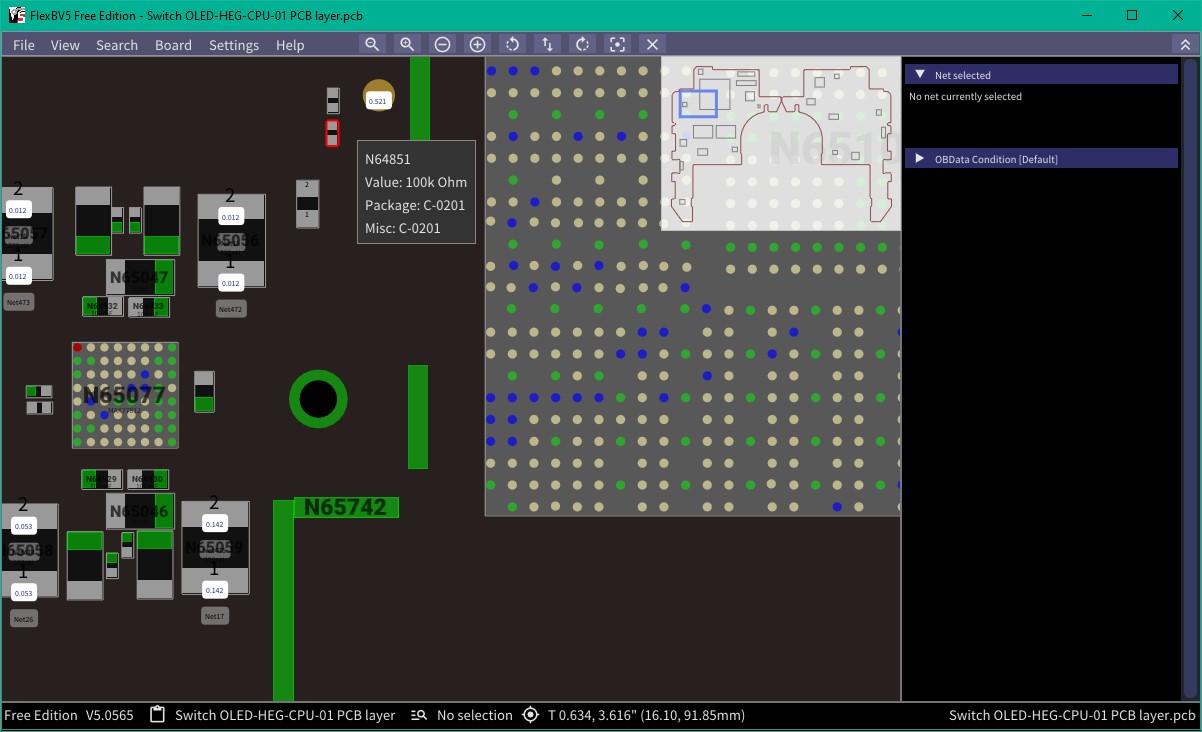

I manually added most part values for the Switch OLED-HEG-CPU-01 PCB by taking them from the zzattack scan I previously linked. Hover over a part (not pad) to see the value in the pop-up window:
I was debating posting this as there may be some mistakes and I only entered what I could decipher from the sketchy handwriting, but I figured it might be more useful than not, so take this for what it is and do your own verification of part values firsthand.
The file with the part values is in ".obdq" format, it seems to be created automatically if you try to edit values in the viewer. I couldn't find a good way to incorporate it into the original ".obd" file without doing it line by line, but I was done with it at this point. FlexBV will read the obd and obdq files automatically as long as they're named the same as the pcb file and in the same directory.

Side-note: it seems newer releases of FlexBV free don't allow showing butterfly view and you need to switch between front/back board views by pressing space, but in Win V5.0565 butterfly view works no problem.
Wrote a quick script to put the values into the obdata file :) thank you for doing the manual stuff I started to a while ago but very quickly gave up lol
side note new FlexBV versions keep a version of the obdata in C:\Users\User\AppData\Local\FlexBV5\meta so delete that folder and it should reload the obdata from the local file

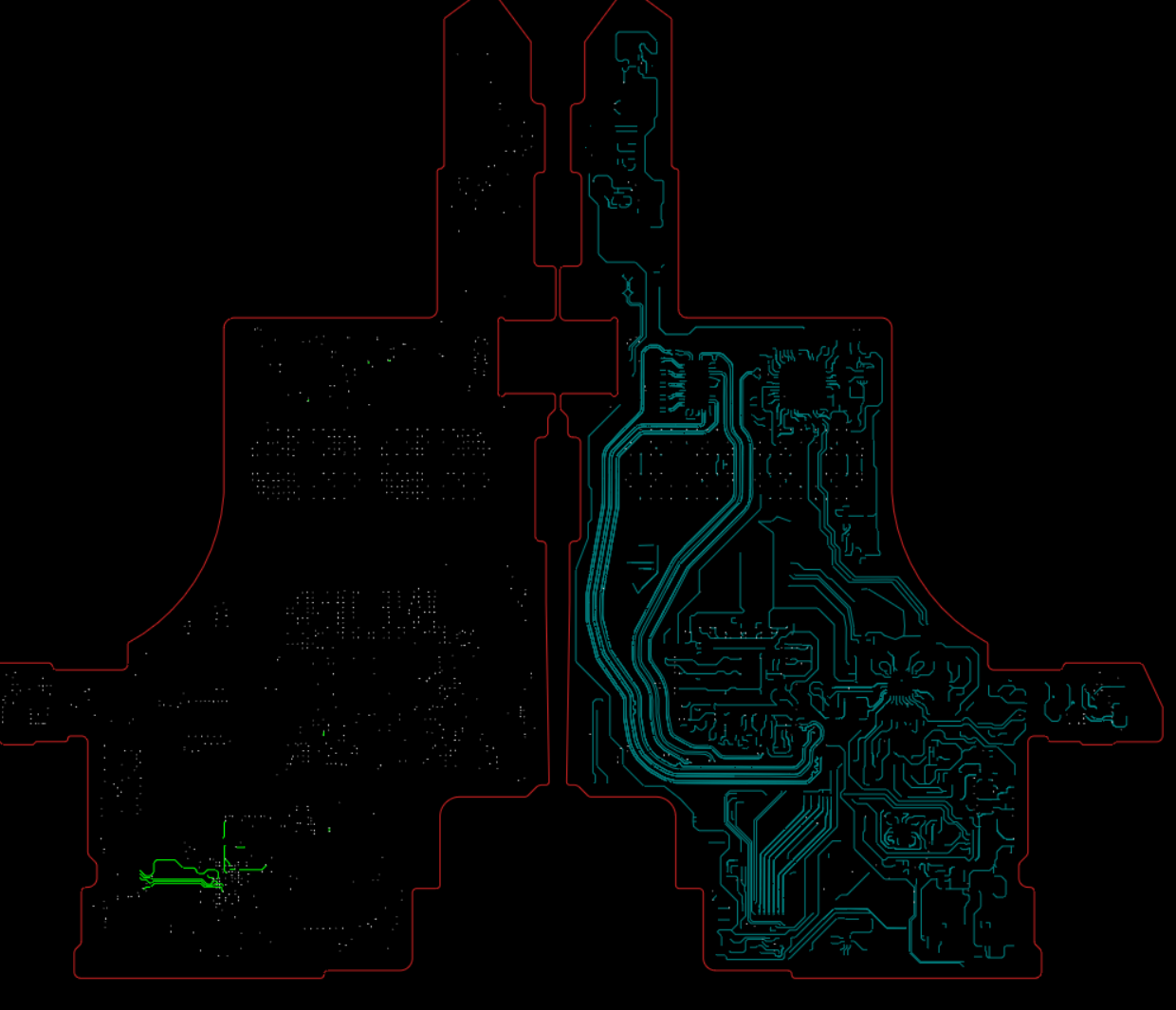

side side note i realise i didnt update this thread about me writing a basic trace layer renderer so quoted post here:
I made a very basic viewer for the trace layers of the xzz pcbs if anyone needs thatI will make it better when I have time during the week but rn its kinda usable, it pretty much only renders the layers atm doesnt do any nets or stuff
https://github.com/slimeinacloak/XZZPCB-ImHex/tree/main/Layer render

Without any tools, I reconstructed this file by locating each leaked screenshot layer using OpenCV.
Are you able to share the process for making the json file, I'd love to try with some other pcb files but if it would be too hard to do that I might have a go at writing a converter to the json structure of the file you provided.
  • Love
Reactions: impeeza
I did not convert it using the PCB file you posted. You need to create a tool to convert PCB to JSON.

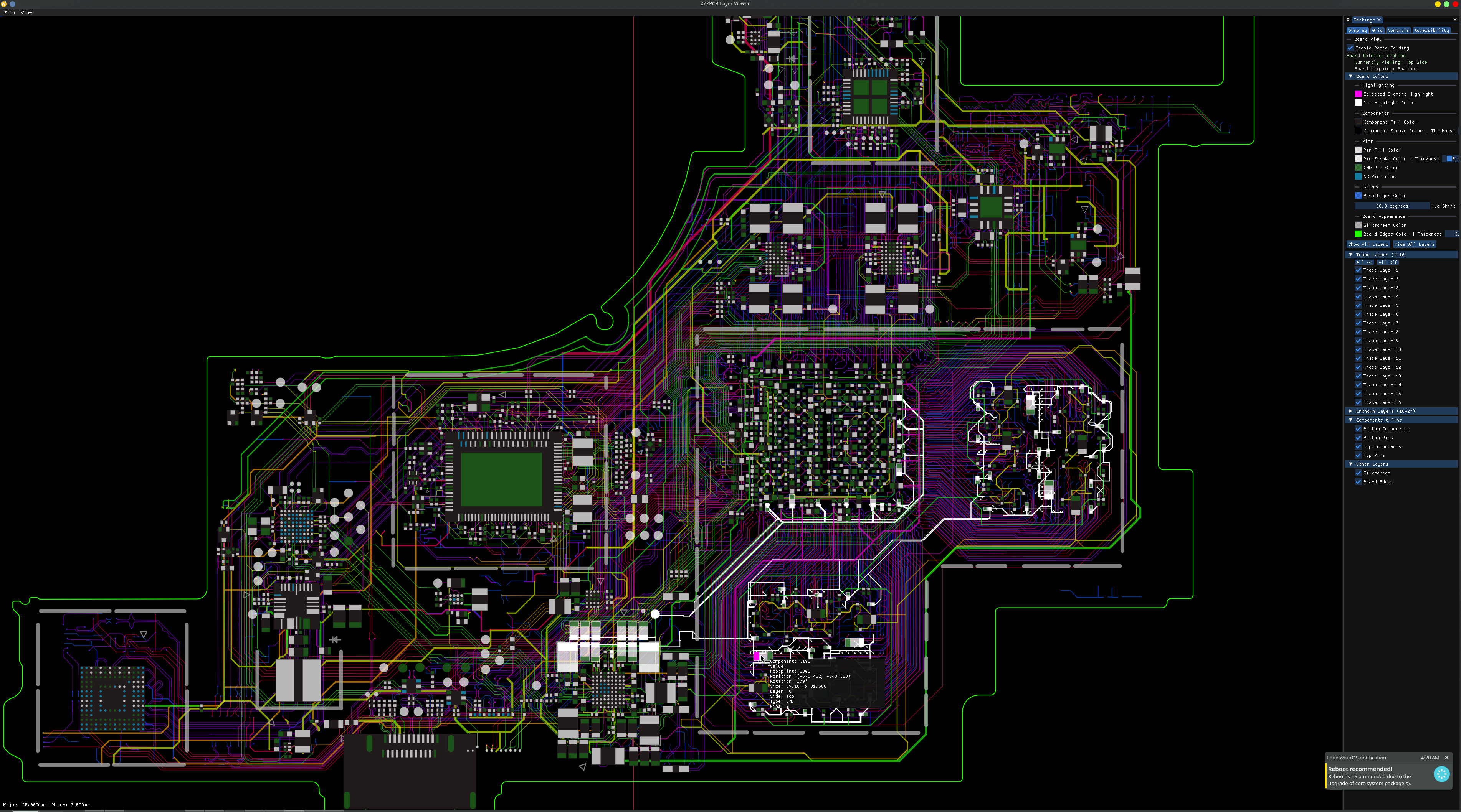

I started to go the web approach... and definitely should have pushed it further, as my background is in web-development.. wrote out a plan and promptly ignored it. :rofl: After getting an initial rough implementation of rendering the part geometries, and starting to work on the traces (was also reading from json), I for whatever reason (edit: was thinking I'd get more/smoother performance out of a desktop app, browser struggled rendering thousands of trace segments for macbooks) decided that digging back into C++ after 10+ years was a good idea/worthwhile. Was trying to work the pin/pad geometries and traces into OBV, and kept running into issues, and it quickly became its own project.
Semi-obligatory screenshot (I have a v0.0.1 cross-platform build on github for [I'm not able to test the mac build] , the code.. is a mess right now, was experimenting with Cursor and Augment). It has board-folding, and net highlighting, and shows what limited info is available in the .pcb file. Idk, I thought some people may find it useful. :
SMDH, yours definitely looks cleaner though, and being web-based (anyone could host it on github pages), is much more accessible. Props/Kudos.
