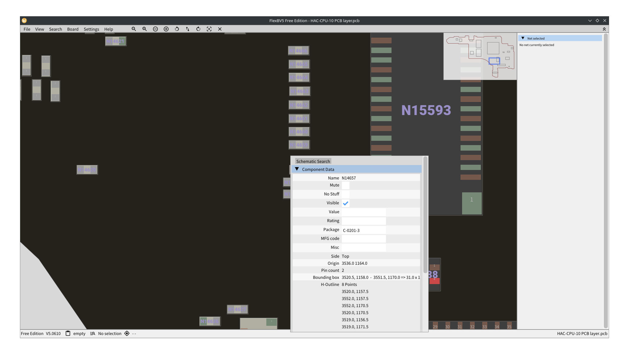

Does this show Switch component values? Trying to see what components are next to the NAND connector. N14657 and N14658. Trying to fix my Switch and I think these maybe off in values.
lmao, you bet Big N would give you a BOM list so that reverse engineer could put everything up on the boardview files.
They are just pcb mapping/connection files, not even closed to component values or traces in layer
As noted upthread the trace data is in the files but isn't rendered by the existing board viewers. Currently diode values are the best we have thought it's possible that someone is working on a component list.
Mine is Nintendo old switch, should be v1. I measured these 2 resistors in circuit are both reading 4.7K ohm. Hopes this help

Thanks, mine is also old. Trying to fix my Switch not booting and I think the NAND is corrupt. Before I attempt a level 3 fix, I think I'll double check their resistance.
