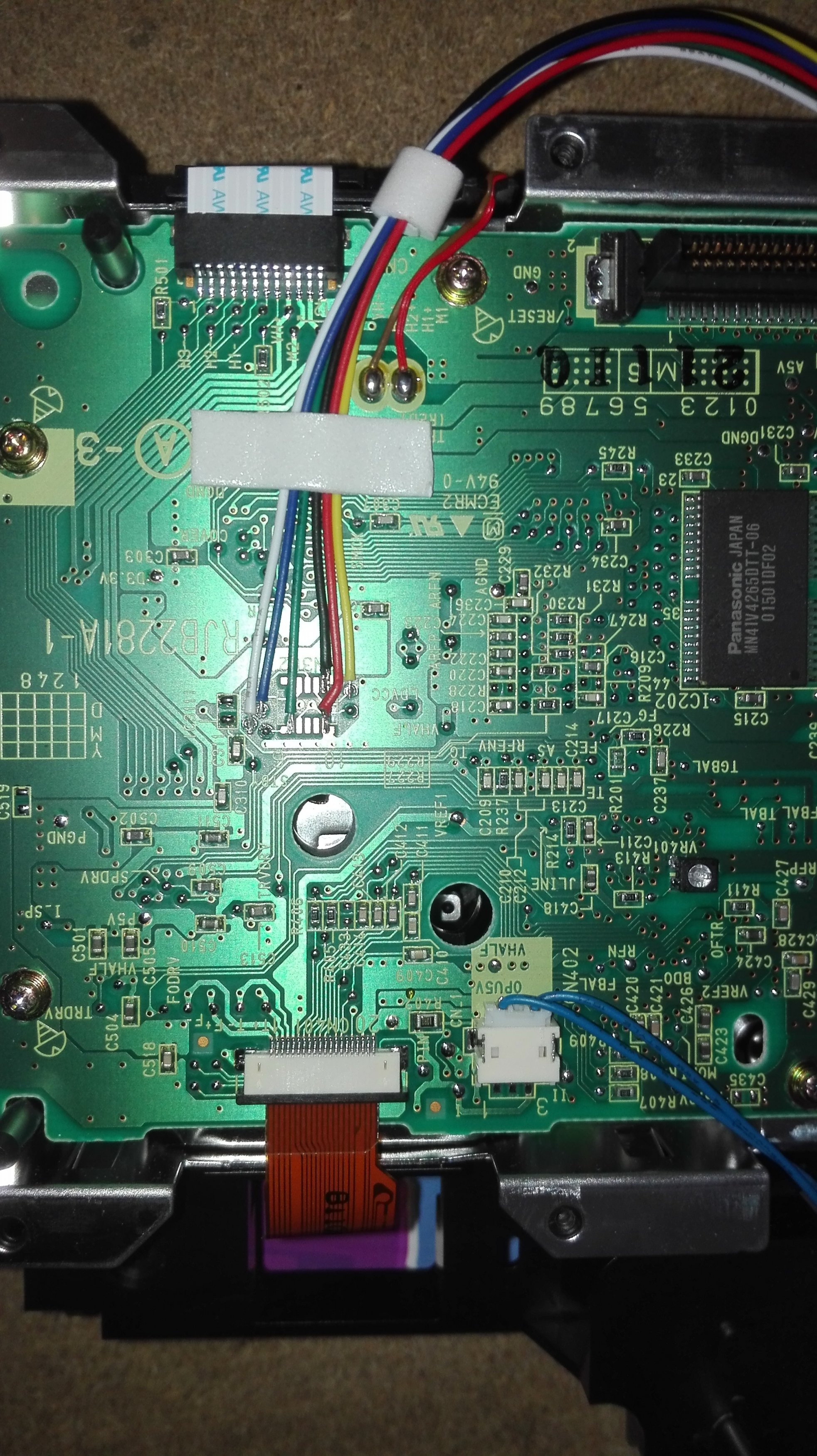

When you power on the console can you check if the leds on xeno light up? Does it light up red or nothing at all??
You need to look under the dvd drive with your room light shut to see anything!

So you need to remove the chip. Be gently please no not damage the drive too much.
You need to install xeno without soldering it onto the drive.

Ok. Install the chip in a way you can troubleshoot the installation with a multimeter, or at least check the led blinking or not.
I have checked your chip picture. You filled with solder two holes completelly. That way you bridged several pins on the drive. That should be your mistake. Have you put some tape over pins 2,3,4 and 7,8,9 ?
