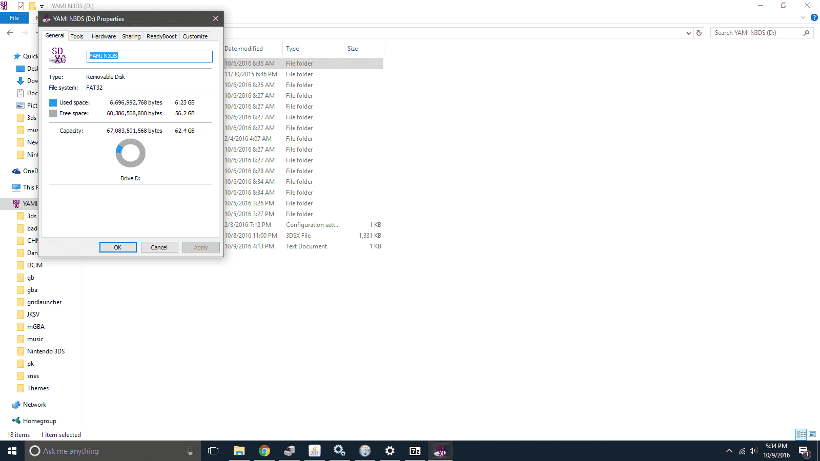

I got it from amazon and this is the status of my sd card...

I used checkdisk on it 3 times to make sure... i also had the security and maintenance window open to check for sure and all drives are working properly...
Chances are it's fake, it could be a 8gb card disguised as a 64gb one (common ones would be SDHC with 64gb when those clearly don't exist), sd cards doesn't reach their write limit until 3 or 4 years average.
