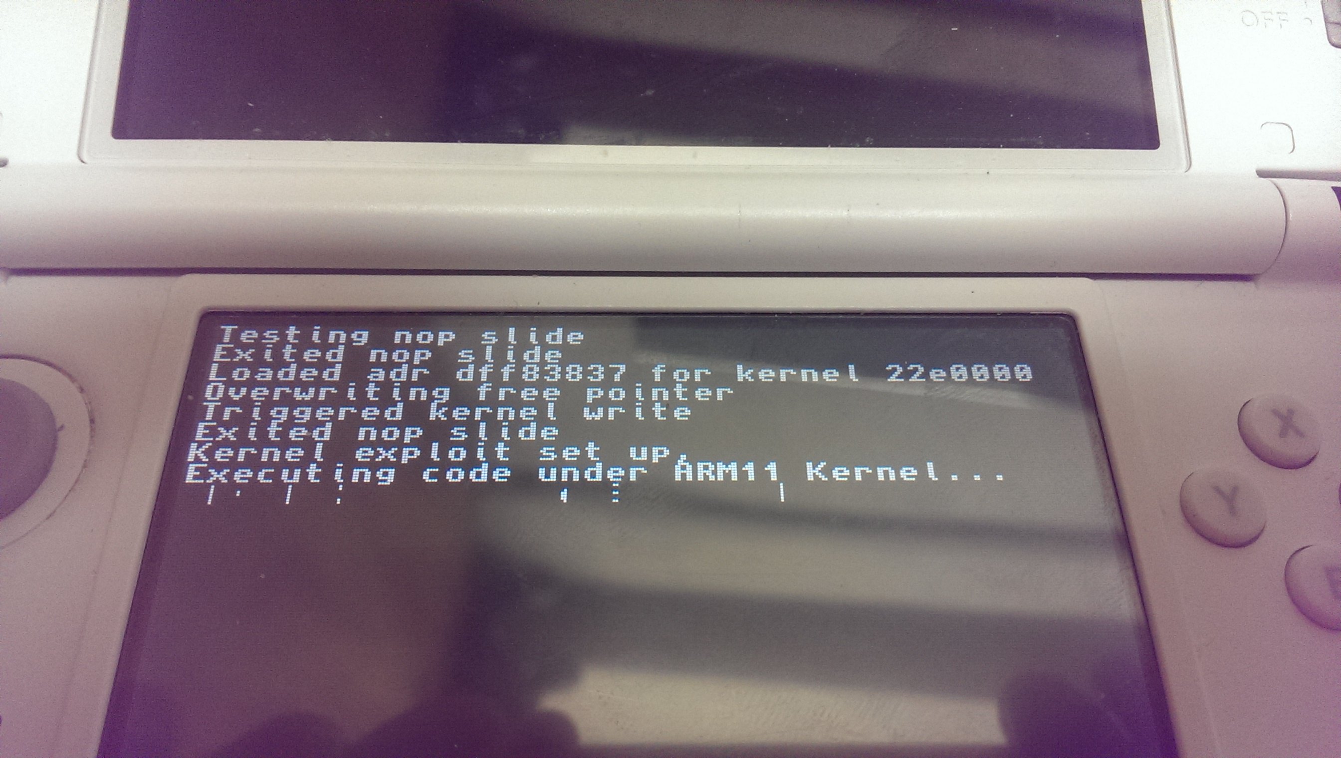

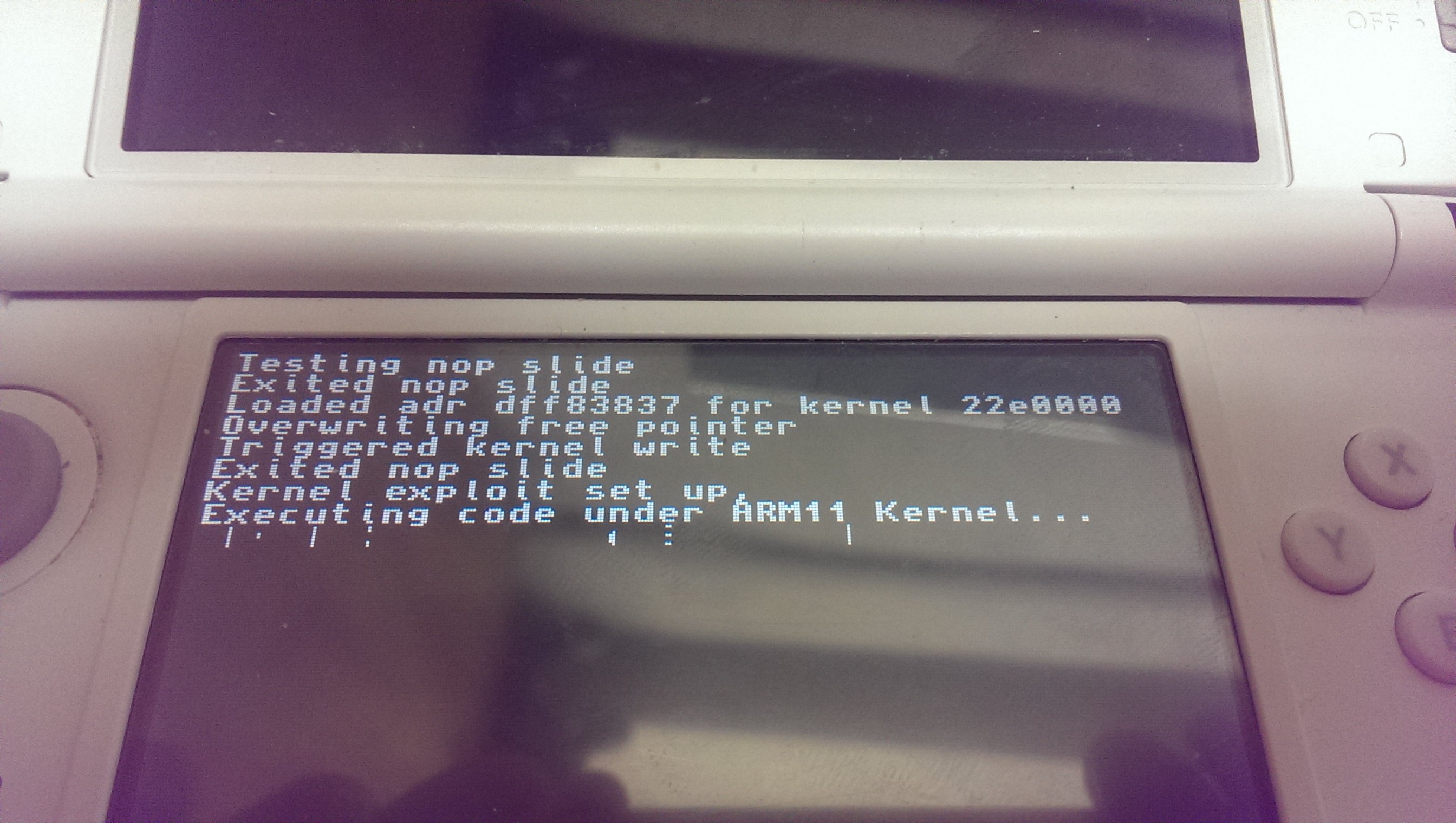

My 3DS: 3DS LL
FW sysNand: 9.2.0-20J
I've tried 10 times
But success only second and third
For the remaining tests, this screen is appeared

My 3DS: 3DS LL
I've tried 10 times
Try the version in the attachment and see what you get. Could you also take a slightly lower resolution photo, I'm on my phone and that took ages to load.
Edit: Also, the times it worked, what was the code it displayed?

Success result: faaffaaf
Success ( 4 times ) : 1 (after I use ftBRONY immediately) 3 4 10
Fail ( 6 times ) : 2 5 6 7 8 9
As for fail screen, the remaining code is appeared and have additional code after "free pointer" is "141a000"

OK, use the original version from wulfy's post from now on, and run it a couple more times, what I want to know is the address and the kernel each time, if that's possible
Success : 3 5 6 7
Fail : 1 2 4 8 9 10
The results of success and fail are same as your version
Success : 3 5 6 7
Fail : 1 2 4 8 9 10
Are you still getting it saying kernel 22e0000 on wulfy's debug version when it fails? That is the crucial part, thanks, you are being a huge help! :)
