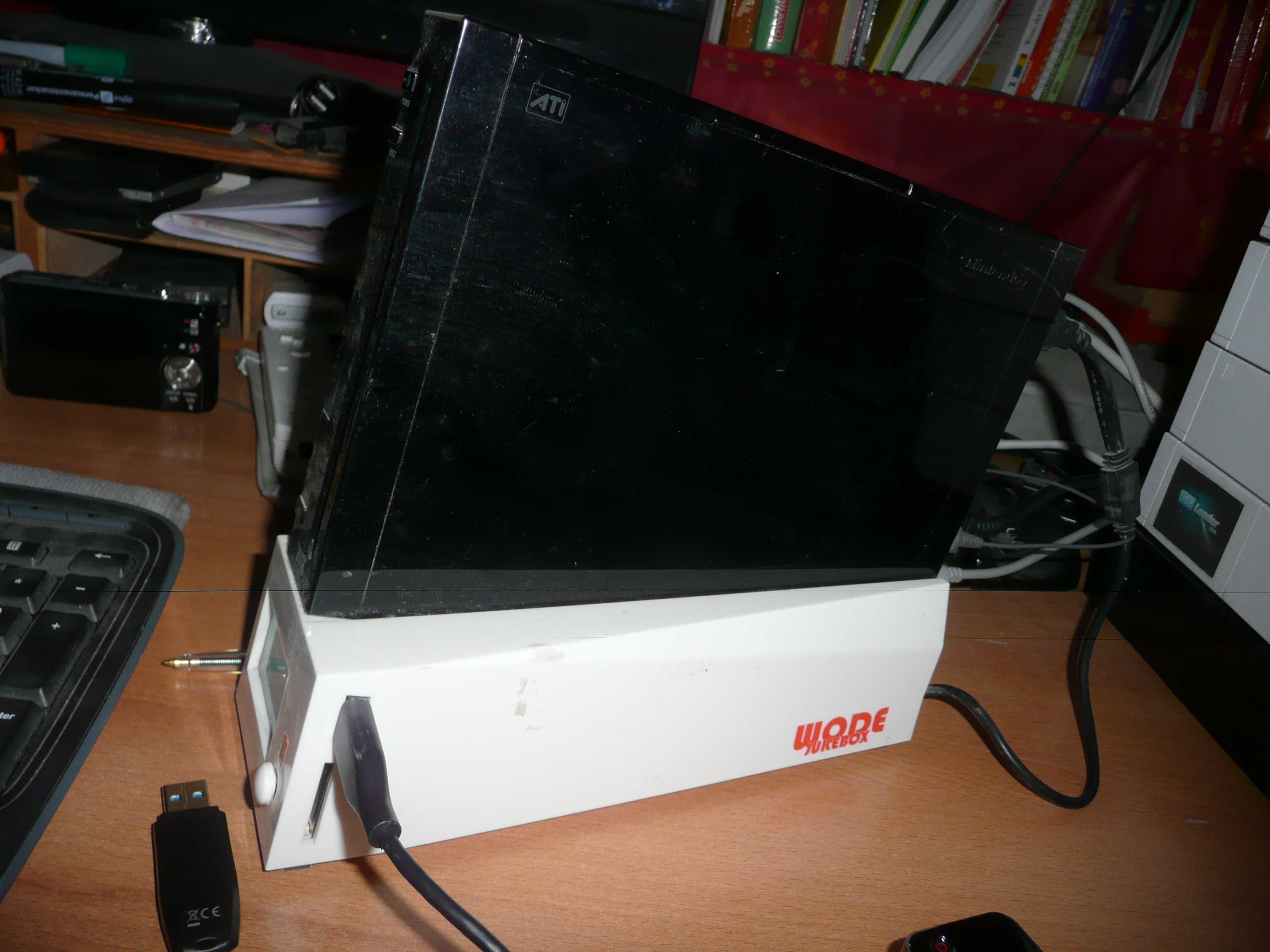

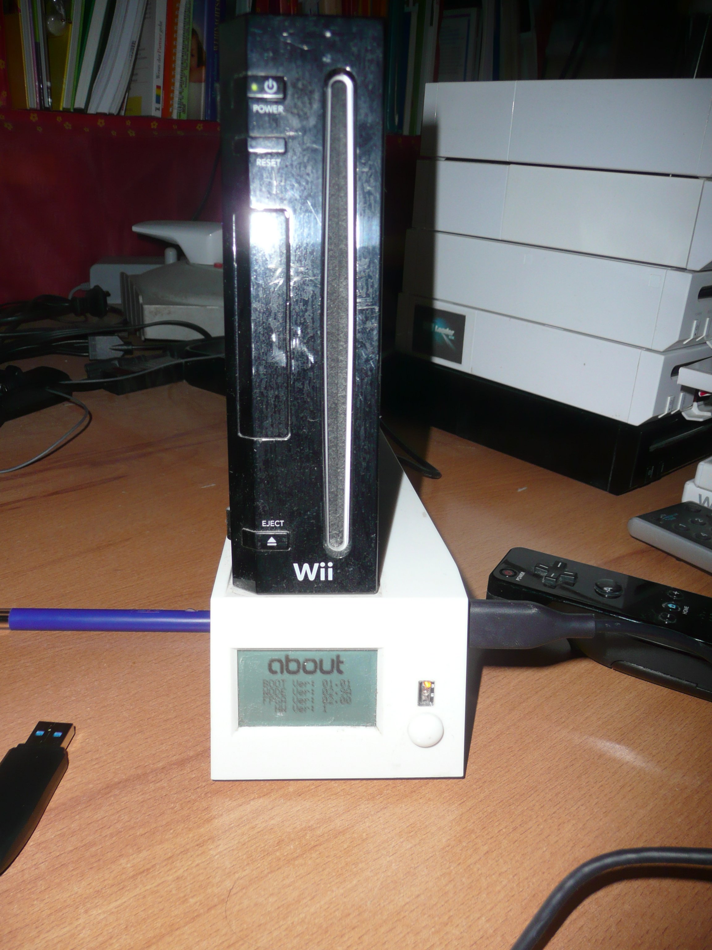

Gentlemen,I hope you can help me a little.
I got a Wode Wii yesterday.
I have read about to make Updates higher FW 2.x only from v1.28
The Wode had already an 02.1x Firmware on it.
So I updated to Version 02.9A
Today after intense playing,the WODE stucks on the "Loading.." Screen.....
Luckily I found this:
https://web.archive.org/web/20111017002657/http://wodejukebox.org/viewtopic.php?f=4&t=3501
And with the Downgrade Firmware from the GitHub it "lives" again.
Now I wanted to upgrade again,but I seems there is no v1.28 on the GitHub Repository....
Does someone maybe have this Version ?
Thank you.:)

Thank you very much for your quick Answer.👌
1. v1.27
2. v2.29A or 2.29B
3. v1.28
Maybe was so confusing for you:
I have read about this "bigger as 5 MB" Firmware Thing and some WODE (IC´s) can not handle this.
I got the WODE Wii a few Days ago with v 2.1B if I remember correct.
I plugged into some USB Sticks/Devices and some are not working correct (LCD freezes),so I have searched and found this Thread here,where JakobAir posted the Link to the GitHub Repostiory with the Firmwares.
And the latest v2.29A / B.
So I updated the WODE to v2.29A and everything seems to work fine.
But after a Night of intense Playing,the next Day,the WODE LCD stays on the "Loading...." Screen....
After searching I found via the WayBackMachine Wode Homepages / Forum.
There was a Thread about this "Loading Screen" Issue and some Explanations.
If your WODE is "Stuck on Loading" after updating please contact your seller to arrange an RMA check below for more info
For WODE's that cannot update past a certain level or are stuck on loading or Will not update at all.
Can Not Update
An SD card formatted to FAT is required for an update updates can be found in the download and releases sections of the site and how to apply in the manual. In most cases it's fine to format the card on a PC using the format tool that comes with your operating system but at times this does not do the job well. Use a digital camera or Panasonic tool to format the card correctly.http://panasonic.jp/support/global/cs/s ... index.html
What to do if it doesn't update?
If you're having trouble updating it could be for a number of reasons.
It's not uncommon for users to have wii connect 24 enabled this makes the Wii shutdown to standby mode and keeps the WODE active and unable to update. The WODE's bootloader checks for an update.bin on your SD card's root from a cold boot. To achieve a cold boot you must hold the Wii's power button in for around 5 seconds until the power indicator LED turns RED the Wii is now fully off you can then insert your SD into the WODE and power on once the update has completed check your WODE's settings are correct for your region and power cycle again.
It's possible that your SD card is not compatible with the WODE please try another.
Still not Updating
It's possible that there is a bad connection on one end of the slave ribbon, re-check your installation including the connection In the stand.
If your WODE is working on a lower firmware it's possible to test the connection by trying to run an iso from SD.
Stuck on LOADING
If your loading screen is pixelated like the image it's likely that your WODE has a Flash failure and requires an RMA, Please contact your seller to arrange a repair/exchange.
Stuck on LOADING after update
The issue of "Stuck on Loading" on FW above 2.xx has now been found to be a Flash issue on some main boards please read the following quote from admin on how to deal with the situation.
admin wrote:
Last thing... the problem of the update of 1.28 >> 2.xx firmware is found in the FLASH IC... some wodes pass the quality check with 1.28 because is under 5 MB firmware... the 2.00 is over 5 MB and we found some wodes that have a faulty FLASH IC with bad sectors...
All who have a wode that cannot upgrade need to replace the WODE MAIN BOARD or replace the FLASH IC... this kind of issue is covered from warranty, you can link this thread to distributors that need to accept the RMA.
Plese use this link when contacting your seller viewtopic.php?p=38308#p38308
And on the Bottom of the Page:
The following is based off of old information provided but still consider when troubleshooting your WODE
If the loading screen arrives after updating to a higher firmware it's possible that your WODE has a marginal FPGA. This does not mean your WODE is defective but simply that the FPGA only met the lower end of the manufacturers requirements. Higher firmwares put more strain on the FPGA and may push those marginal ones over the top this will be fixed in the newer kernel now that the development team have a marginal FPGA in their possession all new releases can be optimized. Downgrade packages are provided in the download section should your wode get stuck on loading when on a higher FW.
So found here
https://github.com/JakobAir/Wii--WODE
the Downgrade File and now the WODE was on
FW v1.00
Then I update to v1.27 - The last Firmware smaller than 5 MB.
And so my Question about the v1.28 Firmware - the first Firmware bigger than 5 MB.
I have searched all over the internet and everbody recommends:
If you want to update the WODE to a higher Version 2.xx you must first update to v1.28 !
(You should avoid for Example updating from v1.24 to v2.10...)
I hope,I have explained it now understandable,I am very sorry to have confused you.
Thank you for your Help.😉👌
