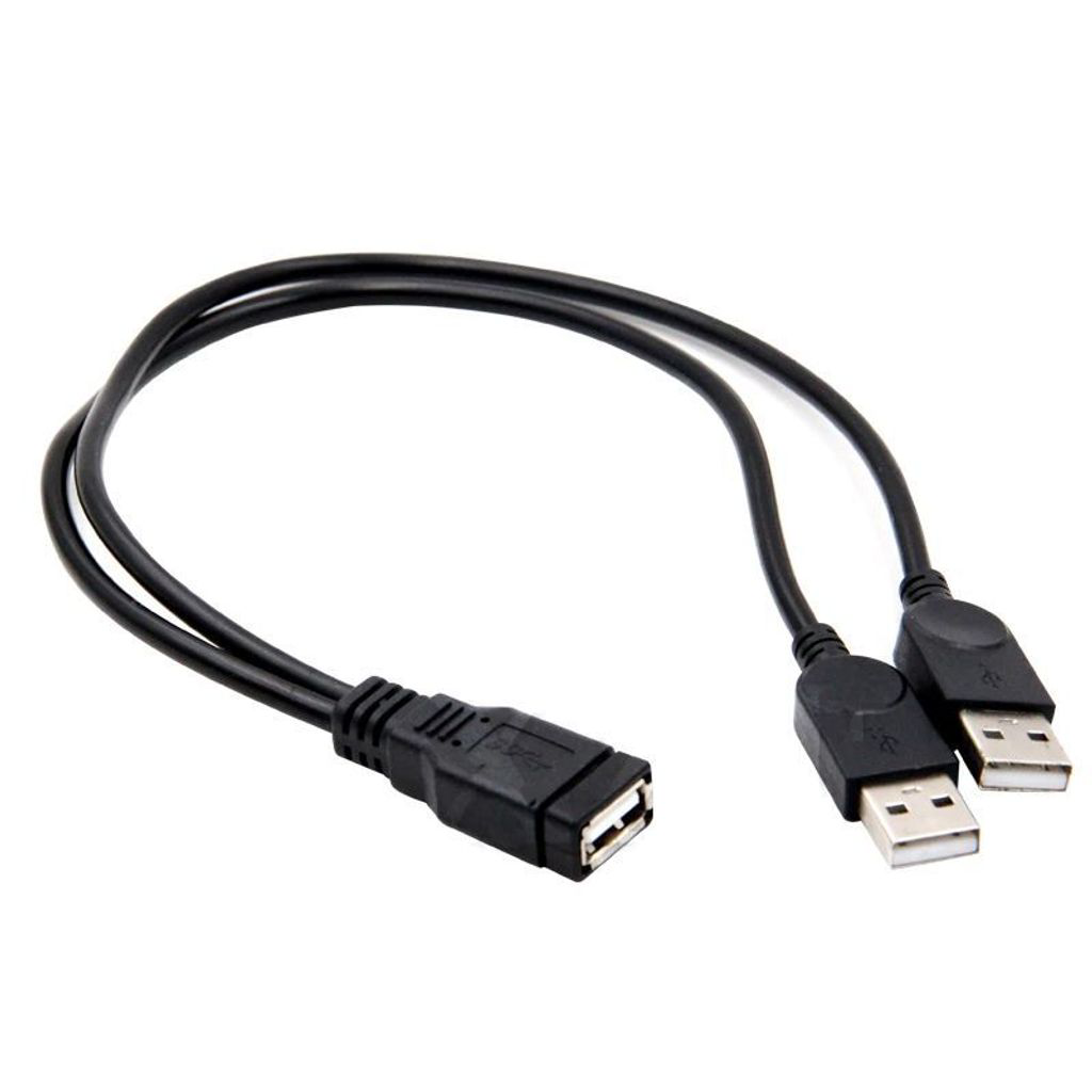

Maybe it's not getting enough power, have you tried using a y cable?

first: how can i use a y cable if my dvd drive is 1 usb-a and 1 usb-c? and second: did you even read the post? like i leterally said it worked in my wii but couldnt get to work on wii u (after rereading the post i noticed i didn't said clearly that worked on my wii so now i edited to make that clear)
What does that even mean? Anyway, there's always a way to use a Y cable:

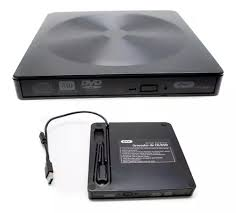

I think posting a photo of your DVD drive will come in handy so we can get an understanding of what you're working with. As far as I'm understanding, the users telling you to use a Y cable are correct. That's all you need, a Y cable. Ignore the USB-C cord. What's the USB-C cord for? Are you powering the DVD drive with that? (how?) Is it just optional, like you can use it as USB-A or USB-C?

the usb-c plug is for connecting on usb-c devices but none of my devices have a usb-c plug so i use the usb-a 3.0 plug but if the device dont support usb 3.0 (example: my pc) it will work as usb 2.0 (got this info with ImgBurn and the dvd drive box) and this is a pic of the dvd drive:
Plug the usb-a into the single end of the y-cable that @V10lator posted and plug the twin end into the console. No idea if it'll work. Or get an actual dvd player. Can you even buy dvd anymore?

and this is a pic of the dvd drive: View attachment 448701
That looks like a drive with a Y-cable to me... Could you tell us what brand and model the drive is cause if I'm correct all you need is a USB-C to USB-A adapter.
Which might be the power-only end of the Y-cable and the reason your drive doesn't work at all. Again: Would need to know the brand and model of the drive to confirm.

//EDIT: And in case you really think the adapter/cable I showed won't work what about a USB 3 compatible one like this?
Or USB A to C like this?
There are all kind of Y cables you could imagine available, you just have to find the one that matches your usecase.
//EDIT²: Found it: It's a dirty cheap no-name drive. That also means every seller just speculates about that cable and the manufacturer doesn't give any information at all.
Please use a multimeter or something to tell us if the data lines are connected on both, the USB A and the USB C male ends or not. Else we can't know if a simple USB C to A adapter will work or if you will need one of these cables I showed already.
