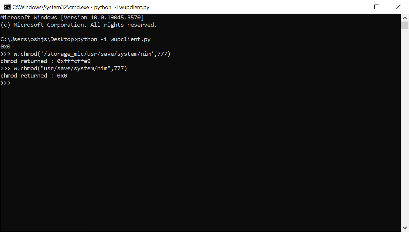

WinSCP would send the same FTP commands as Filezilla would. What FTPiiU supports is pretty limited. You could use the wupclient to change the permissions on these folders to 777 or something like that using the w.chmod command
I don't know how to write python scripts, let alone how to write a script to do something like that. I'll try WinSCP first and if that doesn't work, we can try wupclient. Do you happen to have a script on hand?
I think I got it to work for the nim folder (ignore the first attempt as I realized that probably wasn't right). I guess I should also do that to the packages folder since that was your first suggestion. What do I do after that? Is there a way to recreate them through wupserver?
Ok so that definitely did something. I changed the permissions for nim and packages (packages was the very first one you suggested doing). Just tried updating Pikmin 3, and it froze completely. No error or anything, just froze.

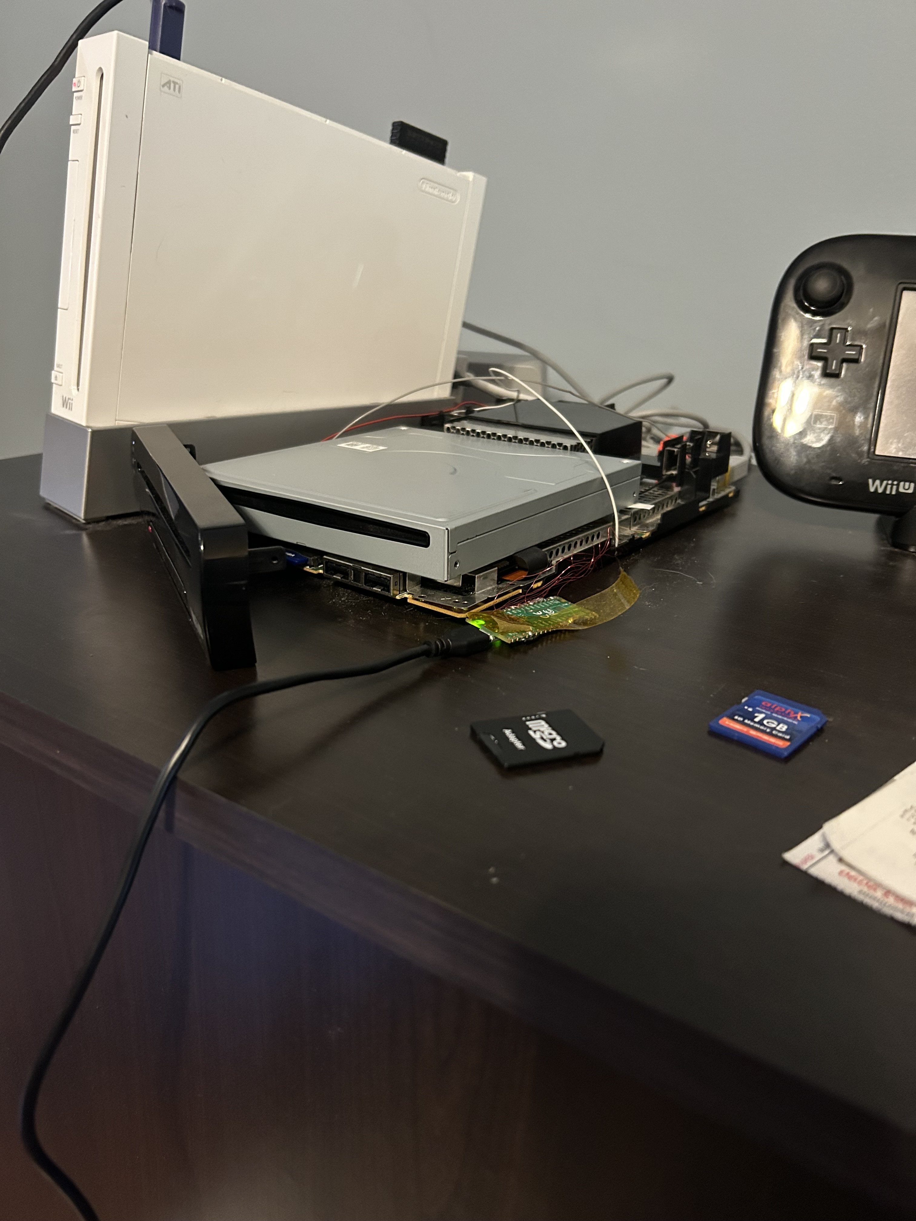

I was pretty busy this week so I'm only getting around to trying FTP today, but I have a problem. It doesn’t look like the mlc is being detected for some reason. Also, when I saw the Wii U earlier, it had a blinking blue light and was a tad warm. The fan was also not on. Normally I unplug the Wii U when I’m not going to use it for an extended period of time, but I didn’t this time. I don’t think anything broke though.
I’ve attached a log as well as a picture of my current setup. I’m wondering if the metal shield could be touching the NAND-AID and causing a short. If that’s the case, I can try insulating it and see if that helps.
