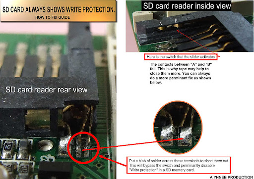

that sounds like the best bet, making it permanently writeable
this might help, picture is supposed to be from a wii

i've had issues like this with old (and fake) cards. my laptop at the time would read them, but other things wouldnt, then other devices would read part of them or have broken blocks etc. buy a new sd card rather than using old random ones, i wouldnt use a micro Sd card for a wii u anyway, standard sd cards are more reliable.
